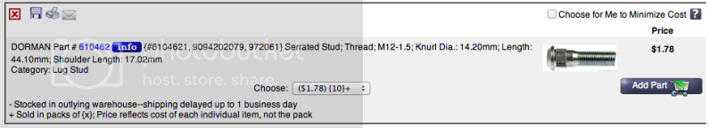

I run these on the rear. Don't think they will work on the front. The part number is 90942-02079.
I just cross-referenced the part with Dorman. Looks like its for a variety of Toyota 4x4's.
Dorman Products - 610-462
$1.78 on RockAuto
ntsqd said:
Unless they've changed it, the Dorman part measures slightly shorter than the OE stud.
Yeah I know that. 610-462 is not for a Landcruiser. It's a longer stud which happens to fit in the rear of our 60/62's. Pappy supplied the OEM part number earlier in this thread I just looked up the Dorman part for that application :)
I have Dorman studs on my right front wheel. It is a few threads shorter but it does work okay.
