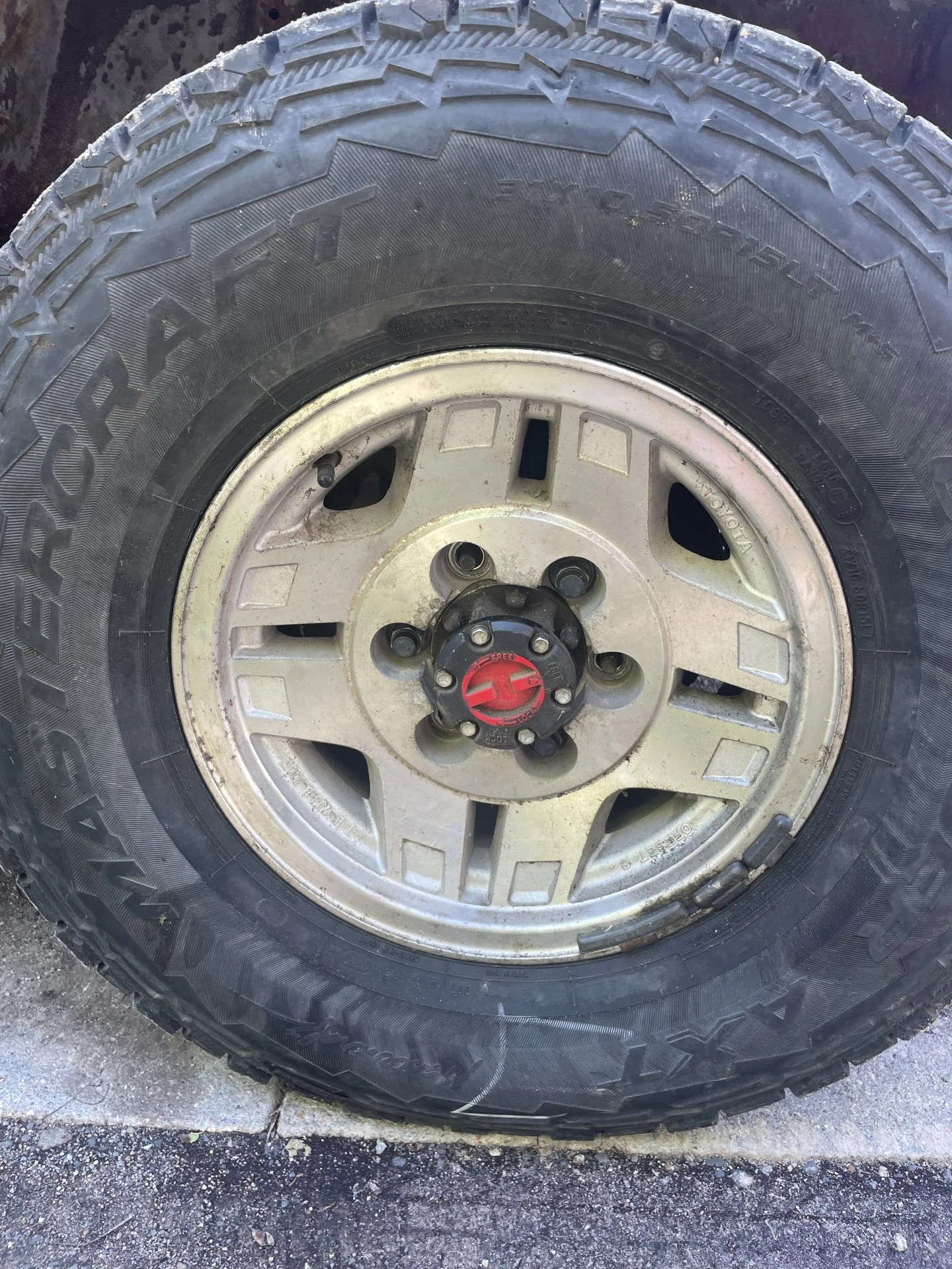

Morning. I recently acquired some, I assumed, stock wheels for my ‘89 pickup. 3.0, 4x4.
Did I assume wrong? I put them on and now cannot remove the front passenger. After this I didn’t put the driver side on. I always thought these were stock to these pickup, but it’s like the hub is too large for the inner bore of the wheel.
Looks correct, got all the Toyota markings. Mine fit snug to the hub on one truck and not as snug on another. Snug as in I gotta wash off any mud/grime to ease getting them off.
I had to clearance the washers on the locking hub body studs to get the wheels on, looks like yours don’t protrude as much as mine
Hub-centric wheels can get 'glued' on with mud, etc. A good washing & rocking at 6-12 o'clock and 3-9 o'clock positions should get them off. I remember having to really work mine over when I first got it. Truck had only put on 1000 miles in 10 years, and were really stuck on there.
