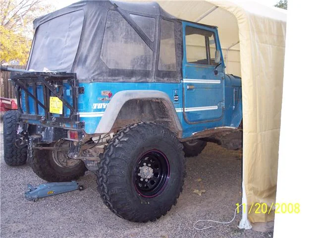

thanks Chris. my new 39.5's and 17" rims arrived and got put together today. i'll be picking them up tomorrow morning!:bounce:
i'll put some pics up when i get them mounted.
i got them! i'll try to link pics here, but i'm having trouble. they are in a thread on my club's mud forum.
attachment.php
attachment.php

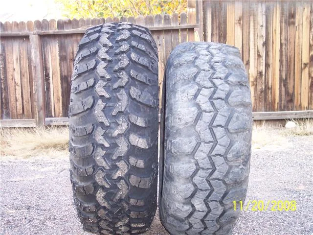

ahhh, it's working. the old ones are 36x14.5-15. here's more. 1st with my 8 year old son. yes almost as happy about the new tires as i am.
attachment.php
here's a new one on the right and an old one on the left.
attachment.php
and last one on the rig.
attachment.php
