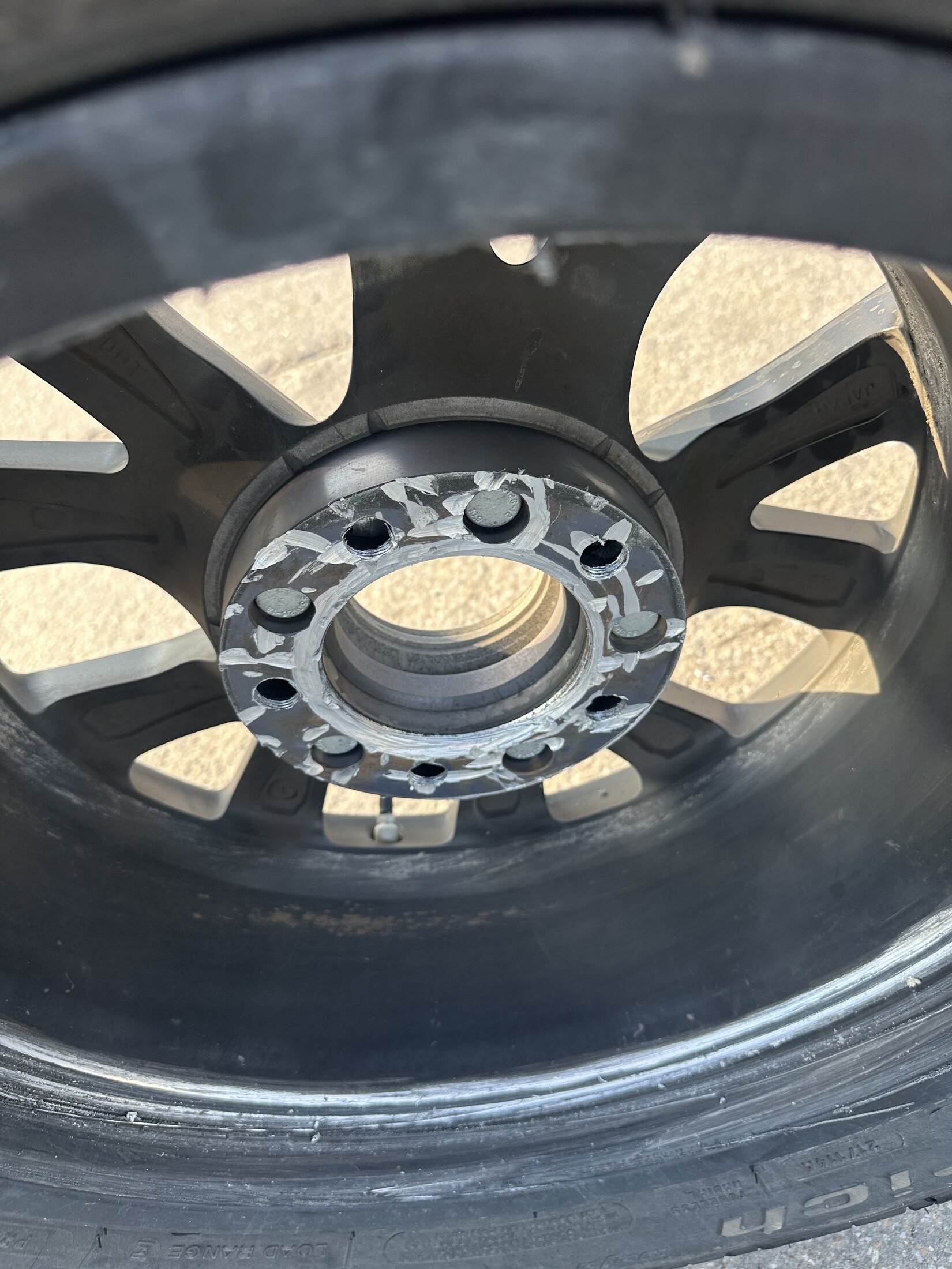

Dropped my car off for a 50k mile service at the local Toyota dealership in Austin yesterday. Picked it up this morning and drove to Houston for work.
On my way home, the driver's side wheel... came off. I still don't understand exactly what happened or how this is possible.
Years ago I had Spidertrax spacers and OMEs installed at Ed Martin. I wonder if my local dealer didn't fully tighten the lug nuts or re-install the wheel properly after rotating. Any ideas on what might've happened? Anyone had a similar experience?
I'm just really thankful this didn't happen when I was driving at speed on the highway home.

Did they remove the spacers for some reason? I’m guessing they didn’t tighten them if they did.
Any signs of something wrong before this happened?

They did a rotation and alignment as part of the service. I’m not sure if they removed the spacers as part of that.
I’ve had the spacers on since 5k miles. No issues.

When you take that spacer off are the nuts just loose in there?

I would check the nuts on all the remaining spacers, and also remove and inspect them. Sometimes you can tell if they have been removed.
Usually, dealers do not do alignments on vehicles with spacers. Interesting they done it on yours. Or maybe they removed the spacers first and then put them back after.
Are you retorque the spacers when you rotate the tires? If the tire rotations are done at shops, who did them before the last one?
You should inquire at the dealer how they've done the alignment w/ or w/o spacers. Also inquire if they removed the spacer and why. Don't mention the lost wheel before that.
Was any work done on that side since spacer was installed (e.g. change disc, parking brake pads)?

Well you don’t get the OEM steelies with another offset. But to be honest I also wouldn’t trust aluminum spacers on a vehicle that weight if I would do (like I do) every now and then some weird stuff with the car (200s flying pretty stable…).
So I got steel spacers so the rims deform way before the spacer does.
But no offense to you guys over there on the other side of the pond but there is so much stuff over there „road legal“ where here in Germany the state inspection guys would be like „nope nope nope, you can directly order a flatbed to the next workshop to remove that!“.
But in OP‘s case I would just guess that they removed the spacers to check the rear brakes n stuff to readjust and then forgot to tighten them before mounting the wheel….

This is helpful thanks. I’ve only serviced the car at the dealership.
If the spacers were removed as part of the service, what then?
They were planning to replace brakes as part of the service, but didn’t have the parts in stock. So…
Then you know who forgot to torque the flying spacer. Holding them responsible is another question, as they might say they did torque them, and that might actually be true, but not to the proper specs.
If you do not wrench yourself on it, and rely on the dealer to do it right, make them aware of the spacers proper torque (probably same as the wheel) and show them the pics. Maybe ask them to add a note on file about the spacers so future techs pay more attention.
If I'd be in your place, I'll check the torque myself. I always do that if someone else than me is touching the wheel nuts, even with having no spacers and OEM wheels on this truck. If that doesn't work for you, I'd just bite the bulet and get proper offset wheels eliminating the spacers.
Something that I wanted to ask you: did you feel any vibration when the wheel/spacer become lose? Usually, an out of balance wheel creates such vibrations.
