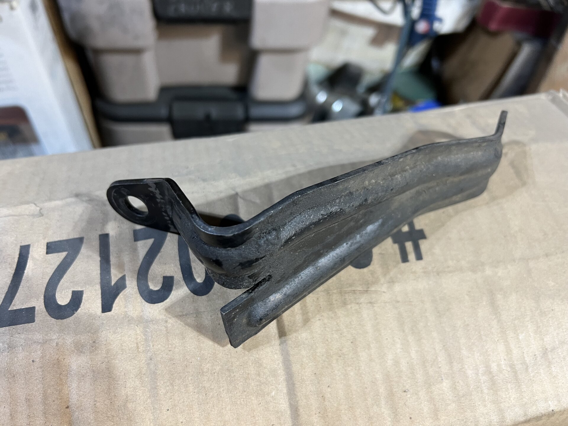

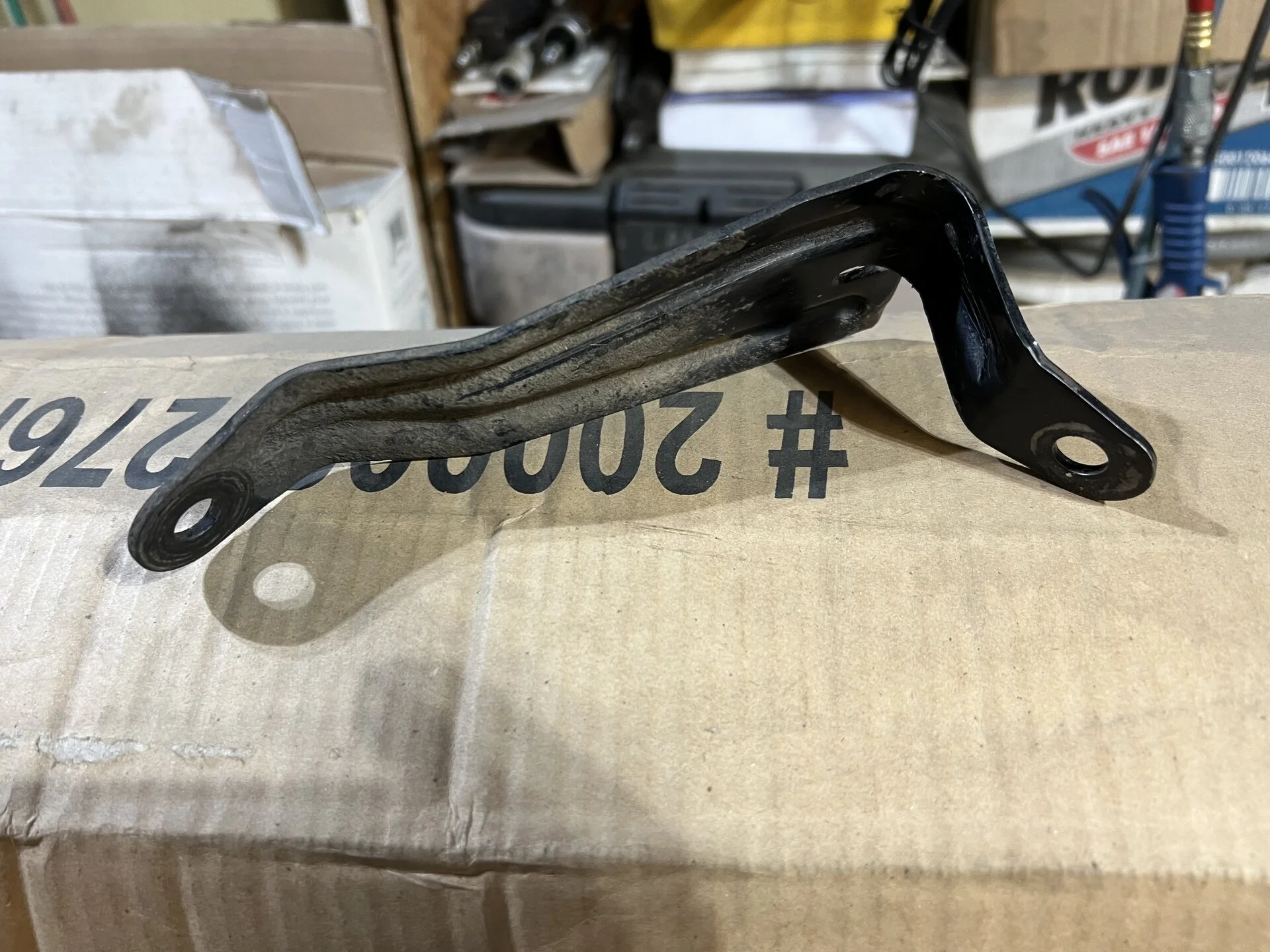

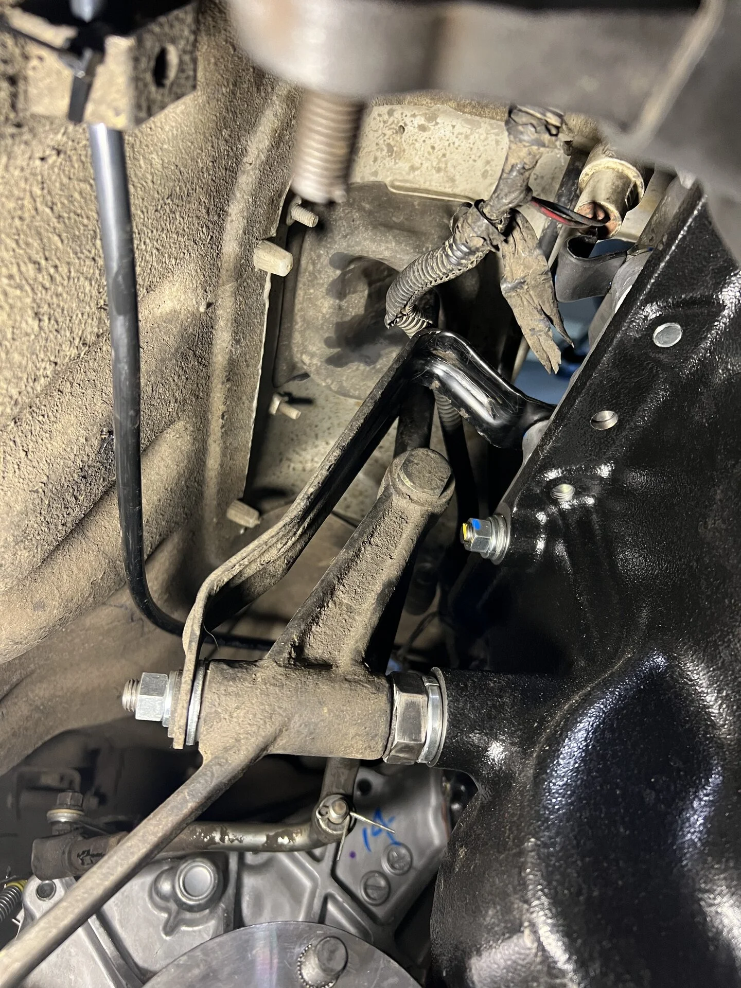

What’s this for? Does someone have a good picture of a non abused/damaged one so I can compare?
It is listed as 'Guide, Transfer Shift Lever' in the parts diagram. PN 36323-60080. Looks like maybe it is a brace for the transfer shift lever shaft? Limiter for shifter travel?
It keeps you from shifting into low range while in 2wd and also supports the rod/shifter. Many people modify it so 2wd Low can be used.
Yours kind of looks ok. Some info on the bracket and photos here:
