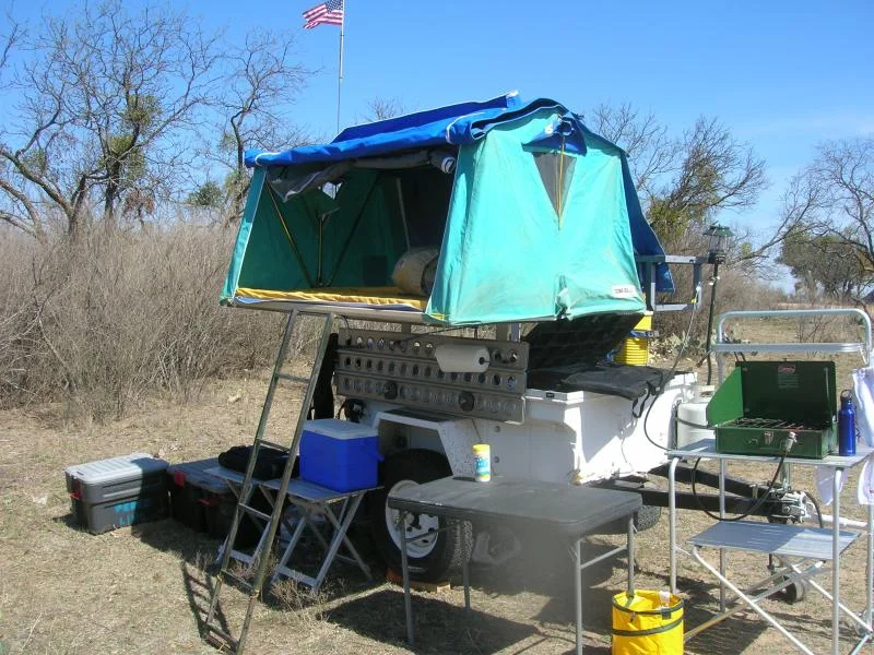

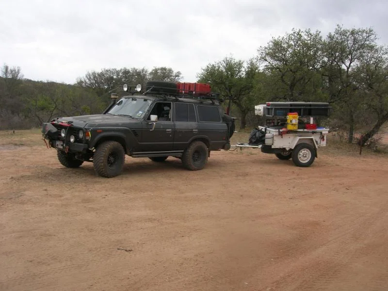

This is my M416 trailer. I had the tongue and the lunette lengthened. That made the trailer much easier to back up.
There is a rack where I have a Overcamp RTT and a basket designed to pit three Action Packers. There is alos a large Tuff box where I have secure storage and a battery box on the bed with two Gp 29 deep cycle batteries.

hey mike,
how did you extend the tongue? did you redo the A frame part or just put in a longer lunette ring? i want to extend mine...but want to replace the whole front end. also...what did you use for your propane mount? was it just a regular RV 20# mount?nice setup btw!
Trailer
The propane mount was a regular 20lb mount cut down to fit the 10lb tank. I had the the frame lengthened 18" and the removed the lunette rind and 16" added to that as well. I plan on putting a box on the tongue to hold some light stuff.
