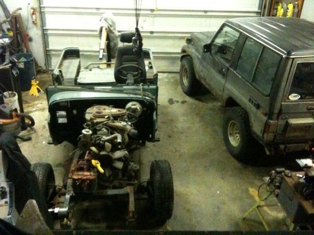

Yes, that 70 would be Falcon. Here he is today

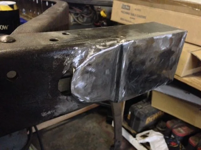

Here are those welds cleaned up.
I need to radius the corners, and run a bead on the inside a well.
