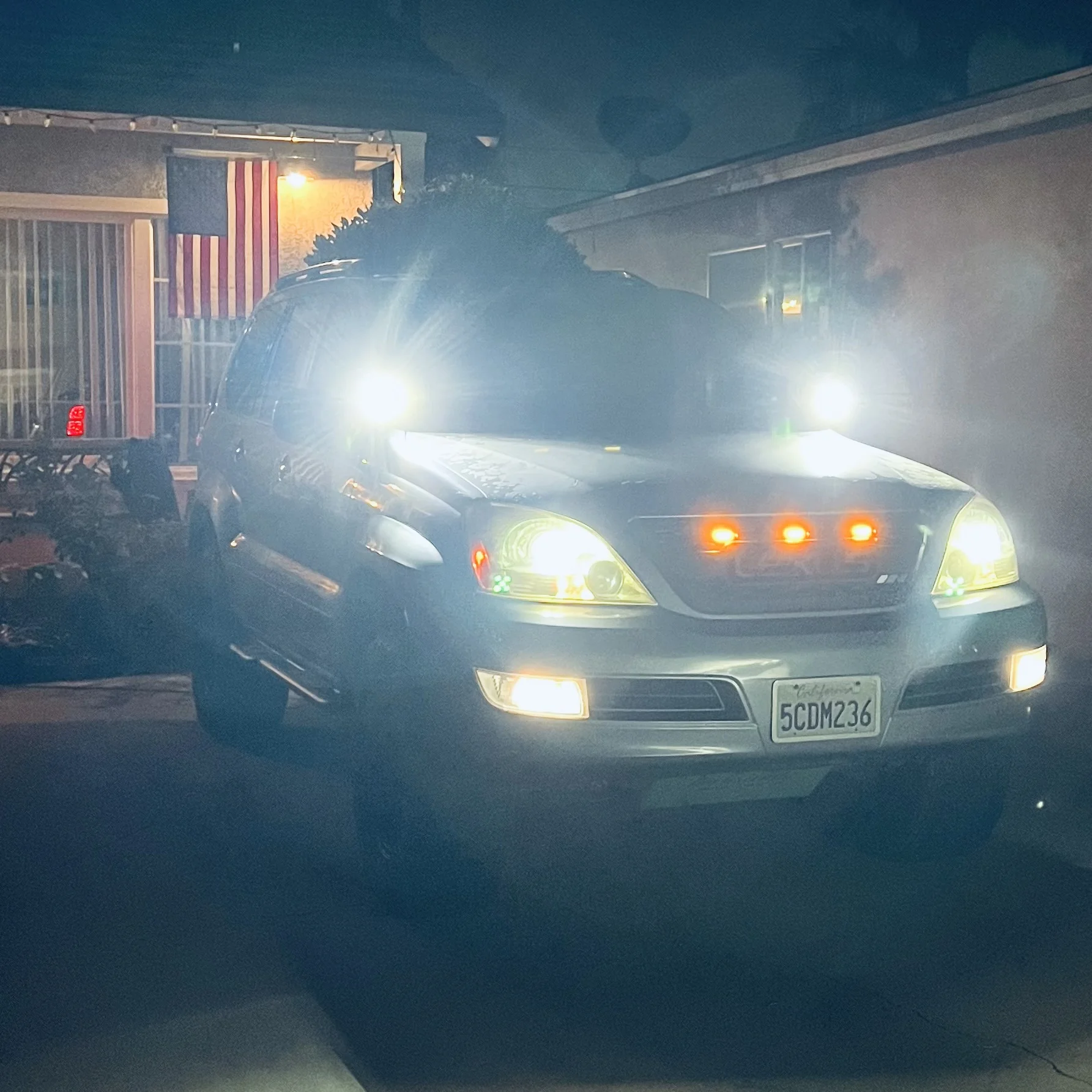

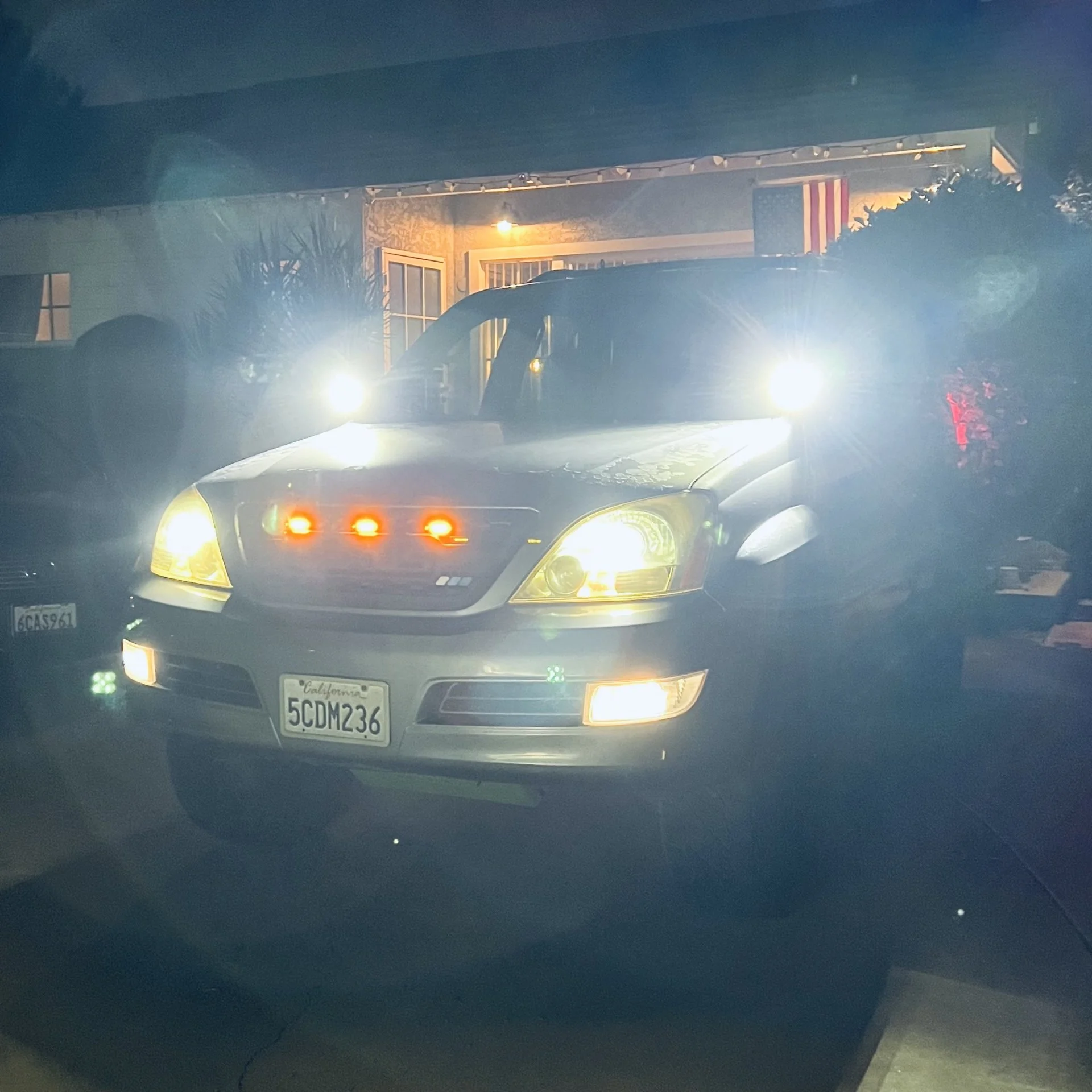

I kinda figured that out, so I ordered an inexpensive set of H3s from Amazon for $11.99/pair. They were 5000K, 55W, 12V and now all my lights are closer together in terms of brightness. After looking at my HIDs again, I think they are closer to 6000K because the less bright lights are now the 5000K H3 fog lights.
Auxbeam square fog lights = 6000K
HID headlights = 6000K
H3 fog lights = 5000K
When the cheapy H3s go out...I'll get another set of H3 in 6000K to match the rest of the lights. I just hope the cheapy ones last 3 years or more.
