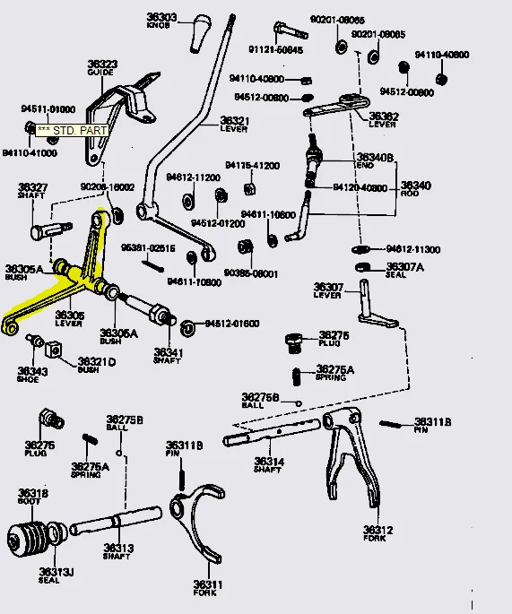

Further on this a 5 speed front drive link (from Toyodiy) part number 36337-60060. This is the link that attaches the transfer lever to the side of the transmission
Its the highlighted piece in the pic below - 5 speed is different than four speed
Just realized the mounting stud is interchangeable. Half the crisis averted and the highlighted part above is no longer needed. Just need shifter assembly for gears 1-5. Looking for a shifter assembly for H55.

Isn't the transmission shifter lever the same? As far as the shifter tower is concerned anyhow?
I'm not home or I'd go get one of each and look. But a 4 speed is the same as a 5 speed up top?
The stick part is the same but the ball area is different.
