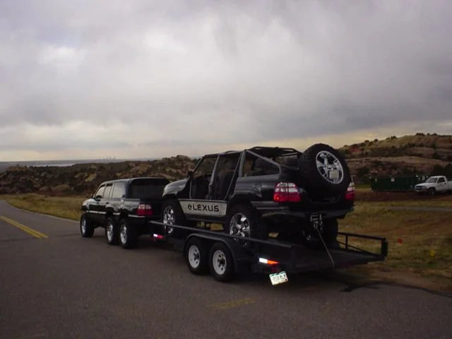

6.2 in the 80. Then chop the roof and yank off the doors. Make some new tube doors and a full roll cage. Rhino line the whole interior and buy some neopreme seats for it. Add locking rear storage for any valuable in the back? Almost like Podvin did with his wife's old 100...can't find a better picture sorry but here's what I mean: https://forum.ih8mud.com/attachment.php?attachmentid=99559&stc=1&d=1161821483
