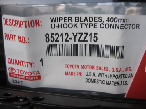

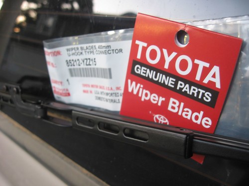

OK, so for the rear:
Part # for 1992 FJ80 TLC

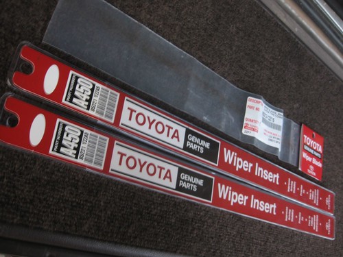

For the front I purchased these wiper inserts for the front wiper frames.
Thought I would save myself a couple of dead presidents.

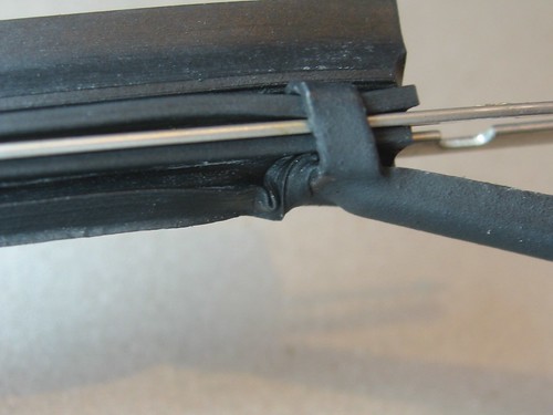

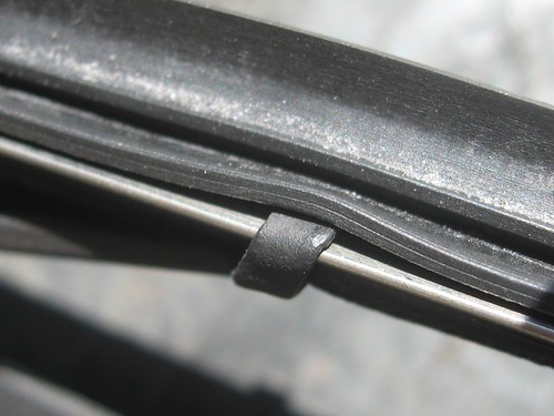

Was having a few issues though:
The wiper just did not like going in under all that pressure of the clips being on the outside of the rubber...
So I tried it this way:
With the retaining clips between the rubber and the metal runner. But there was no way to lock the blade in place. :mad:

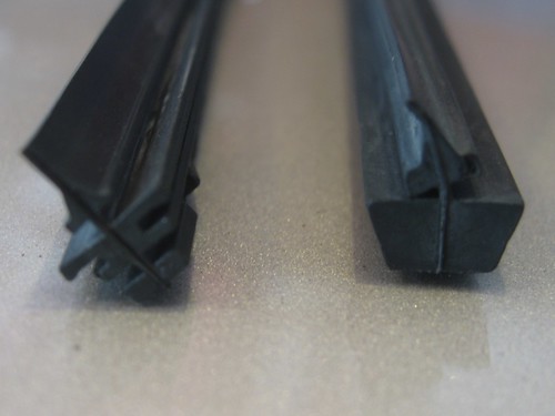

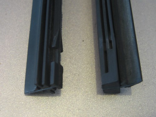

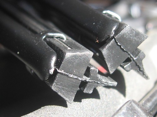

Luckily the garbage man had not ran yet, so I pulled the old rubber-blade out and see what was going on:idea:... Sure'nuff...
DIFFERENT
New Insert on left - Original wiper on the right.:confused:

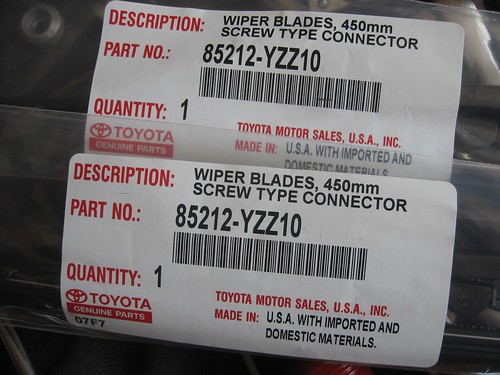

So back in the truck and :steer:down to the local'yota dealer to show them what was going on. They had no answer, but they did have the full replacement version for $12 more:doh: Bring it!
The way to go version!!!:hhmm:
