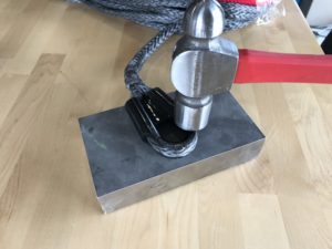

Just FYI for folks.
Warn bought Factor 55.
Then Warn flared out that end loop at the end of the cable to the end of the new cables will no-longer fit the factor 55's.
There is a procedure to crimp or squash down the terminal look so it fits the factor 55 ends and it involved either hammer the flare back down or taking a press and pressing the end loop down so it is back like the earlier flares and fits the factor 55.
This procedure is on the factor 55 wed site.
Just so you are aware.

WARN now has it under FAQ -- then "Why doesn't the end of my synthetic winch rope fit my factor 55"
Then it says
If you need additional assistance with this process, feel free to call us and we can talk you through the process 208-639-1674
You can pound it down with a hammer.

You can change any winch from Cable to Synthetic. If your cable winch has been used, make sure you file down any sharp burrs or damage that the cable did to the fairlead or the drum so that you don't damage your new synthetic rope. Also, synthetic line works better with a hawse style (not roller) fairlead. With Synthetic you can use an aluminum fairlead which can save a bit of weight.
