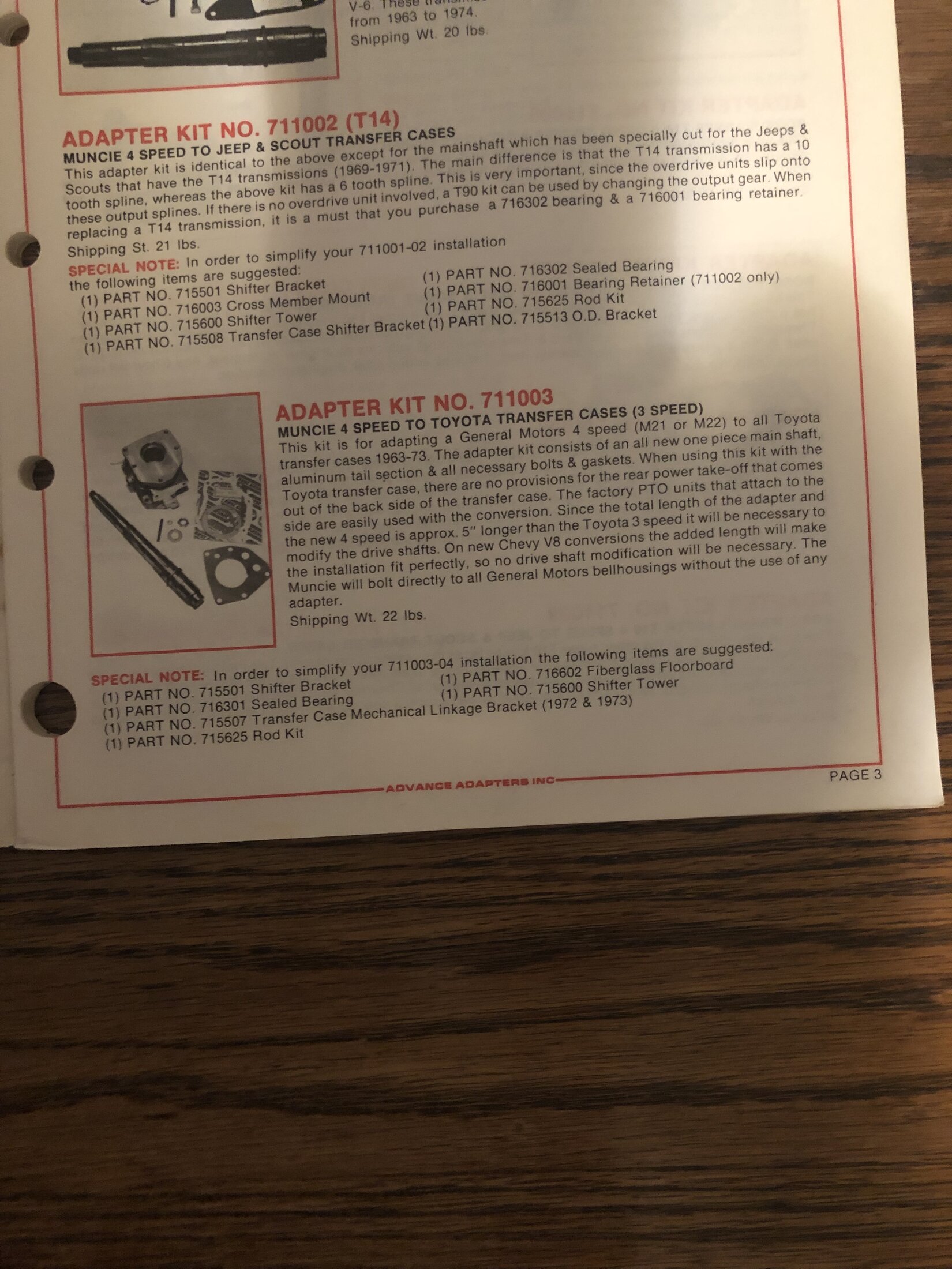

What transfer case do I have? Anyone interested?
Anyone have an explanation for the shift point on the adapter ?
It’s the reverse. Muncie 4 speeds (passenger car versions like this one) have the reverse pawl in the tail housing. That adapter is essentially replacing the tail housing so reverse needs to be integrated into it.
