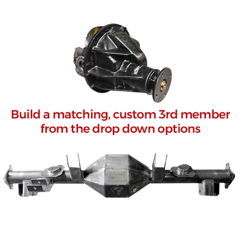

So, getting ready to upgrade the rear axle assembly. There is a Dana 60 from ECGS and a Diamond housing rear from Justdifferentials. NOT debating which company is better, I was wanting to know is there anything that stands out good or bad for either axle assembly. Price is about the same,Dana 60 has bolt on rear cover... What else? thanks.

@LowDown , good points made me think and do more research. The D60 option says this, (refers to locker option)
Retains stock brakes and shafts with 30 spline OX only! All other locker options require 35 spline shaft upgrade (Upgrade shafts below)
The Diamond option is set up for 30 spline chromo axles, and all brakes,bearings etc... will still be good.
wms-wms ? no clue, whatevah FJC stock width is, I assume.
From a friend that went the Diamond route with his GX, he said you could extract the entire axle/brake assembly (no bearing pressing needed), just the 4 nuts behind the backing plate, and then bolt stock axles to the new housing.
