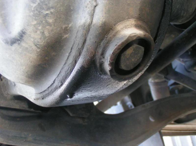

What size socket is the diff drain plug?

Searched but could not find. What size socket for this?
attachment.php
15/16" or 24 MM will work. Tip: Since you're having to ask about this, be sure you can get the "fill plug" open before you drain it. It would be a shame to drain your diff fluid out and not be able to refill it - which would render your 80 undrivable until you could replace the gear oil.
Edit: There are ways to allow you to drive it with out front diff. fluid, but just trying to keep it simple.
