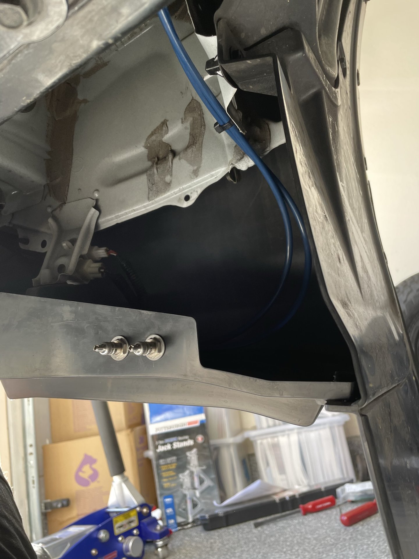

Here’s a picture of where I mounted the valves to inflate the bags. Relatively hidden but easy to access from under the vehicle.

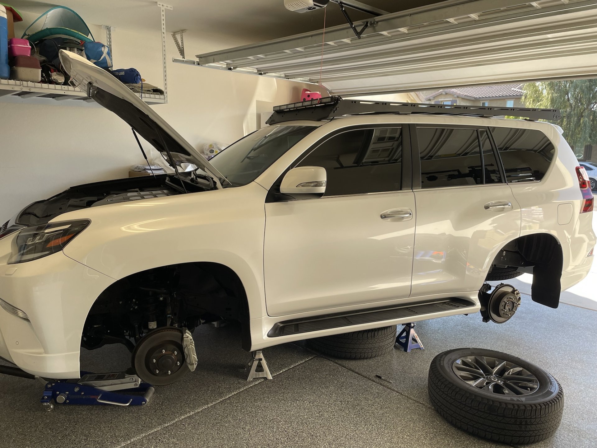

Definitely need 6 tons. My world of wrenching has not been on lifted vehicles, went to begin the install on my lift last night and I was not able to jack the GX up while allowing full droop on the wheels and tires with my 3 ton jack stands. It was not even something that had crossed my mind.
This is obviously old for you, but i'm more just reassuring 6 ton is the way to go.
I got it situated with my 3 ton with a sheet of mdf I had laying around, but I still was not able to get high enough once I started fitting the new wheels and tires (34 inch wheel vs stock 30 or 31?).
if you dont need full droop, 3 tons will work just fine using the rear axle to place the jack stands.
if you need full droop, 6 ton placed at the frame works 10x better.
And just make sure they are tall enough, as mentioned above.
It's fine if you're only putting the jack stands under the axles, but if you're placing them under the body mounts, then you have to have much longer ones.
