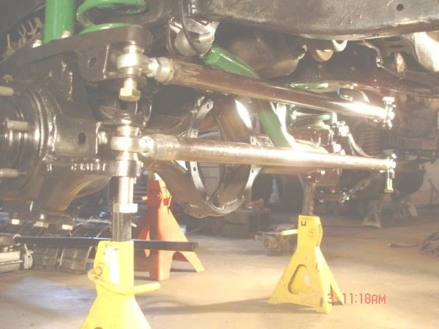

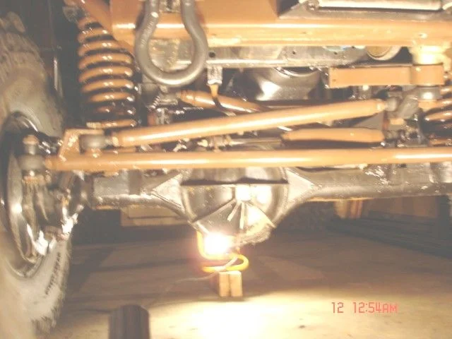

I use 3/4" QA1 or Aurora chromos rated for 28K min. mounted in dbl. shear, along w/ dust boots from Baker Precision Bearings (keeps out the grime) on both trail rigs. All steering connections are dbl. shear on both:

Curious how you get away with your panhard mounted opposite side of the frame from your steering box? Plus the angles of the two rods are not even close to parallel?
Sometimes you have to design a suspension where the *common ways of doing things you've seen in magazines have to be altered to fit certain areas & that's the case in both here. One's been trail tested & works well, the :pig: is a current project, designed similar & I expect it to perform just as well ;p
Interesting! Kudo's for not following the herd but the geometry just seems wrong. Complex array of angles work in harmony from canceling each other out. Your system seems to have conflicts in that physical aspect. I might have to draw this up so I can understand. Thanks for the reply! Seems like the ultimate droop induced steering! Sorry for the hi-jack!
The main reason the panhard is revesed is the diff location. If I had a driver drop, then no problem. I have very limited space & that's the only way I could locate it. Your book may say the goemetry's all wrong & prolly is, but until you get it on the trail, you'lll notice no binding or restrictive movement ;p

Thanks for the pics and info LC, I am strongly leaning toward using the 3/4" QA1 chromos. I was thinking of trying to come up with some sort of dust boot also, I wasn't sure if they were available.
Do you have any more pics of the way you mounted the double shear on your toyota high steer arm? I have something very simple in mind but can't go any farther until I get the rod ends.
