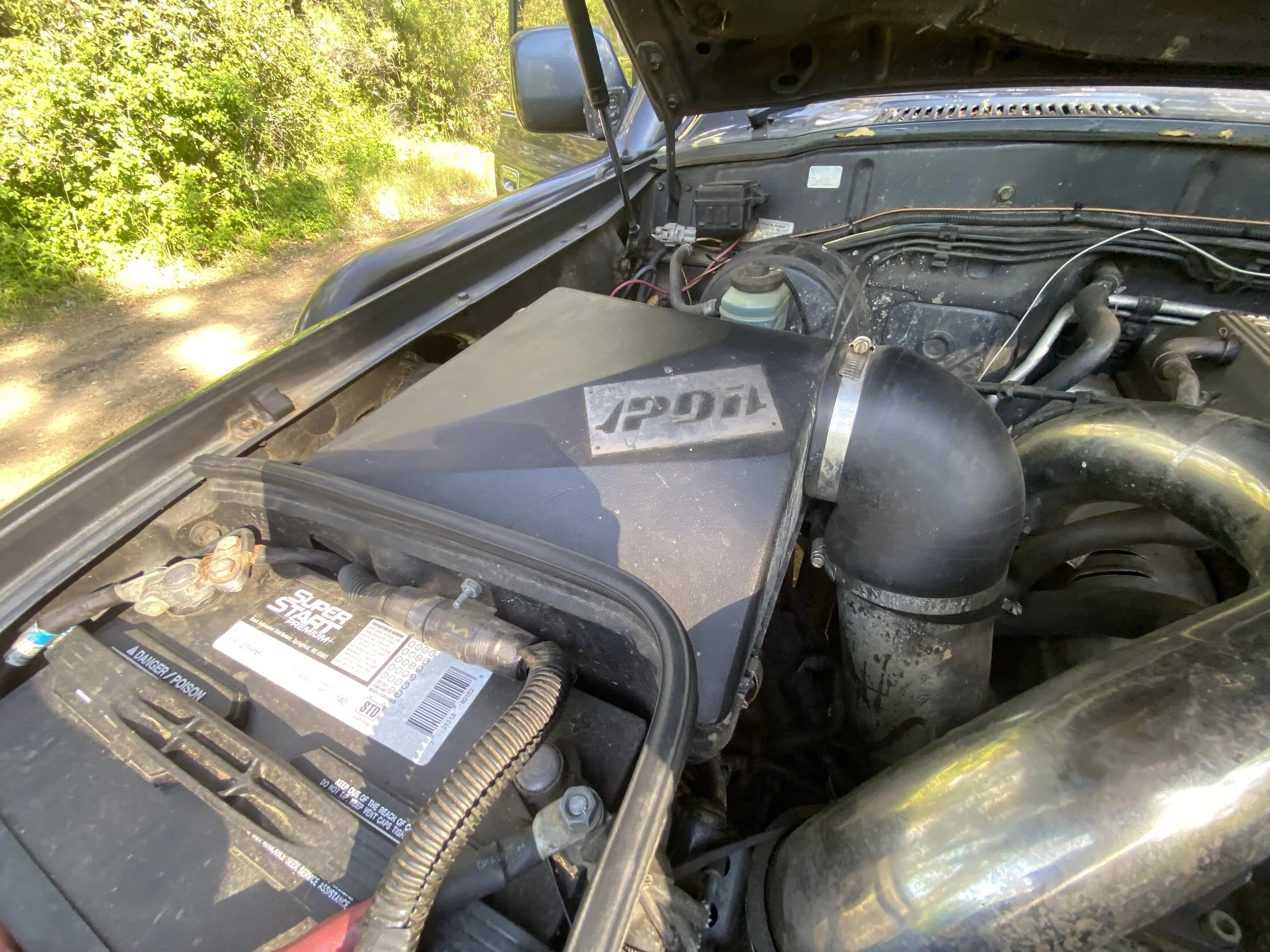

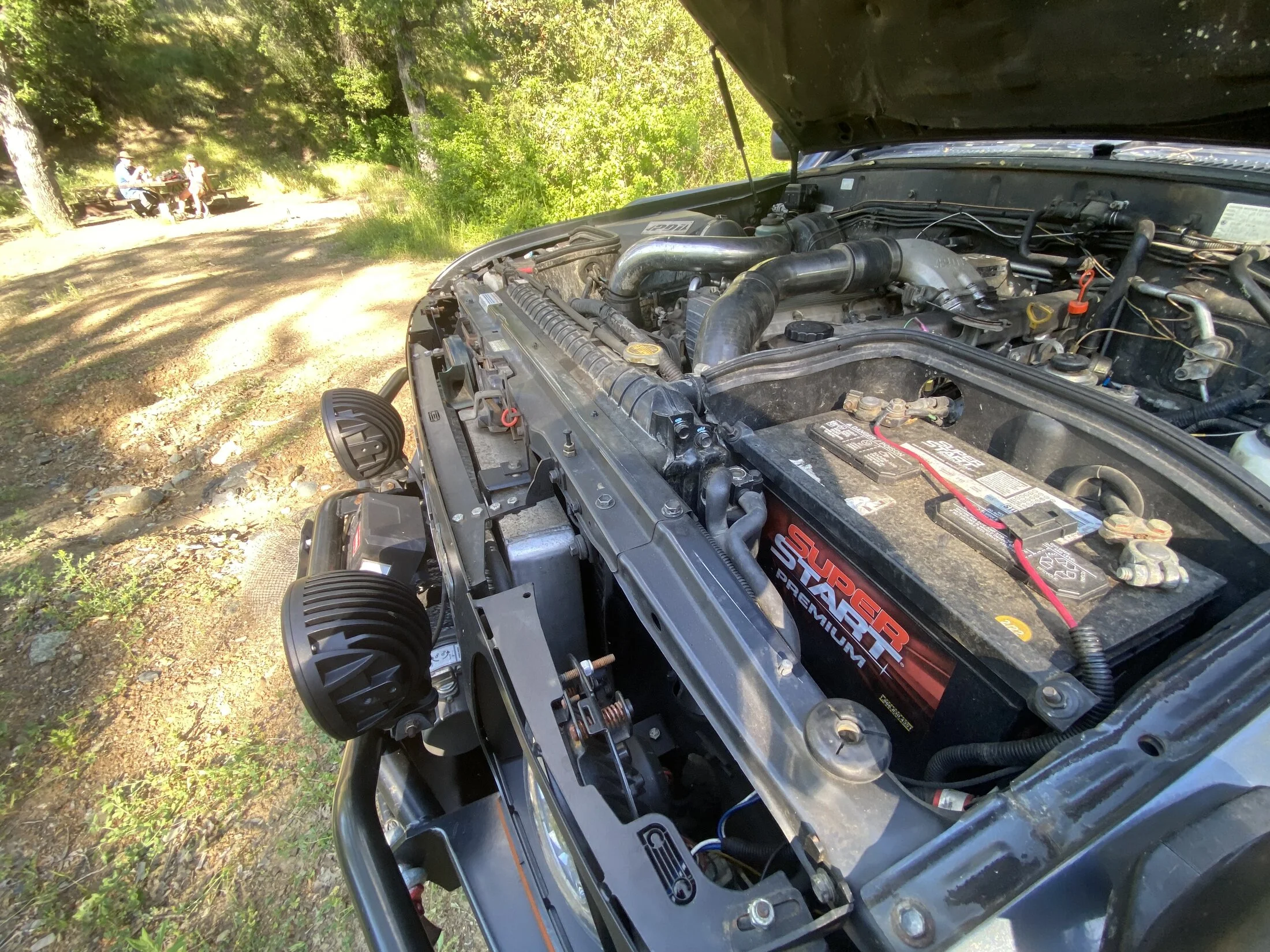

I’m selling mine sadly but I have a 1990 1hdt hdj81 I did the g turbo grunter the pdi intercooler with custom air box and snorkel from moonlight fabrication. I did sea performance exhaust. I rebuilt the injection pump and did new injectors and custom fuel pin. I have about 23psi and did very little smoke and OH MY GOD this is not a gas powered 80 series. I have a chop top 1997 on 35’s with bumpers and a regear and my diesel fully loaded with a 38 gallon fuel tank and roof top tent plus 4 arb drawers is way faster. The tired will break loose on wet pavement and around corners if I give it gas either 1 or both rear tires will break loose depending on the type of terrain. That being said i personally feel that it lost the reliability I had with my gas 80 series. Also I upgraded the transmission with a billet torque converter from wholesale automatics cuz the stock auto could not handle the power. Hope this helps I am likely going to do a build thread on this rig before I sell it if nothing else to save someone else all the headaches I went through

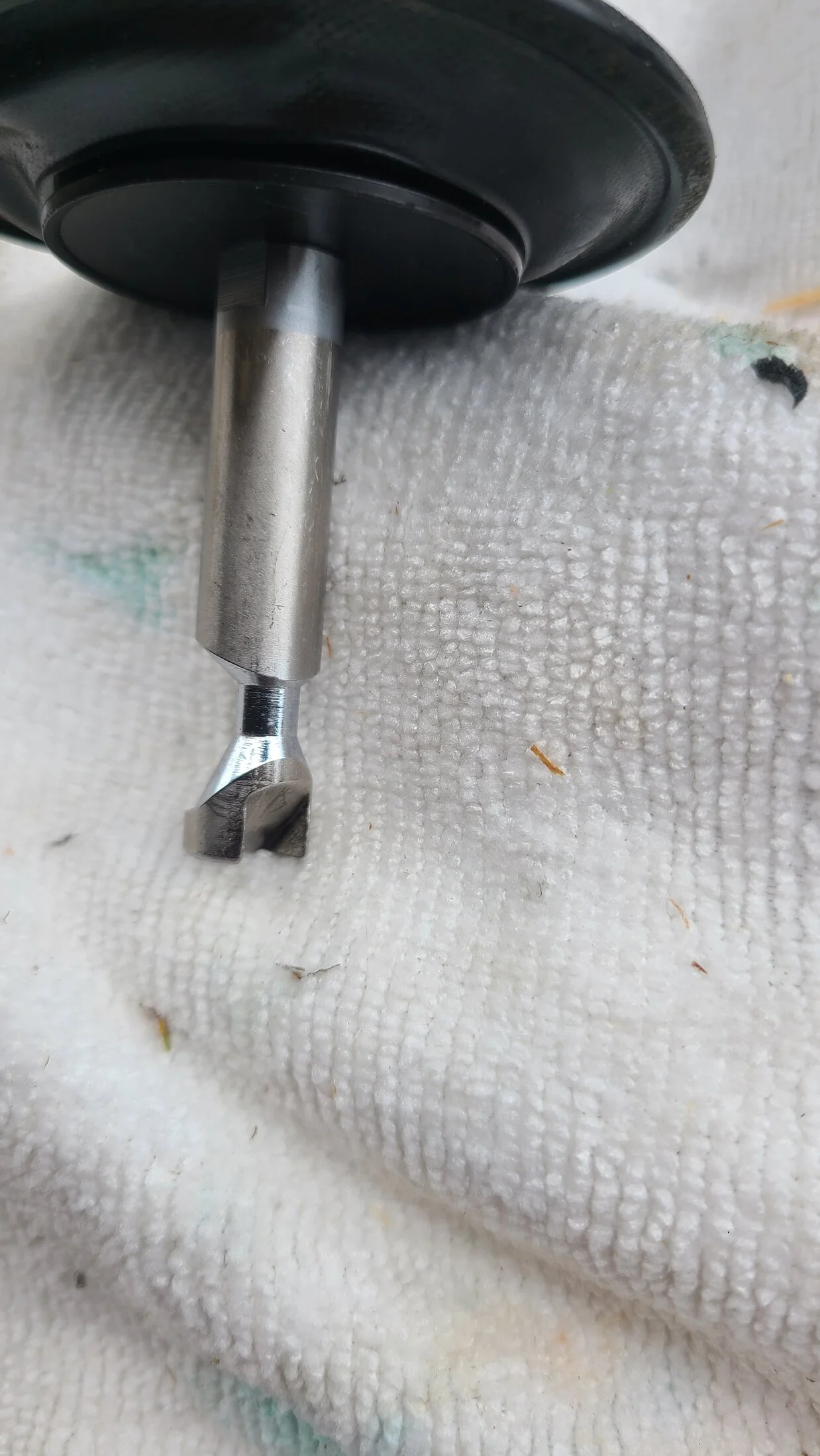

I pulled the fuel pin yesterday. This is aftermarket, right? I didn't think the oem had a recess for the pin to compress when reinstalling.
I dialed the star wheel down a few clicks to try to drop the pin out of the defueling angle a bit. UT gave it more range in the throttle and acceleration through the rpms happens where it did just climb to an rpm and hold.
I have the egt gauge in a pillar mount (which kinda sucks in fitment) so just need to drill the manifold and then I can fiddle a little with what's there and decide if anything more than an intercooler is worth it.
that’s definitely aftermarket. Seems like it was running at full fuel a lot and even moving into overfueking where it turned the fuel back. I can’t exactly remember why but I had to make a shim from a housing if a plastic bic pen to fit over the pin and stop it from moving to overfueking if I remember correctly. I need to open it up again and look i honestly got it right and never touched it again.
Definitely aftermarket, and not properly hardened.
You can see a groove in that first pic where the following pin has rubbed a trench into that.
OEM is more polished
