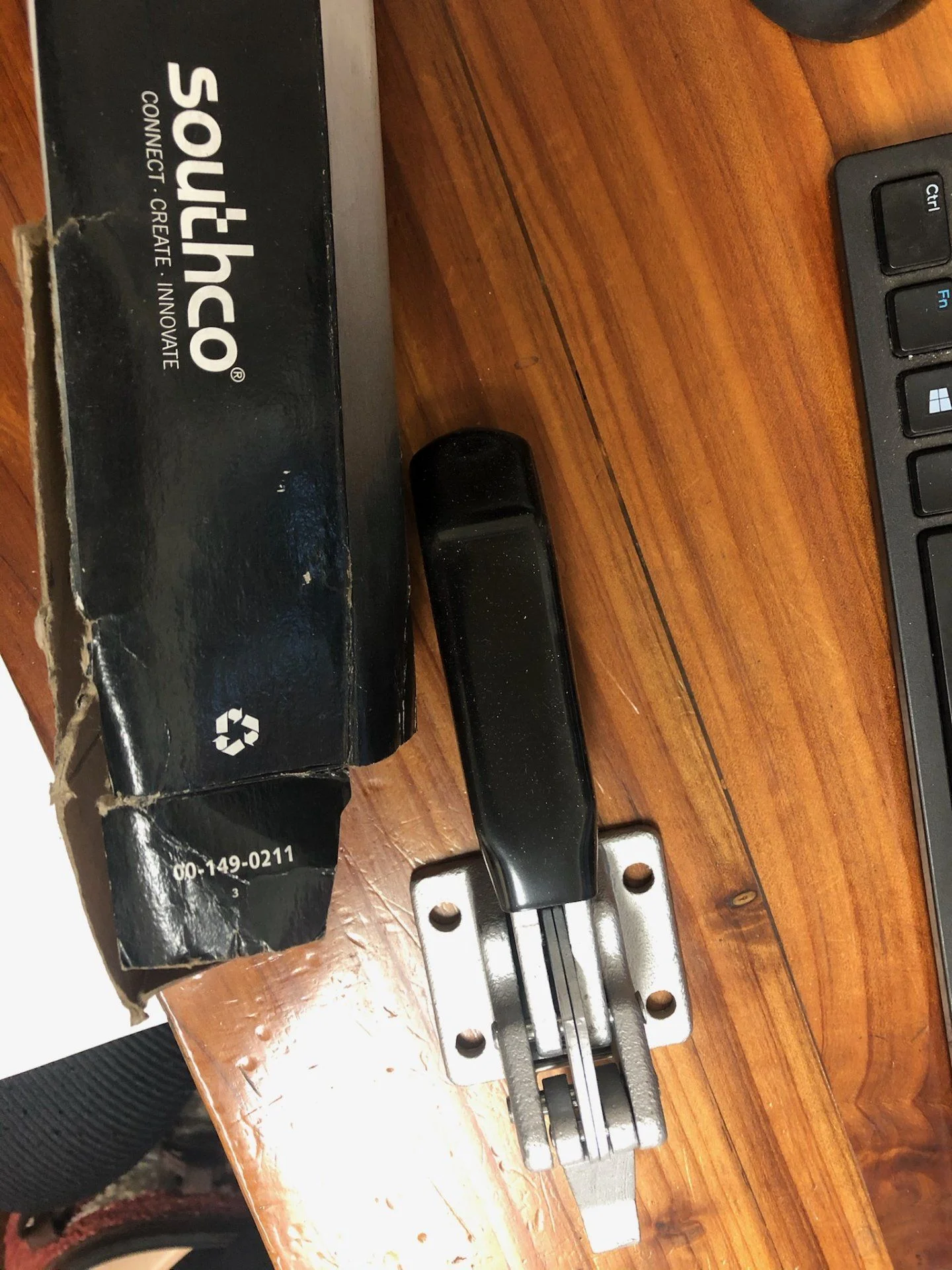

Dear bozncsuf, Greetings. Thank you for your observation and online examination of my vehicle. Your encouraging and complimentary words are appreciated and welcomed. I do not remember the specific make etc. of the Slee swing arm latches we replaced. The ones that Slee provided quickly rubbed/abraded/vibrated themselves right through the stirrups - they were subpar. Gary Kardum of Mudrak Custom Cruisers in Sonoma CA. selected and installed them - He might remember. You can contact him directly, I will also contact him and ask. If he remembers I will post it to the specification in the picture gallery www.reichek.org/lx3v
Dear bozncsuf, I have contacted Gary at Mudrak, The Latch Clamps he used are Southco # 00-149-0211 see attached
