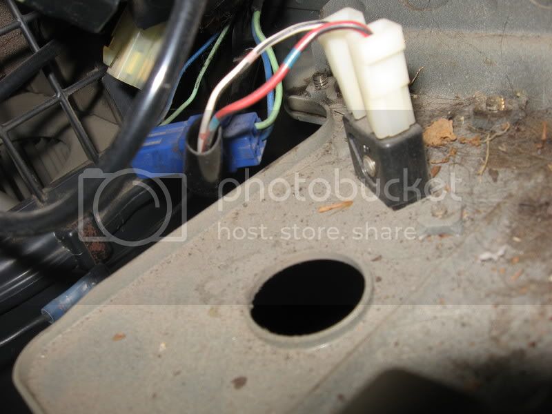

While troubleshooting my A/C electrical, I saw this part (edit: the black, oval part on the underside of the metal part of the dash):
It connects under the glove box like this (the factory connector):
What is it?

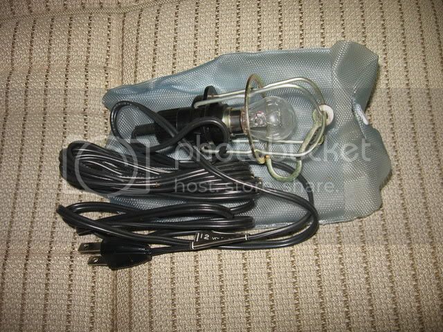

Never mind- I just remembered what it is- I even have the factory part for it in my glove box. I'll post a picture of it later in case I'm not the only idiot out there.

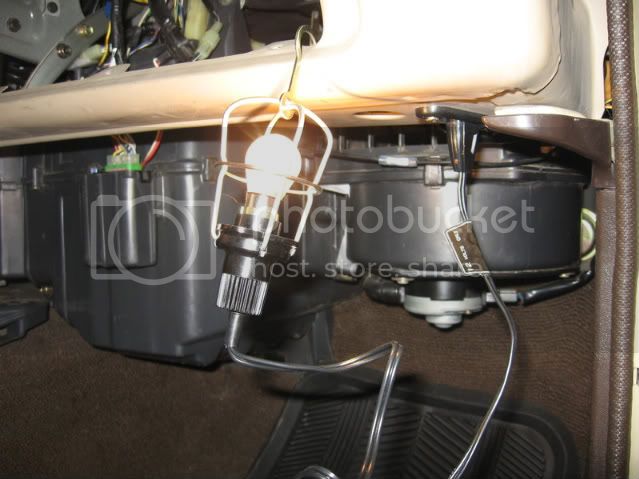

Outlet for an inspection or trouble light I believe. Spector used to have some, but I can't find them on their website now.
i think the dealer might still ahve them too. looks like a miniature drop light, with a two prong plug like you'd stick in a wall socket (but don't do that)
