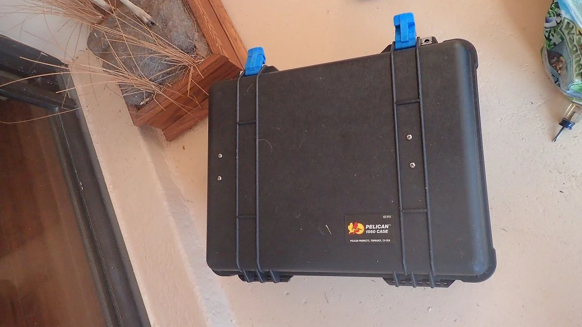

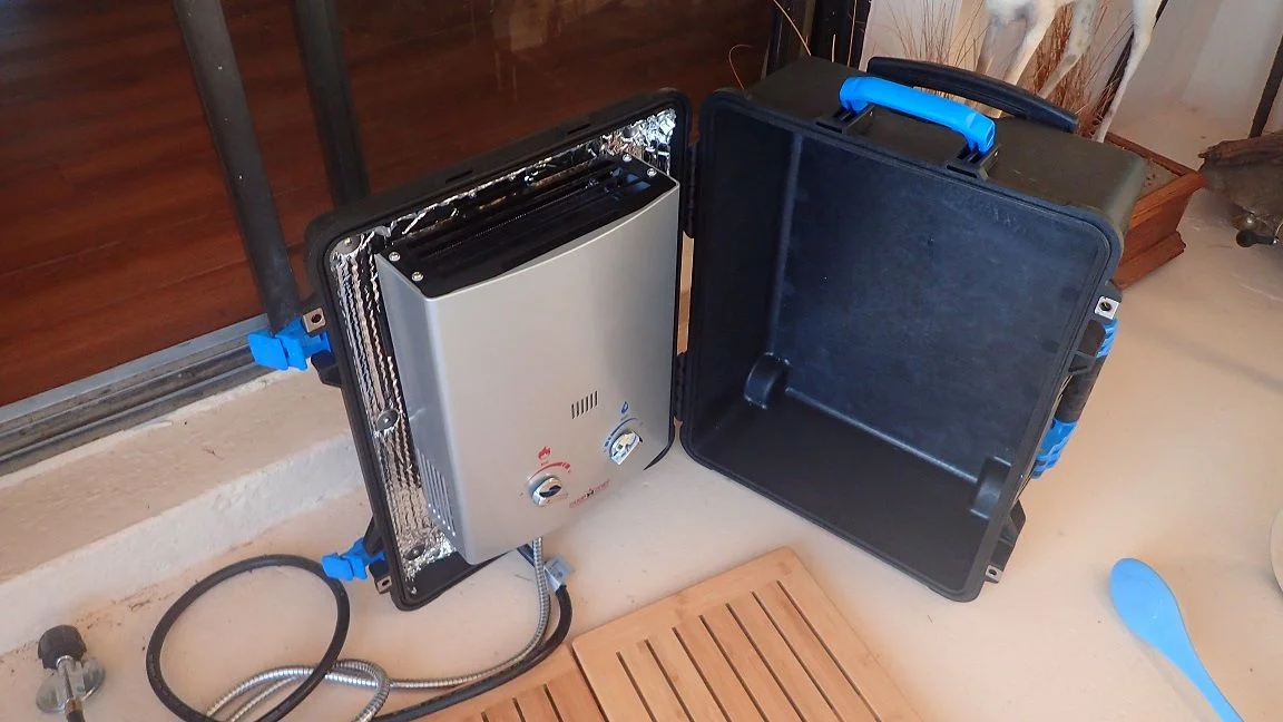

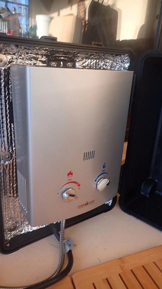

The Camp Chef Triton. I saw some mod's to fit it in a suit case similar to a pelican and extend the hose.
ended up like this.
ended up like this.

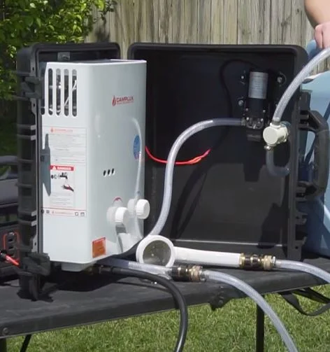

I think I have seen that youtube video where the guy built this. He was correct when he said the fittings are the hardest part to get sorted out. I created a box for my pump separate from the heater case. Making it modular allows me to have pressurized water at camp without pulling out the water heater. I have gone thru about 5 different variations to get to the one I'm using now.

I'm not going to put the pump bolted to the case, but I do like the idea of the water heater in a case with the extended hoses.

You probably saw a previous iteration. I haven't updated my build thread yet. I need to. I now use a pump alone in a box and attach it to jerry cans. Have you purchased your pelican style case yet? If so, which one did you end up getting?
