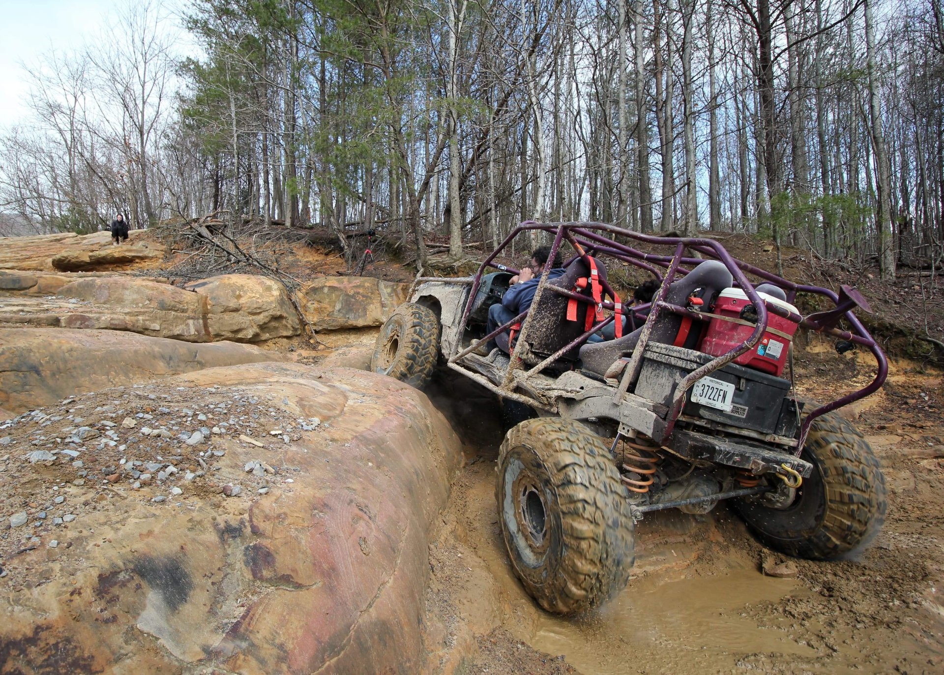

So, the DOT compound Milestar Patagonia MT02's are impressive....busy morning: ran the SuperCrawl 2021 Shootout lines, ran the 2021 TrailBreaker LCQ course, and ran the 2019 TrailBreaker course (Red Dot). Simply stupid level stuff.
The tires are 42" tall. This drop is BIG, and undercut, so your drivers front tire just hangs...and then falls....
stuck the landing :)

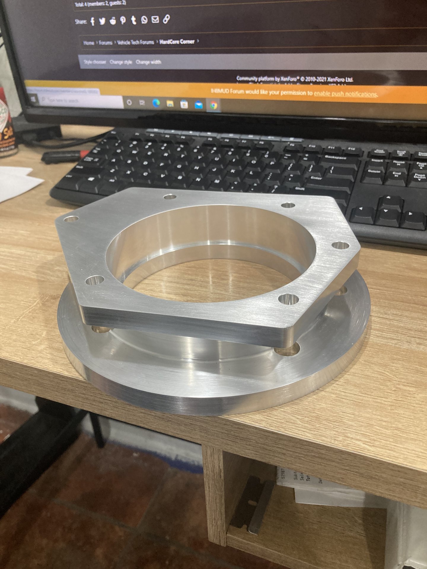

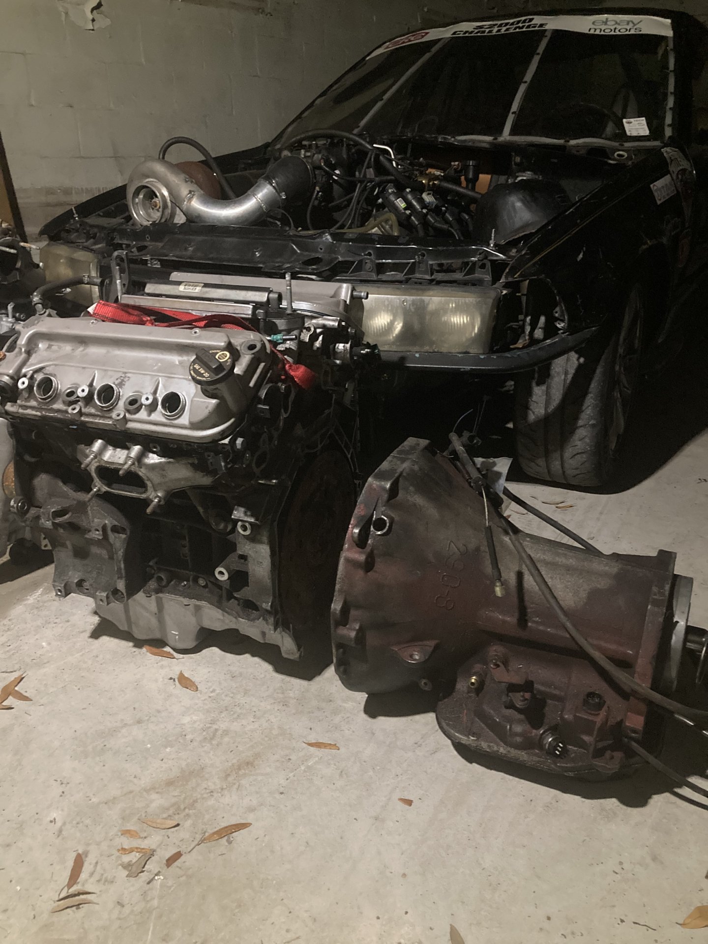

It’s not going to be a real buggy but it’s not going to be much FJ40 either… but this year I’m finally building what i’ve wanted for a few years, a FJ40-style trailered rock crawler so i can do some big boy trails without being worrying about what I’ll do if I smash a window out. 😁
Very excited to attempt the Honda Odyssey + 904 adapter, as well as use Brennan M aka @Mieser super nice D300 shorty park delete kit I bought early last year.

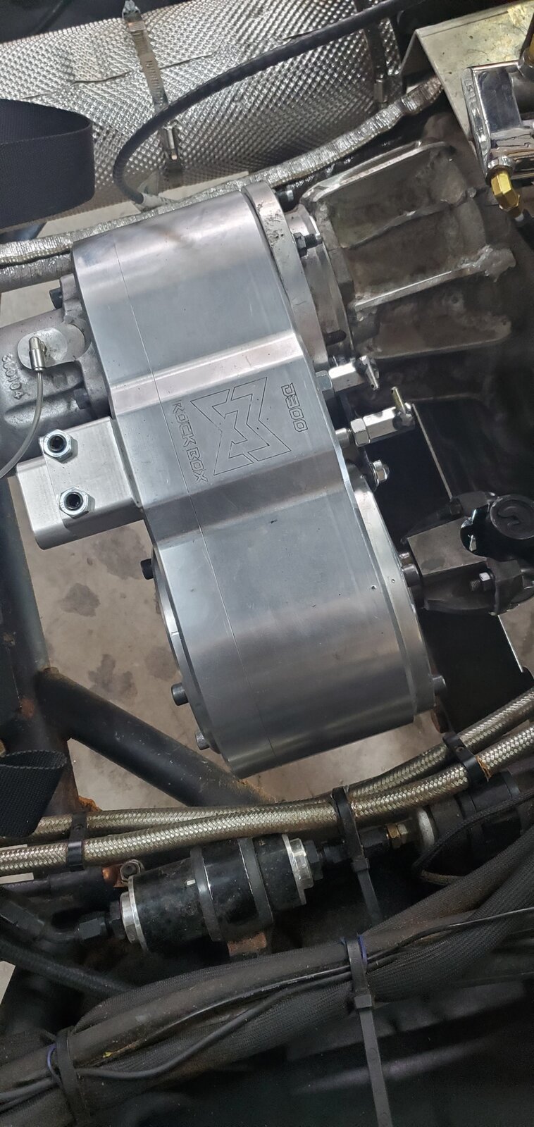

Built/installed a Midnight Metalworks D300 case....allowed me to use the 32-spl front and rear outputs I already had, and choose between the stock 2.6 gears or 4:1's. Because of the portals and my setup, I stuck with my existing 2.6 gears.
So is this like a stock Atlas case in comparison? Just use the internals from a 300? Kind of like the old Warden 40 case?
