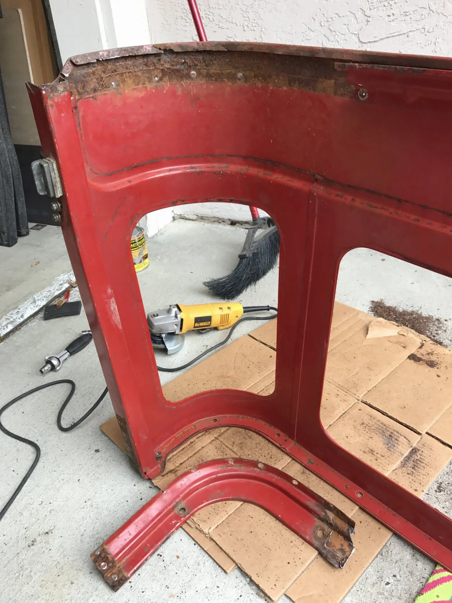

Doing some rust remediation - anyone have that piece on the ground they'd be willing to part with? I drilled out the spot welds and cut at the pillar to get it off. Passenger side of a 74. I plan on replacing the rusted section at the top of the photo. Thanks!

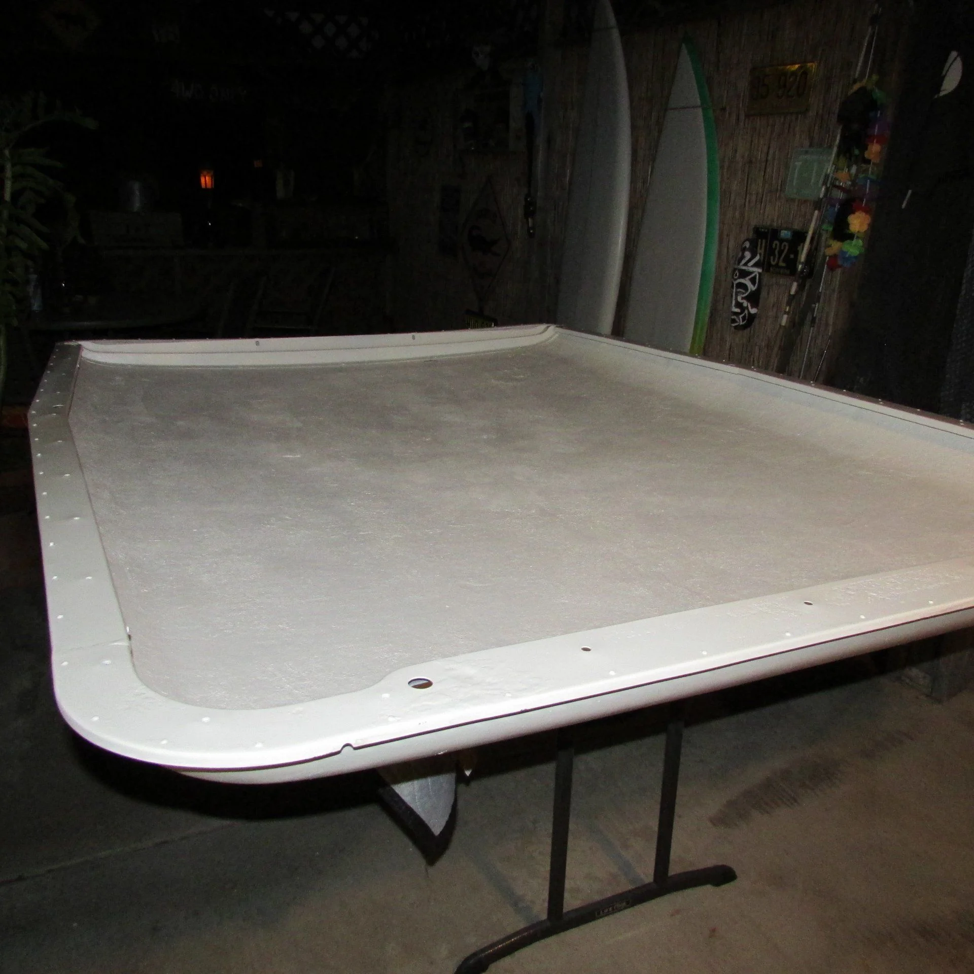

Ok so how would I apply that paint? Do I need a professional sprayer? Thanks

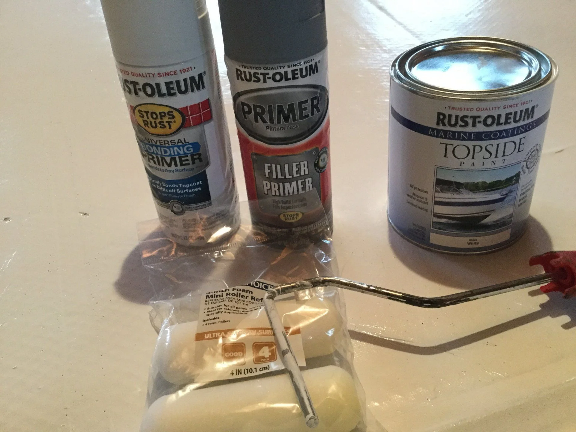

Here's what I used for the inside of the top:
Also... a brush comes in handy for the stubborn places! @sterling may have used a different quality roller for the outside surface of the top.
Oh how cool you can apply with a brush/roller and still get a smooth glossy finish? And I thought I would have to spray......:beer:
Whoa now... let me mighty clear on this - a spray gun would definitely yield a prettier finish if you're looking for high end results but I was satisfied with the way the inside came out with roller and brush... I'll let @sterling chime in with feelings on the outside but his picture looked darn good to me! My outside finish still looks acceptable so I'm just polishing it up for now...

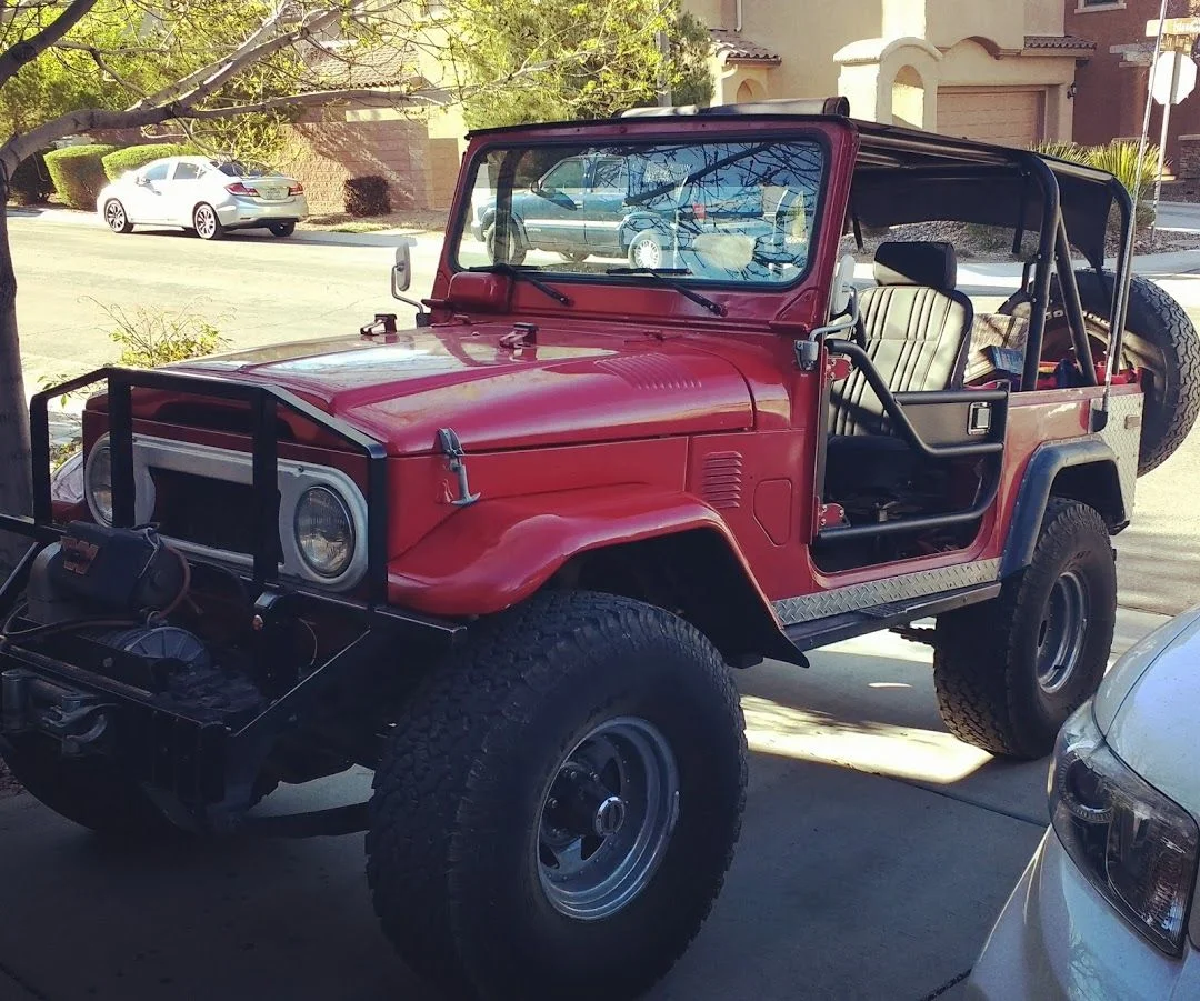

Not alot this week, worked on figuring out what to do with the front bumper. The old brush guard was killing the "FJ40" look in my mind so I ditched it. Trying to decide how to set up the front bumper now. I ordered a new grill mesh but UPS decided to fold it up like a taco. I cut out the old mesh, straightened out the frame and welded some expanded metal I had laying around and a new crossbar out of flat stock. The holes are a little big now for my taste but it is definitely beefy now.
No Brush Guard:
Brush Guard:
Rust-Oleum topside paint in GLOSS WHITE, Amazon's the cheapest but the chart when you pick the color gives the wrong code for gloss white.
I used 1 qt. on the underside and one qt. on the top, that gave me 2.5 to 3 coats per side of the top.
Just to clarify, I used this as a headliner substitute.
On the underside I used a 4 inch roller with a medium nap from Home Dep., same with the topside except I did the third coat with a fine roller for a better finish.
You will need a paint brush to feather the paint on the angled parts of the top and crevices.I would suggest a good to very good brush so the hairs don't break off and dry in the paint.
Also used a 5 inch random orbit sander for prepping the surfaces and wax remover/de-greaser before painting.
It is suggested sanding the surface with a fine sandpaper between the coats(I used 220 grit because that was what I had on hand).
At some stages of drying, the brush resulted in a better finish than the roller due to the paint hardening.
Drying time between coats is 24 hours.
Plan to throw away all brushes and rollers after each application.

Rust-Oleum 206999 model is what I used. Should be white in color.
Marine Coatings Topside Paint Product Page

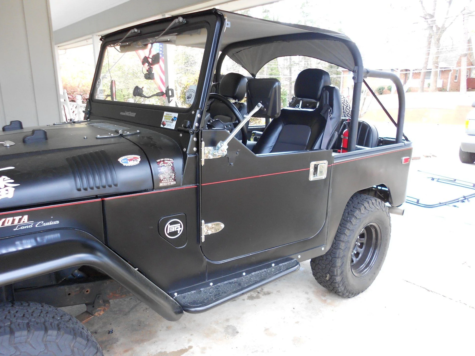

Been busy yesterday and today. (And my back is feeling it!)

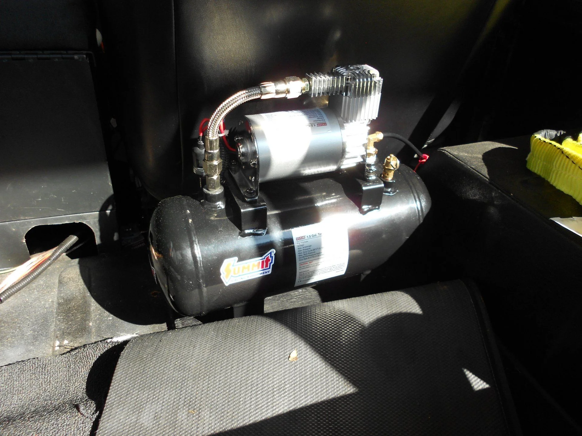

I started off cleaning up the wiring and making it look neater then started painting the engine compartment. A PO sprayed three color trunk paint and it looked horrible. I cleaned off what I could and sprayed over the rest. I installed a new air compressor for the air horns, ran new air line and moved the horns off the hood and put them in a more proper location. (I really enjoy the horns. A short blast will get even a deaf persons attention.) Now that April is just around the corner and the temperatures look to be getting warmer, I removed the soft top and installed the bikini top. Hope I don't regret that. Next, finish spraying the engine compartment, right front and bib, then some general cleaning.
