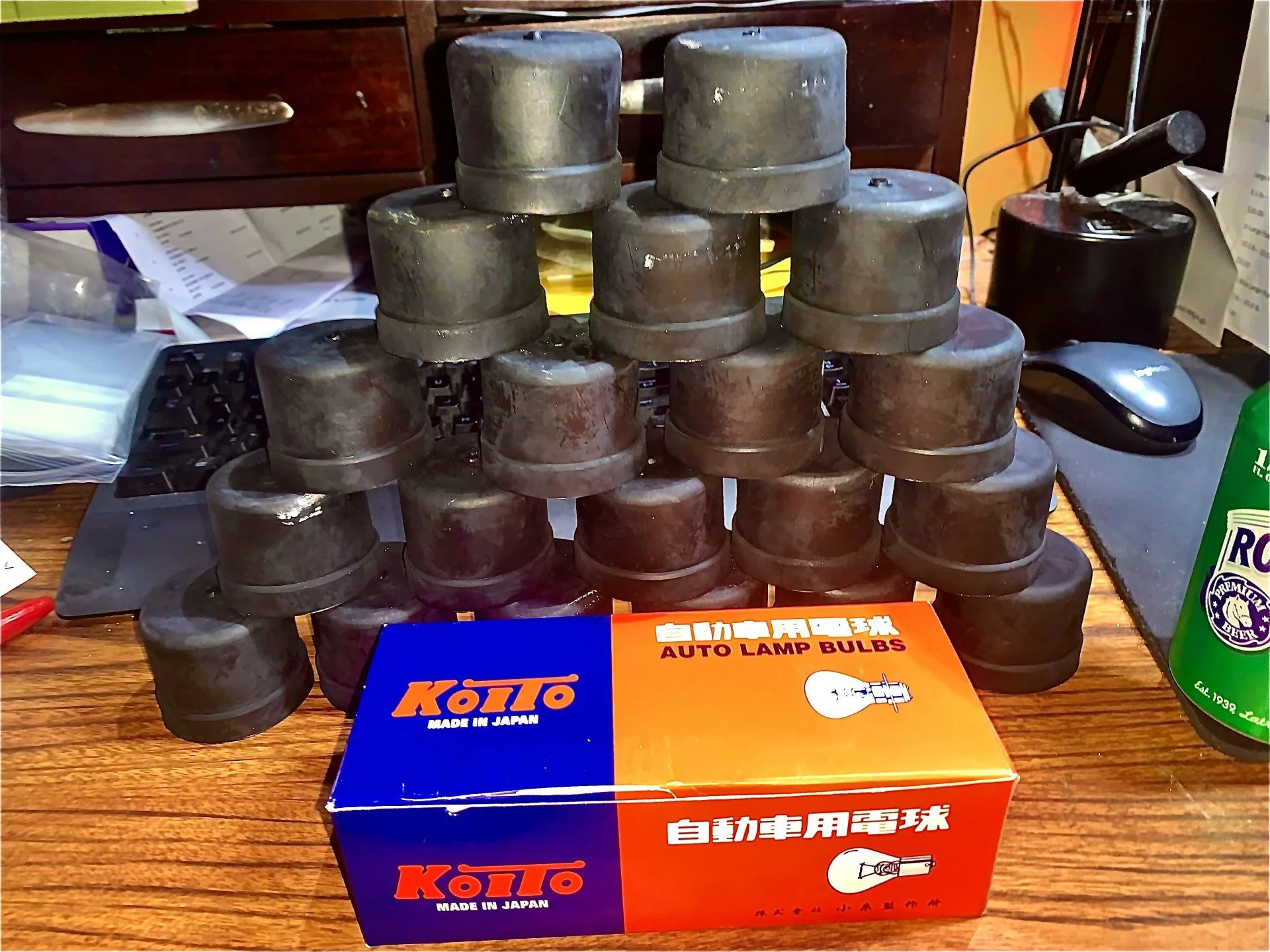

My long awaited re-up of reproduction oil sender rubber boots or engine wire # 4 sub harness sections main part was a welcome box to open.

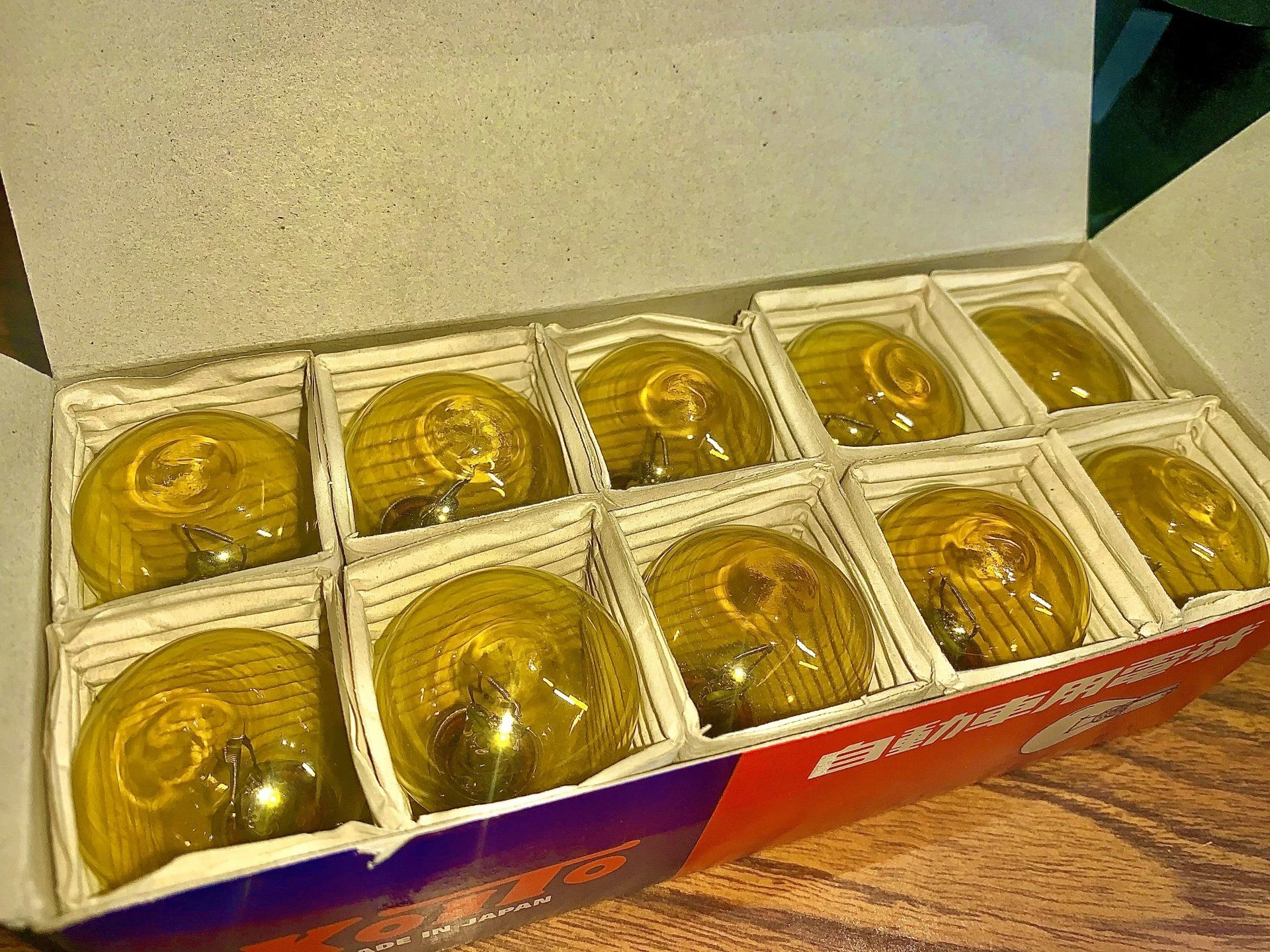

So are some jis KOITo amber fog bulbs , the only incandescent filaments still in my life that’s fir sure

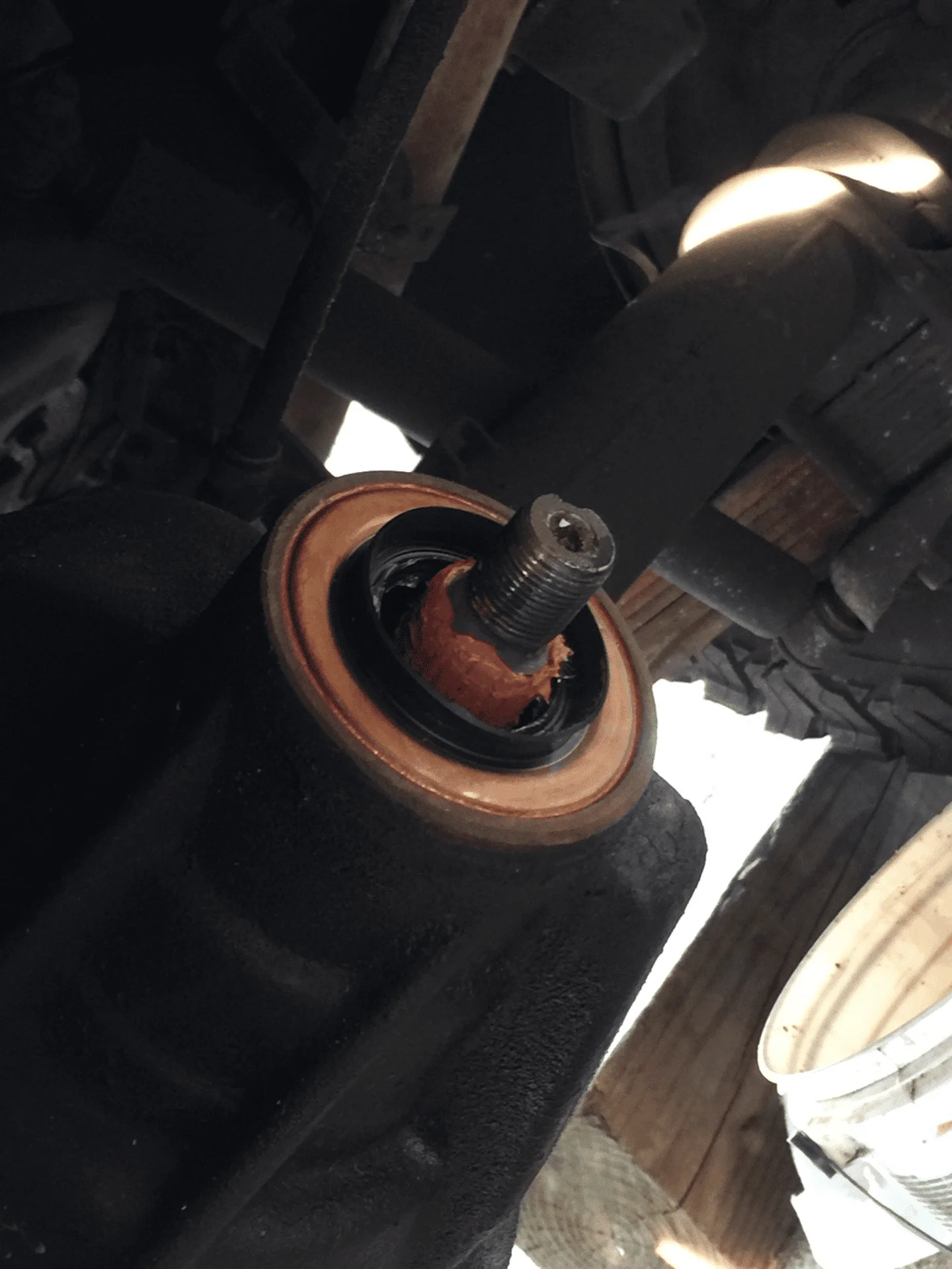

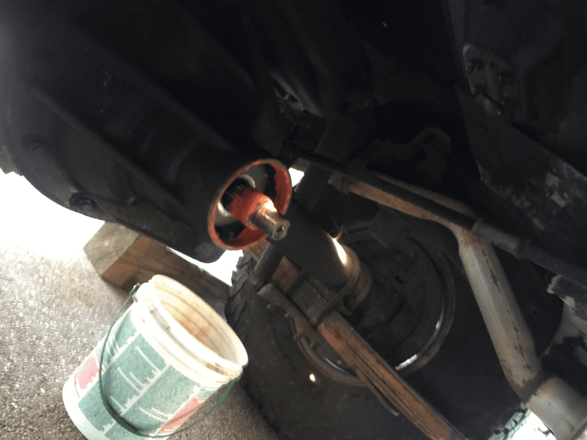

I started at 05:00 this morning to take the hand brake cable out because I felt it could do with a little shortening to be PERFECT. Took off the prop shaft and some gearbox oil drpped out of the capped end of the shaft where it attaches against the drum. Damn! It appears to me that my "helper" did not bother to torque and properly secure the retainer nut even after being told to give it 90ft/lb. Double damn.
I started at 05:00 this morning to take the hand brake cable out because I felt it could do with a little shortening to be PERFECT. Took off the prop shaft and some gearbox oil drpped out of the capped end of the shaft where it attaches against the drum. Damn! It appears to me that my "helper" did not bother to torque and properly secure the retainer nut even after being told to give it 90ft/lb. Double damn.View attachment 2625545
when you reassemble , obtain orange Toyota fipg trans axle sealant , apply well to all inner and outer splines to the shaft and brake drum , then use a cue tip and apply a generous amount where the hex nut you torque seats , this will prevent spline path of future leakage , this is a MUSTY DO ! don't skimp here , you follow prescribed above no leaks , you bypass , you will have minor to moderate seepage 100% guaranteed .........
00295-01281 part #
fyi these are my personal tech photos and the lenght i go to as a standard practice , by the book 24/7
and ................no leaks ever ...... :)
geez, that sucks. Had a similar issue, while digging in to the rear output seal leak i was able to remove the castle nut by hand after removing the cotter pin. Its amazing i didnt have more damage. Removed the housing and had it machined for a double seal. I will be reassembling shortly and of course will retorque everything too.
Very lovely Amber Koitos. Will those work as bib lights or do those only go into a specific fog light housing?
00295-01281 part #
Matt how much of this does it take to do the job correctly?
MA
1 single toothpaste size tube you get , is MORE then enough
see 00295-01281 IS a non-hardening its stays pliable and fres inside the tube fore years if not a decade , if YOU install cap on correct and then tape it sealed with electrical tape , store in bag all air removed etc ............
its a space age product before its time
i say GLUE IT ALL Together and no leaks !
i just found this here on MUD , he exemplifies the use of Orange 00295-01281 fipg same in kind to all the above topic .........

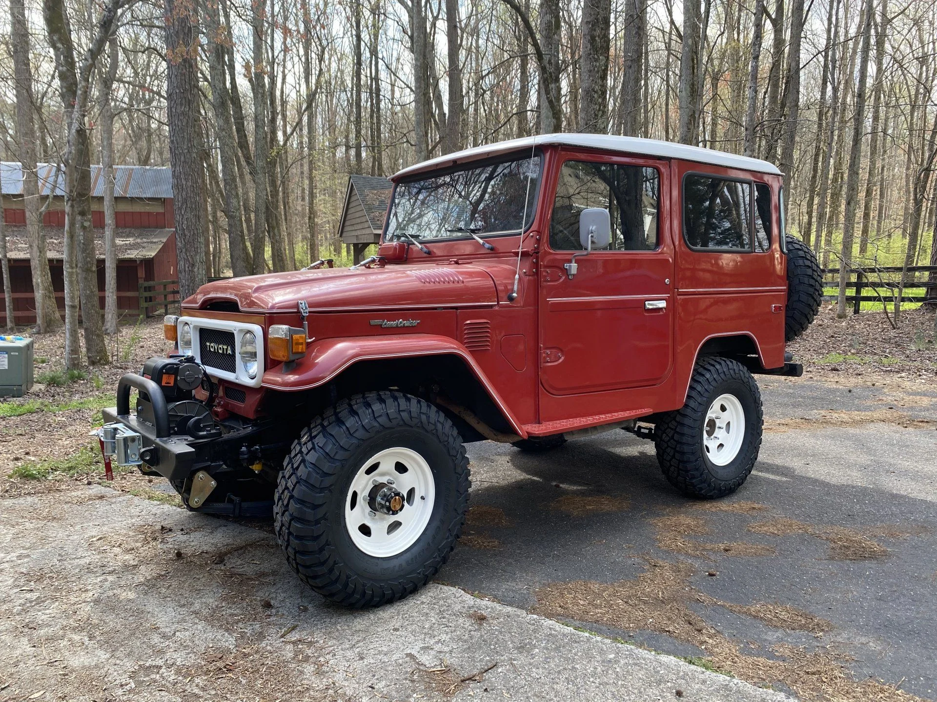

Man I like them tires! Are they noisy?
Yes, but noise is pretty relative in a rolling brick with no insulation. Tire noise is not the loudest noise in my 40, but it does contribute to the overall noise level. I am running KM3's.
