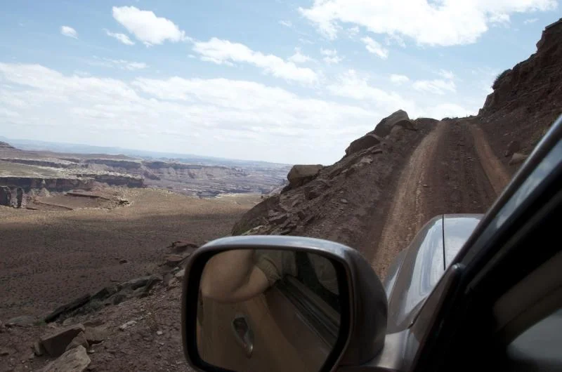

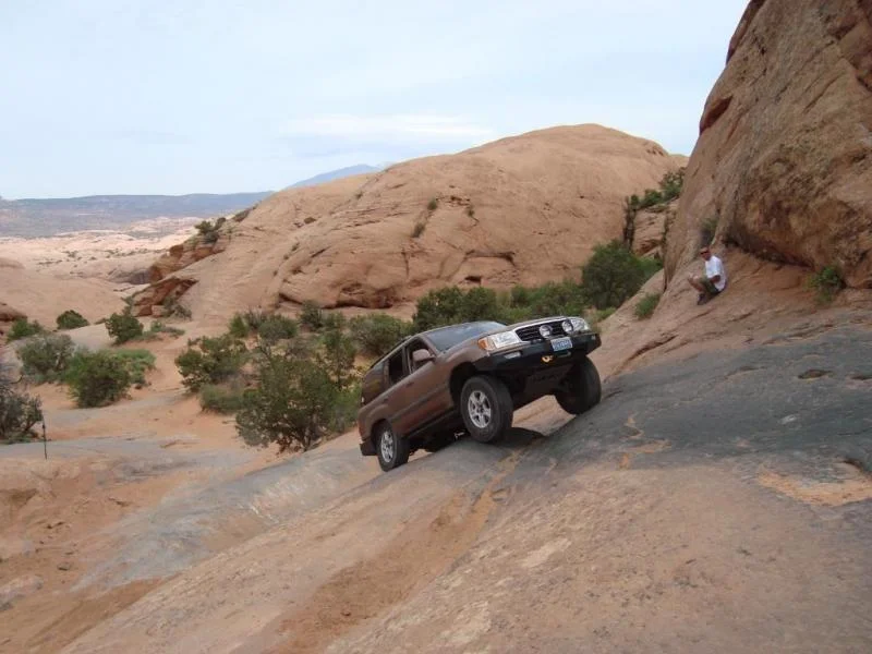

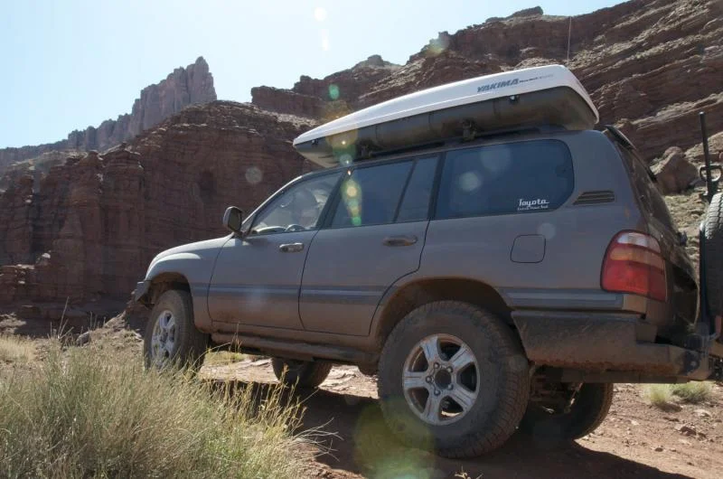

Here are three teasers
Canyonlands
White Rim Trail

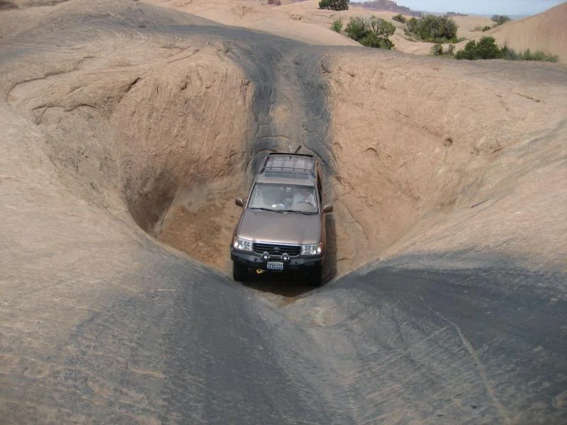

Hells Revenge (hot tub)
WOW! that second pic is some AMAZING scenery!
I cant wait to wheel that area some day.
Did you lock up in the "hot tub", or is traction as good as they say it is?

Keith: I ran most trails with the front locked. 100's are not as balanced as 60/80 (lighter front / heavier rear) so I used my front locker typically when 80's were rear locked.
Traction is very impressive...which allows scaling those crazy angles!
The middle pic is looking south towards Lockhart from the White Rim Trail.
We covered alot of ground...but even at that I'm already trying to figure out how to get back to Utah for more :)
