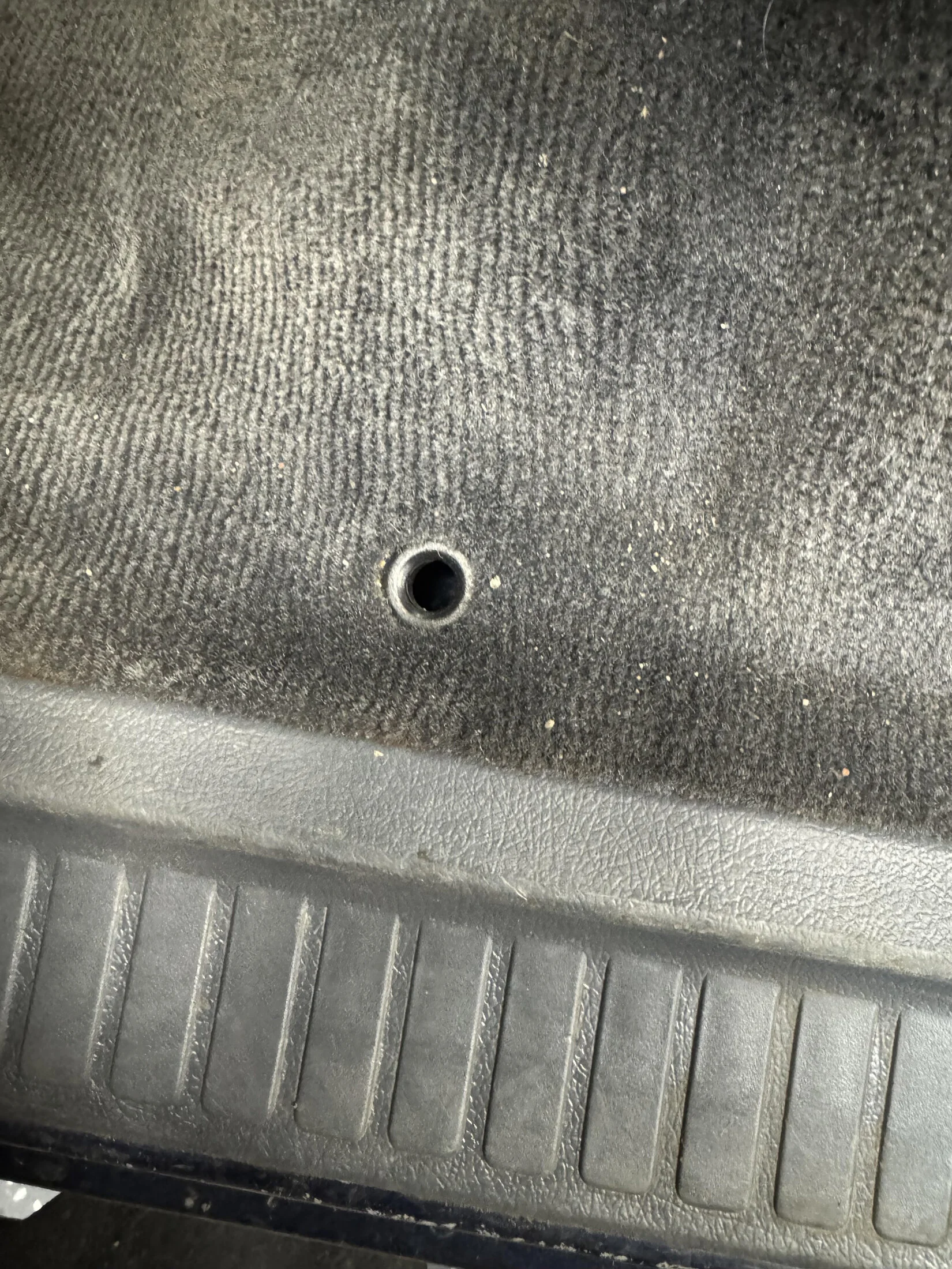

Anyone know what this hole in the driver's side floor carpet is for? Should it have a plug of some kind? I can't seem to find anything in any of the on-line parts diagrams.
Seems an odd place for such a hole, right where there could be plenty of dirt and moisture.

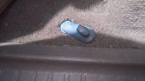

Plastic hook used to hold a factory floor mat in place so the mat doesn't move and press on the accelerator pedal, causing an accident.
Thank you. That makes sense. That occurred to me, but thought otherwise since there’s just the one hole off to one side instead of two holes or one on the center.

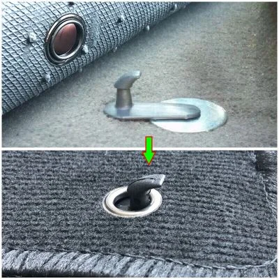

I couldn't find that retainer clip as a separate Toyota part (does it exist?)
but did find aftermarket clips for a Toyota Camry that may fit.

I used a plastic body plug to secure my weather tech mats to the floor. I had to drill a hole in my new mat to match.
It keeps the mat secure and from my big feet hooking on it and pushing it around.
