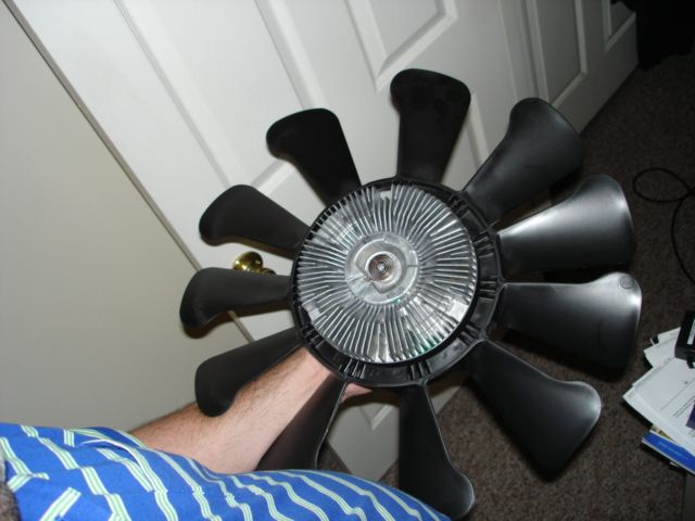

GM Fan clutch fan and clutch
see pics of GM fan clutch and fan from 1999 GM 5.7 (Truck / SUV) I plan to use.

Where'd you get THAT!?
Brand new stuff?
Would that be a universal type fit across the Gen III vortecs?
Pretty cool!
