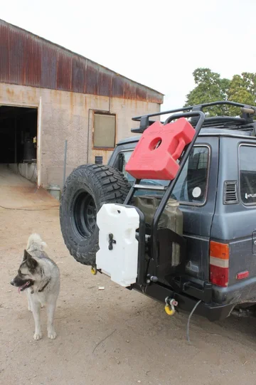

In the last pic it locks at 90 degrees. I guess it might make a table. I haven't really explored the possibilities yet

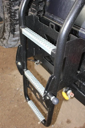

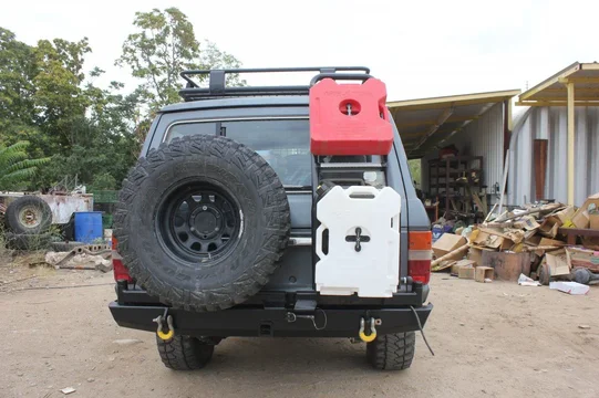

final pics. From here I can now make changes. I can pull it in about 1 1/2" closer to the body. Like always I will get the first gen on mine....I never seem to get the final version. Definitely more an expedition bumper versus a super tight crawler. It suits what I'm needing from this truck

As usual, great work Dave. I like the use of the pop-pins (spring loaded pins). Did you use 3/8" or 1/2" diameter?
J
I used 3/8 on this. I set it up as a double shear so i could use the smaller pin. There's really no load on it fully dropped. The only load fully retracted
is the weight of the arm and maybe a 2 or 3 gallon Rotopax. I can stand on the ladder at the 90 degree position. Doesn't appear to bother it. One thing I did that was a brain fart was to put the pin on the outside. Now it can swing open and the pin can drive into the body if I'm careless. I have a couple variations of stops coming in from McMaster Carr that I'll be checking out
