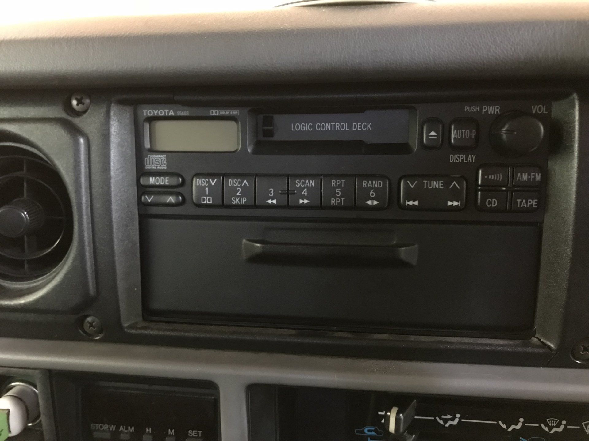

The last time I was overseas I removed the Japanese radio which is limited in FM bandwidth and installed a Pioneer radio with USB and DVD player.
I am thinking to upgrade the speakers and do not want to cut holes in the doors to accommodate 6x9's.
Kenwood makes a performance series 4" 3 way flush mount speaker that fits in the factory location and is reported to sound much better than the factory speakers.

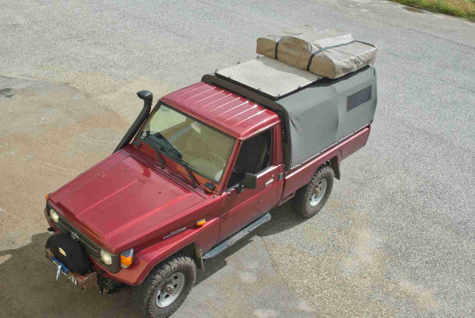

Mahogany Pearl 3N2 and i are not shore think its a bit light for that... can be 3H4 Medium Red Pearl but that is not offered in 1999.. Had to check its 3H4 and its the original paint for this truck... funny that the Land cruiser differs so much depending on witch continent its sold.
I have a 93 PZJ75 pickup with the original Cardinal Red 3H7.
