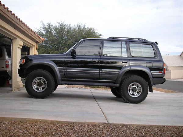

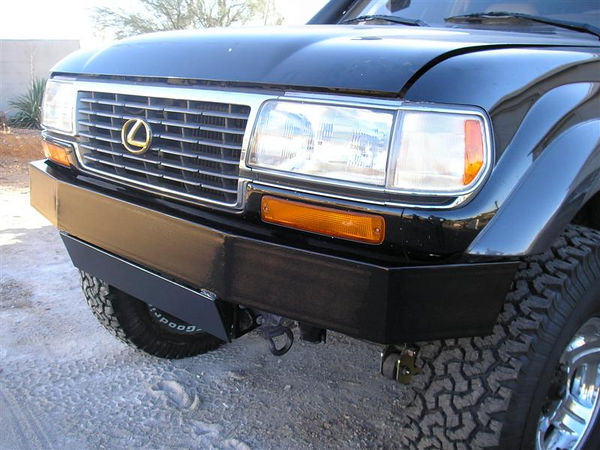

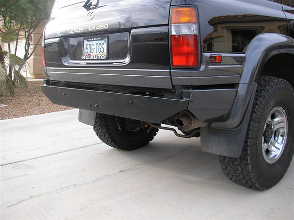

My answers:
1. Yes, diff drop is in the lift. My guy did it himself per Doron's (the designer who supplie dthe info the Slee) instructions. $50.00.
2. He did both bumpers on both my 80's. Frame cutting, steel, fabbing...$500 per set. That's one short 80. Image a 100 setup like this? Pics at the bottom:

My answers:

Shotts very cool looking. Great job.
