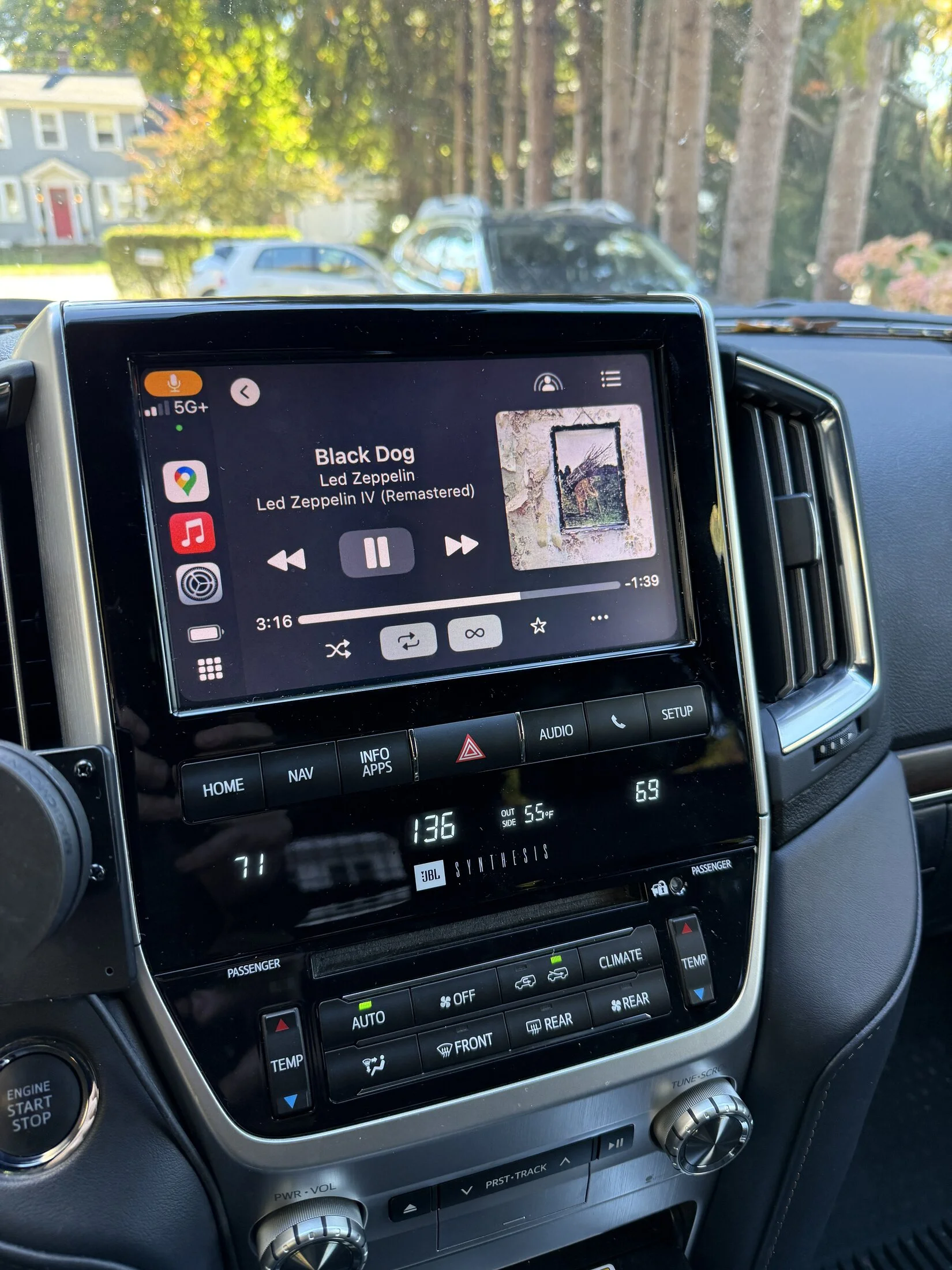

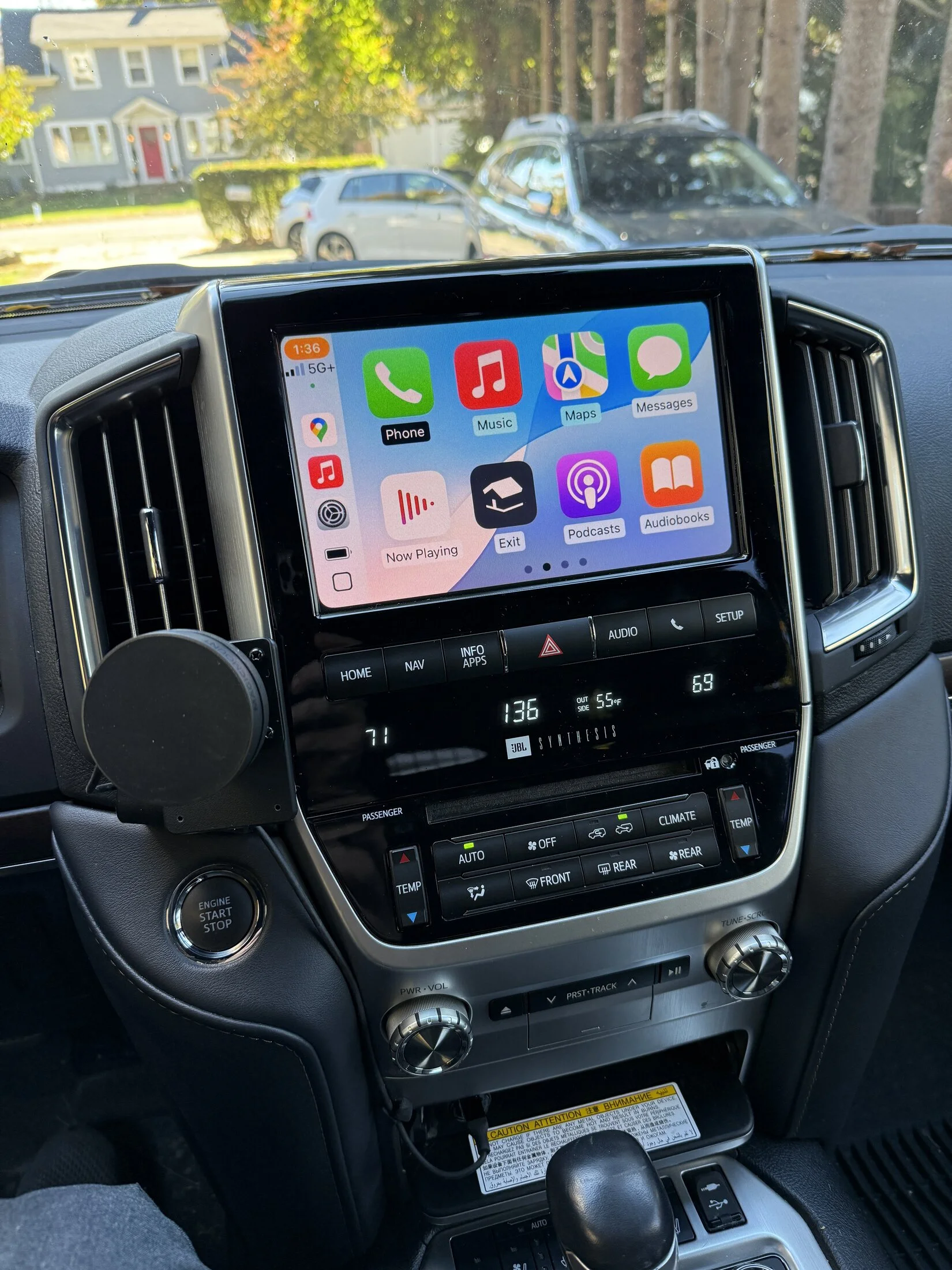

Got it working! I removed the CD player/ audio console and found the right plugs to attach. Crown Focus includes more cables than one needs for a 2020 HE. Seems like there are cables for aftermarket camera systems and maybe audio items like subwoofers that the 2020 system handles thru the stock main cables. I read the dip switch information to surmise that I wasn't going to need them then turned it all on before reattaching everything. They preset the dips for your situation.
A straightforward enough job in the end if I'd known what I was doing in the beginning.
Audio seems just fine- as good as stock if even a little better for the bluetooth audio via CarPlay. I placed the bluetooth/ wifi antenna just below the top speaker grille, but still a couple inches from the speaker.
A long press of the voice command button on the steering wheel swaps back and forth from the Crown Focus unit. It swaps to where you were last in that environment. Audio continues to play as well when you switch to the Toyota Maps or Sound control, etc. When you go to Audio it shows as AUX and you can change the course to FM /satellite just like normal.
Backup works with reverse just like normal.
Early moments, but seems nice and stable. Responsive enough to move back and forth.
I forgot to try climate button.
