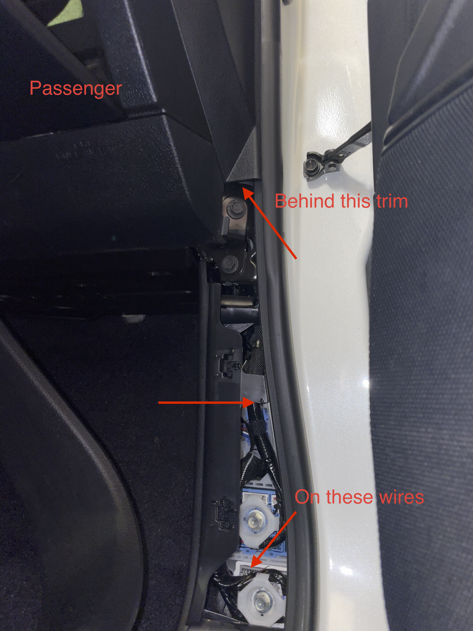

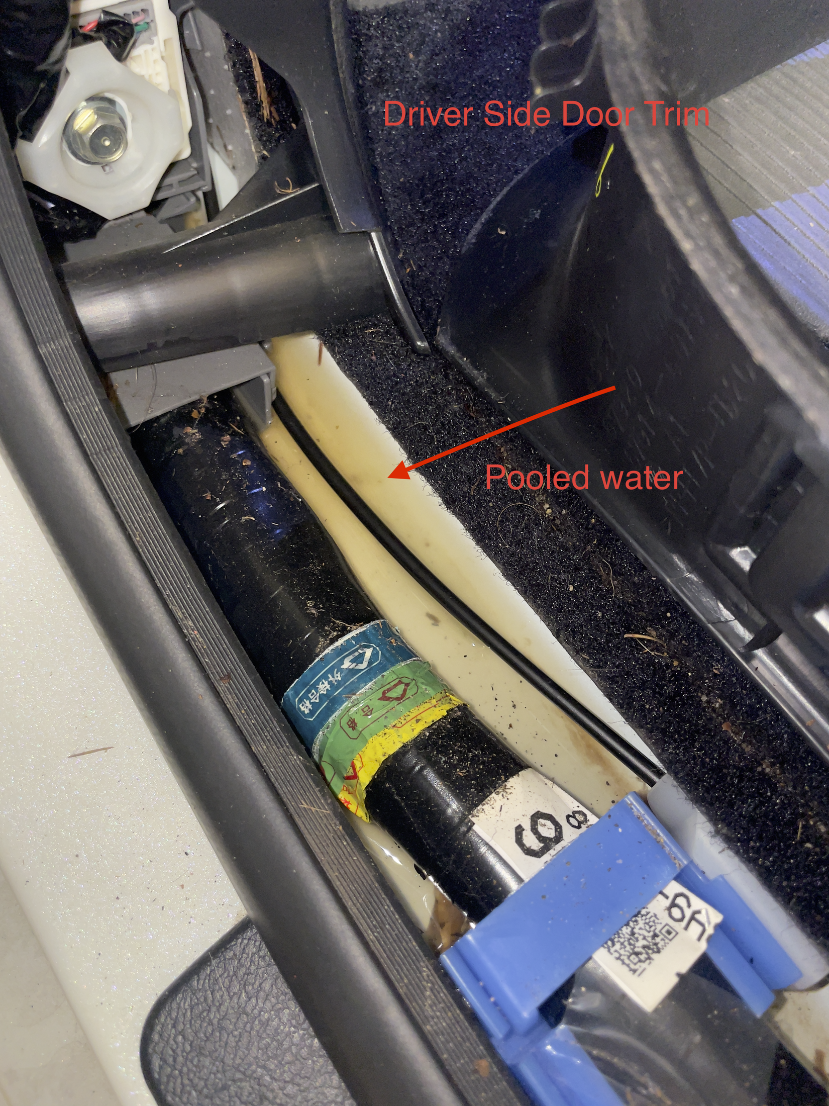

We had back to back days of decent rain and on my way home tonight I started having issues with my driver's heated seat not shutting off no matter what mode the heated/cooled button was on (or even off). Pulled the drivers door trim and noticed a lot of water and both driver's and passenger carpets are pretty wet. The drivers side electrical canal under the trim had water pooled up towards the front of it. The canal on the passenger side didn't seem as bad but I noticed water hire up on the passenger side.
I read the threads on cowl issues but could that also cause water on the driver side that badly? I just purchased the truck from Seattle in April and have had to clean off sap and pine needles off the roof and cowl before so I'll start checking drains tomorrow. Although I didn't feel any wetness around the sunroof and headliner. The windshield seems to be original based on Toyota markings but I can't say for sure.

Water in drivers side probably isn’t the cowl, it’s the sunroof drains. Relatively easy to address that with a cleaning tool on amazon, but yes there is a risk of persistent damage to the connectors that were submerged in the water depending on how long they were like that.

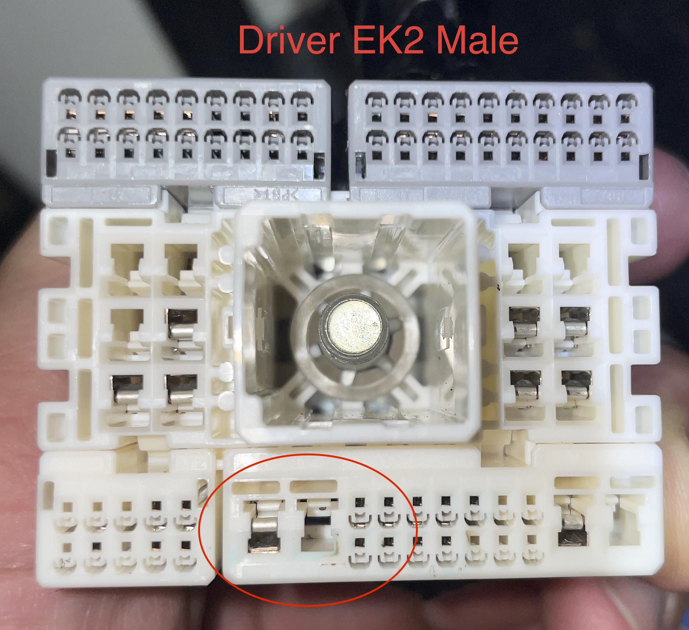

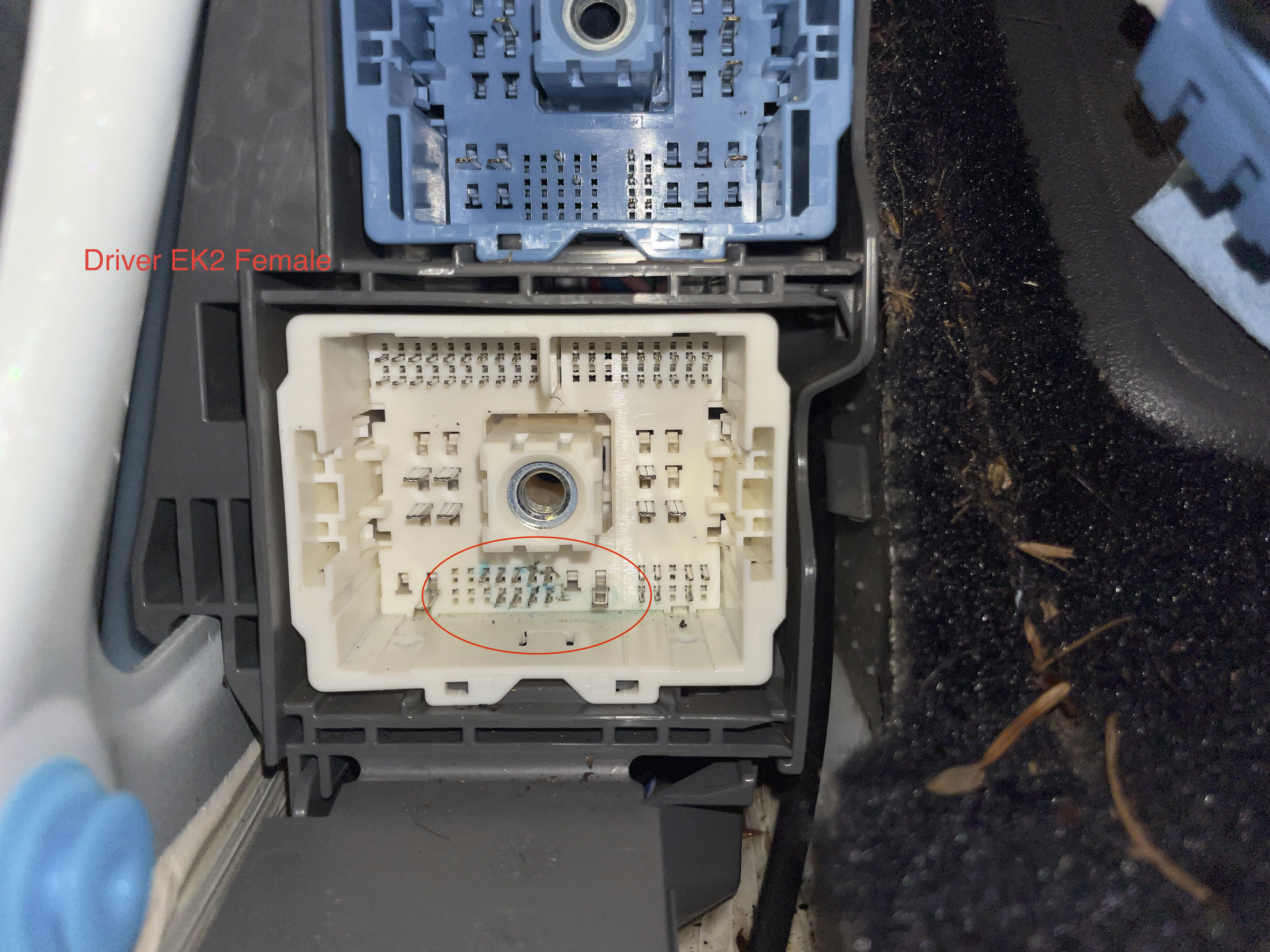

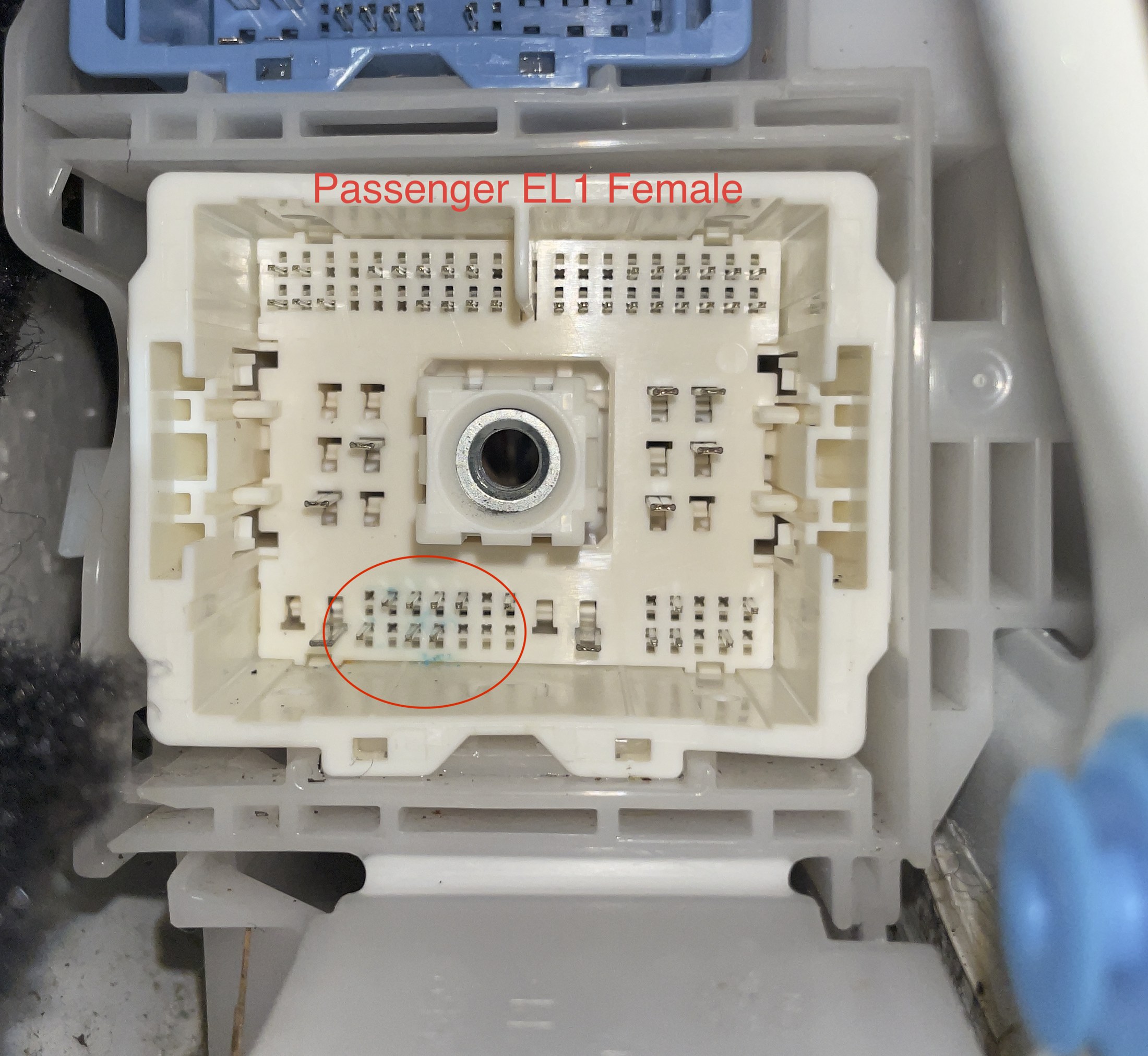

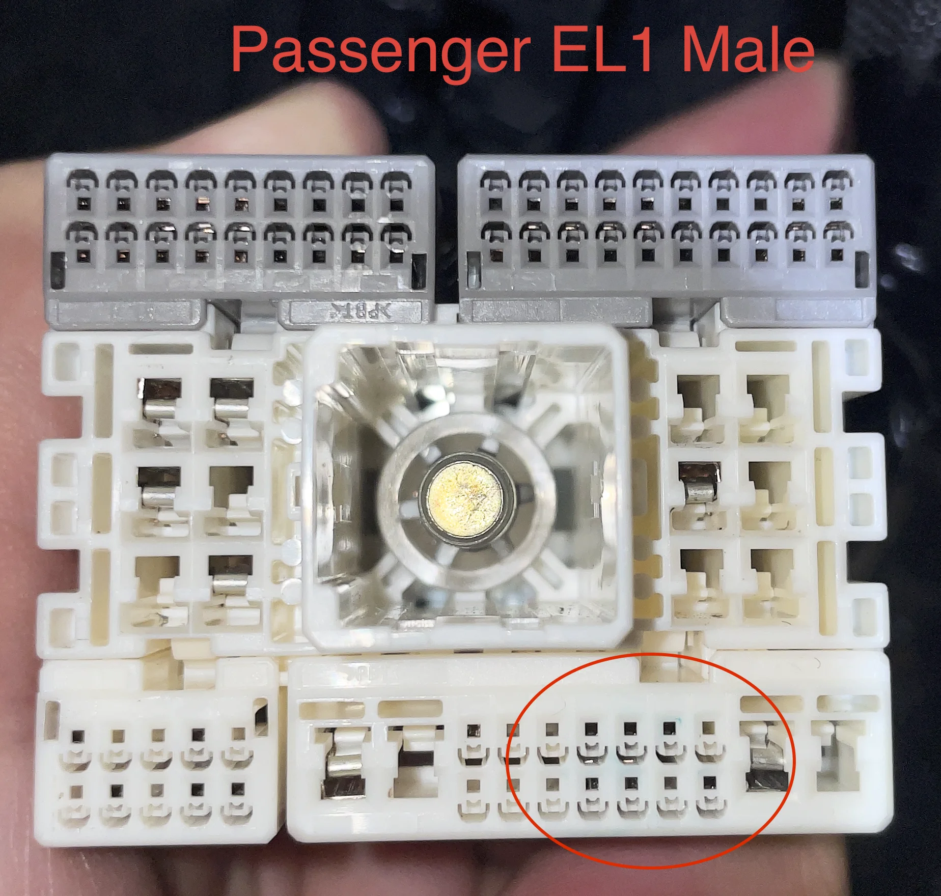

Pulled the connectors and ran a fan overnight. I've unfortunately noticed some very light corrosion on driver and passenger junctions. What's the best method to tackle corrosion these delicate pins? Is the only long term solution to depin and clean the affected ones?
Still narrowing down the source but I believe it is the sunroof drains. I'll check them once the connectors fully dry and I can reconnect the battery but for now I pulled the A-pillars and noticed a little bit of debris and water in those channels.
From where I’m sitting I think you dodged a bullet. Some of these are so bad the pins disintegrate when the connectors are separated. Yours don’t look very bad.
View attachment 3715109View attachment 3715110View attachment 3715111View attachment 3715112
Looking at these pics, I agree you dodged a bullet.
This doesn’t look bad at all.
