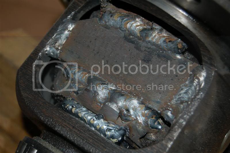

welded diff

Here's the welded 3rd I did for a friend. Before welding in the plate on each side, I welded the pinion corners to eachohter. This will never break.
