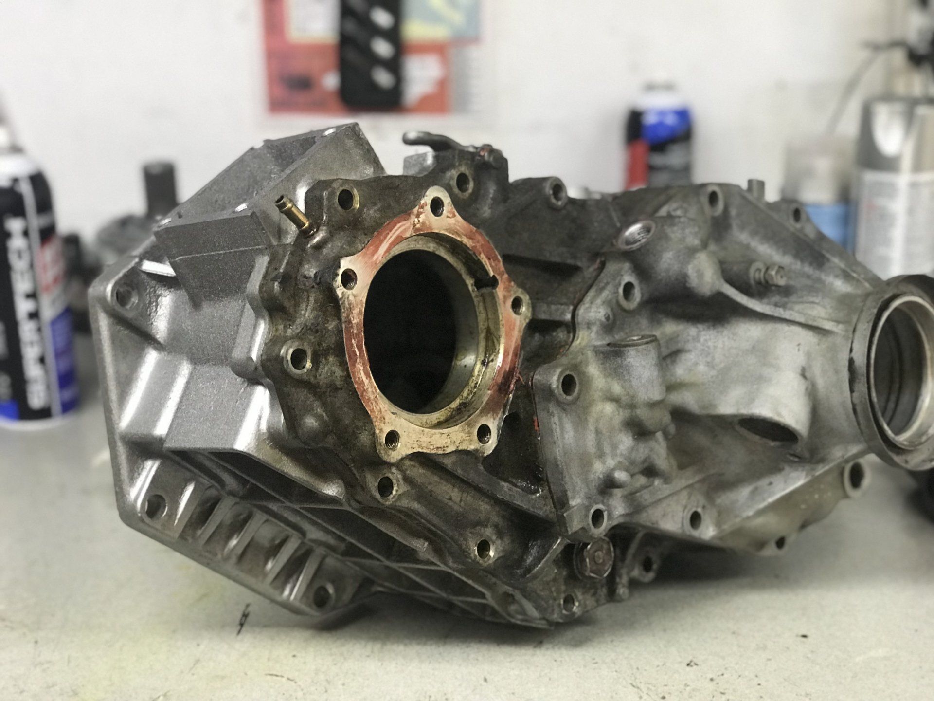

Friday night about 7pm, the weather is beautiful, the kids and wife are occupied and knowing I wouldn't be bothered for the rest of the night, I decide to stay up late and install my part time kit. Everything went well until I was reassembling the rear output of the case. Around 11pm I was applying the gasket sealer, turn to grab something and knocked the rear output off the work bench. Of course I watched it fall in slow motion, hit on the edge by the oil pump and crack. It's late and I felt defeated.

Saturday morning I give @AJR a call to see if he has a case with the output I need. He replies a few hours later that he has one. Turns out the Early 80 series with out a viscous coupler are the same as the 100 series. The only difference we could spot is the speedo gear.
Sunday I reinstalled everything. Funny to think this output came from behind a 3FE. I'm excited to drive it in 2wd and see how it handles now.

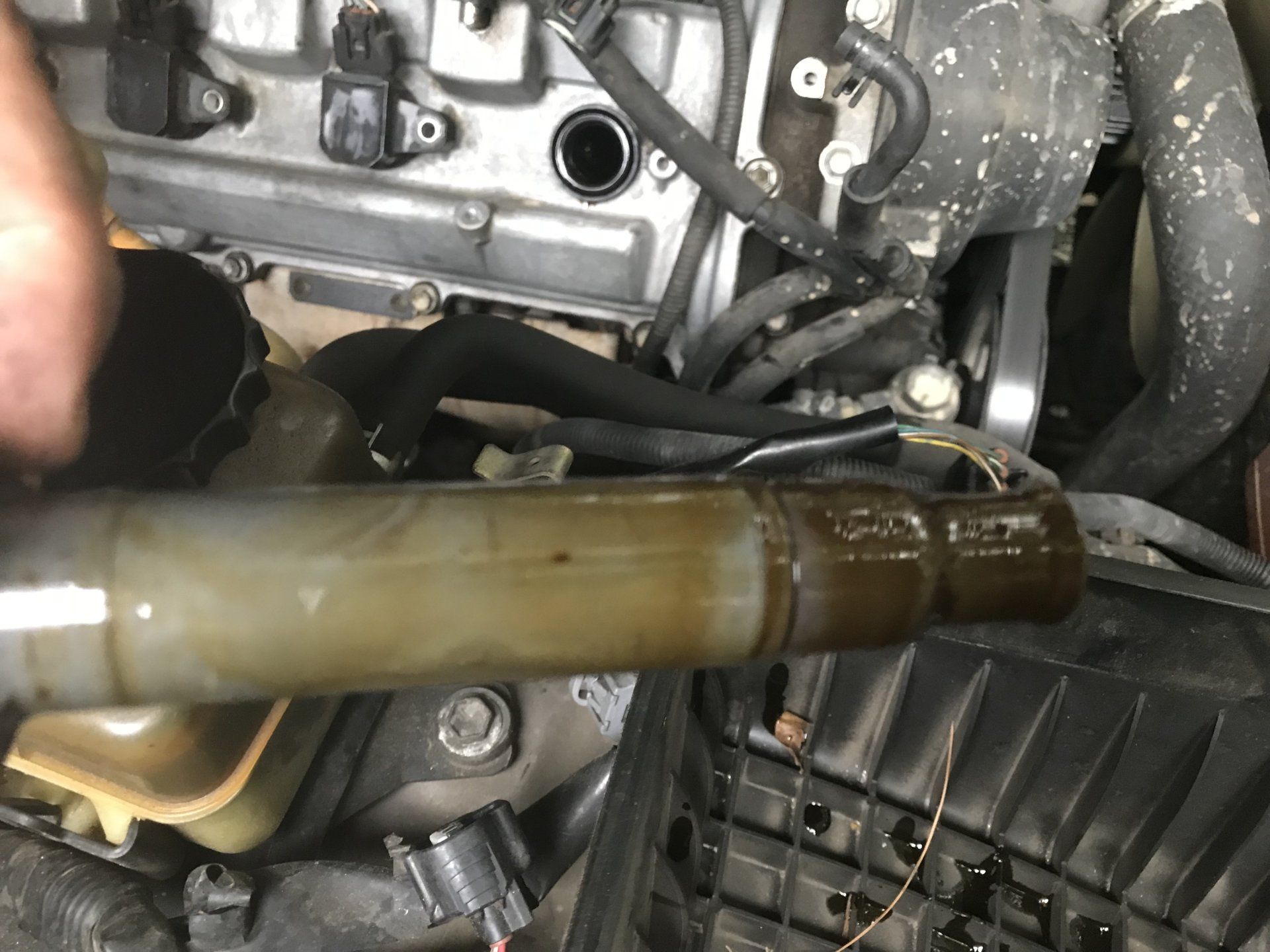

On the passenger side the coil and the plugs on 2,4,6 and 8 were covered in oil. The spark plugs gasket on each cylinder had failed.
8 OEM coils and iridium NGK plugs should be here sometime today. I actually had the spark plug gaskets waiting to be installed.
Time for some valve gaskets. Oil in the plug bores could cause a misfire by itself.
yea, As much oil that was present on the passenger side Im not sure how it was running at all. I had the spark plug gaskets sitting on the shelf in waiting. I went ahead and installed them yesterday.

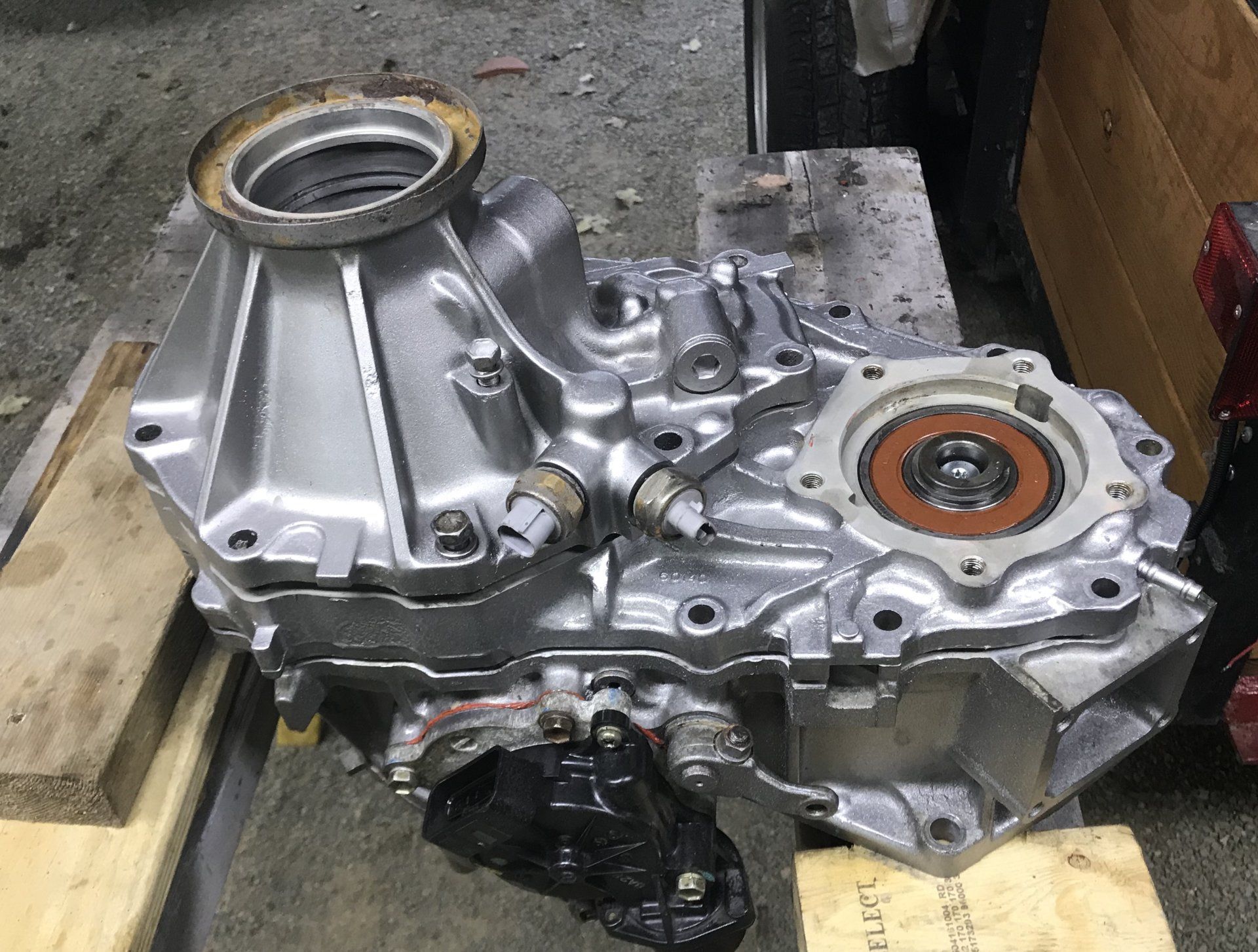

Time for an update...Part-time completed.
Installed AVM Hubs. I wanted to use AISIN but had to use AVM because AISIN doesn't make a part-time HUB that works with US 100 axle shafts. Found these hubs sitting on a shelf in a Land Cruiser shop in Greece. Stateside shops that are AVM dealers told me it would be about 5 weeks to receive a shipment from down under. My patience isn't rated at 5 weeks so Google help me track down a shop that had them.

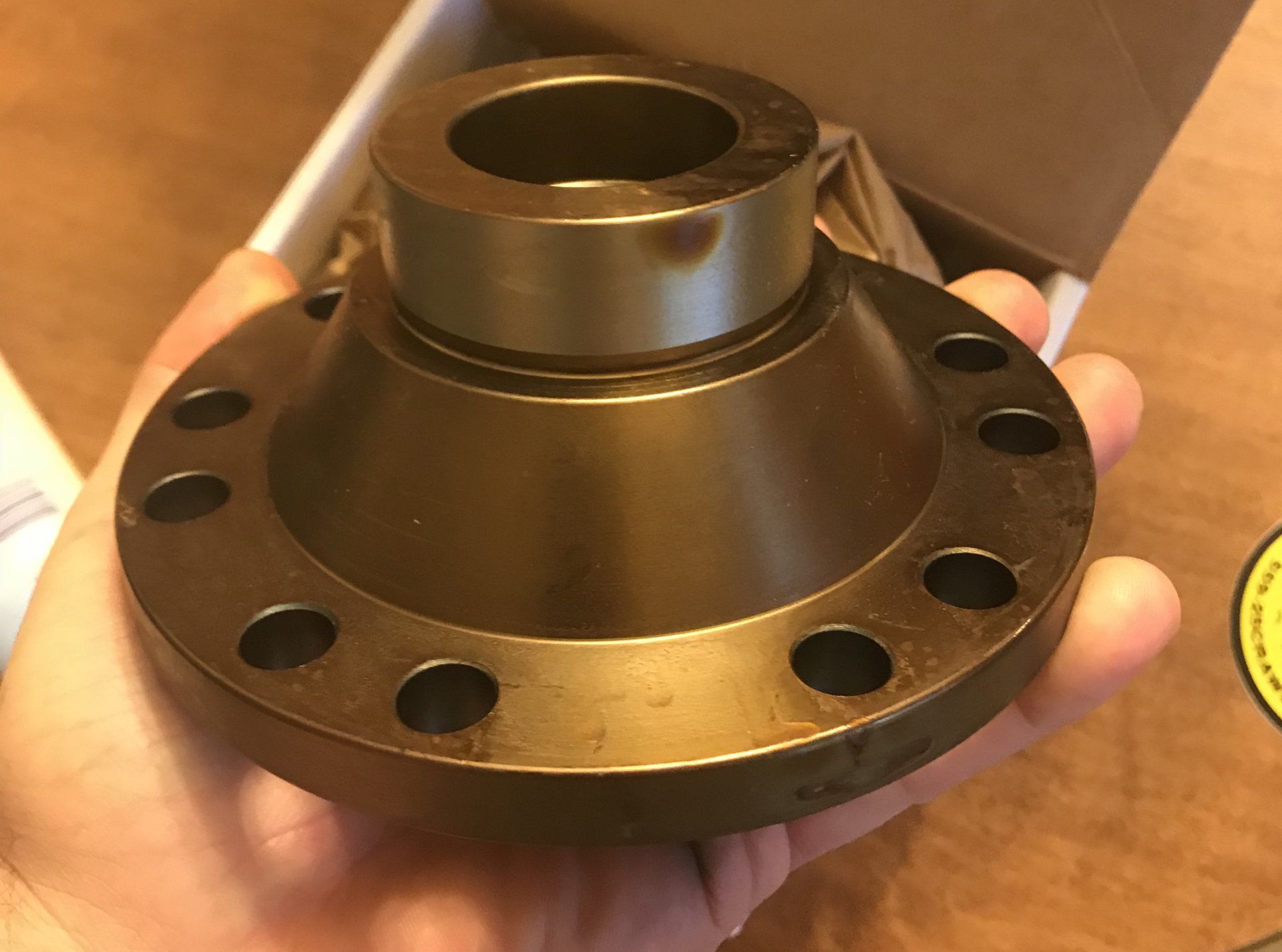

Marlin differential spool

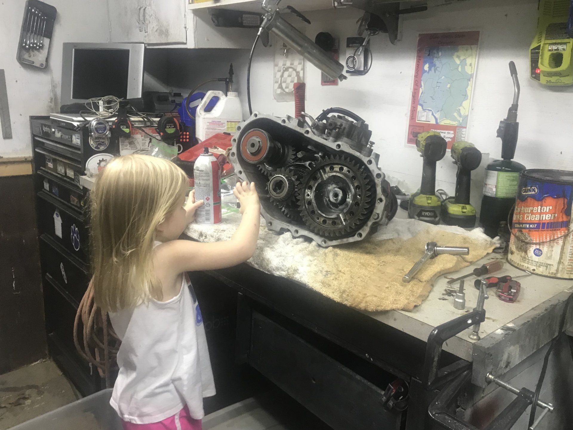

Since I had the HF2A apart for the spool I went over the top and completely disassembled it. I had my special helper...and they say good help is hard to find.

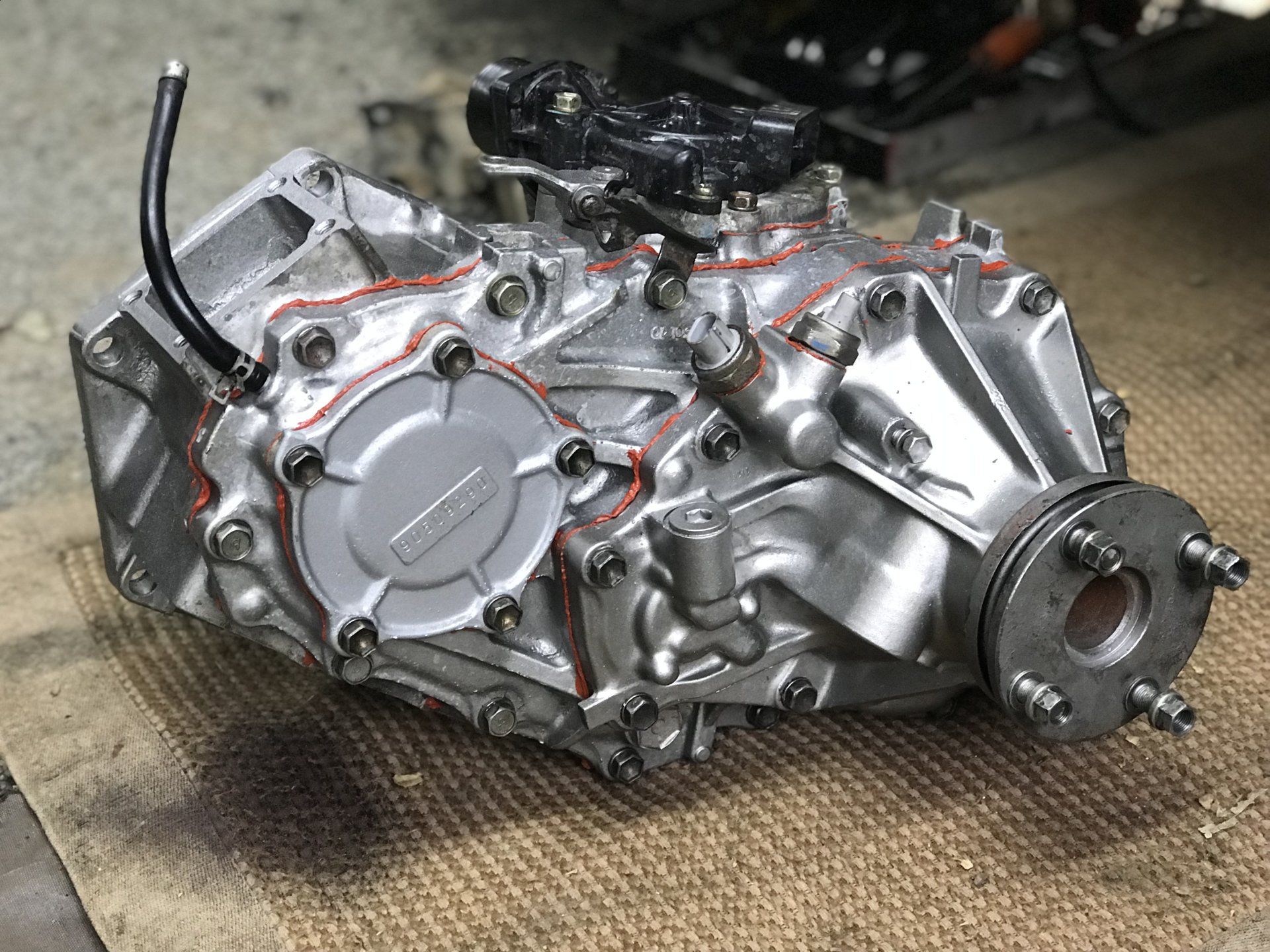

Sandblasted, Replaced the output bearings and seals in the front and back, paint and cleat coat.
3 Sections in 3 different stages while I was working on it.
Installed a new transmission seal while it was accessible.
Just after I had my Wheaties and before I lifted it in solo.
Aaaaand.... of course I had to finished it off with new ujoints and a rebalance.

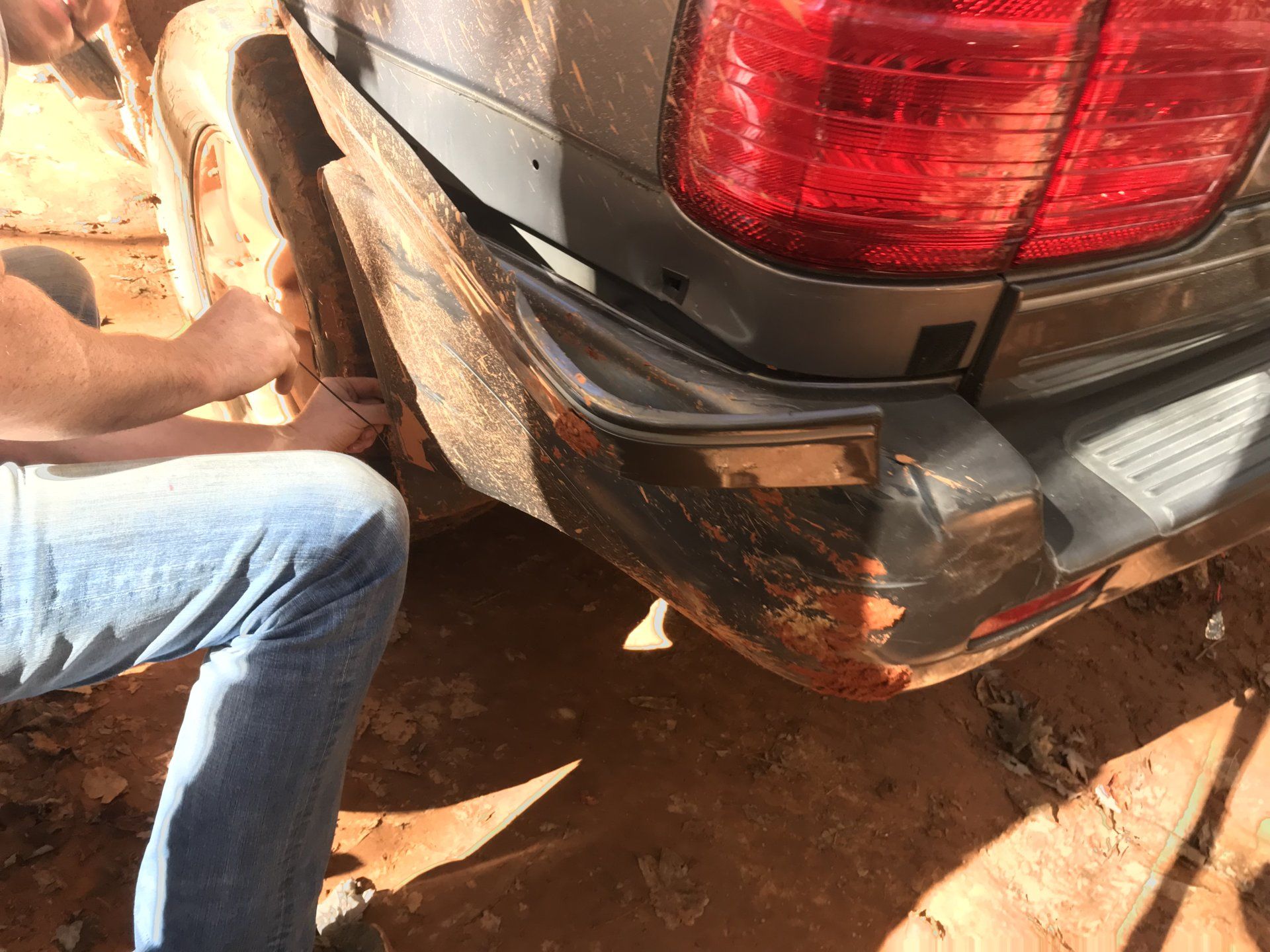

I also witnessed the fastest break and zip tie fixed rear bumper ever. It’s almost as though it never happened. :)
This morning I plowed through a deer. The ARB saved my truck. ZERO damage. I tried to convince Brit they can come at you from behind too. She didn’t buy it. The zip fix will have to last for a little bit.
