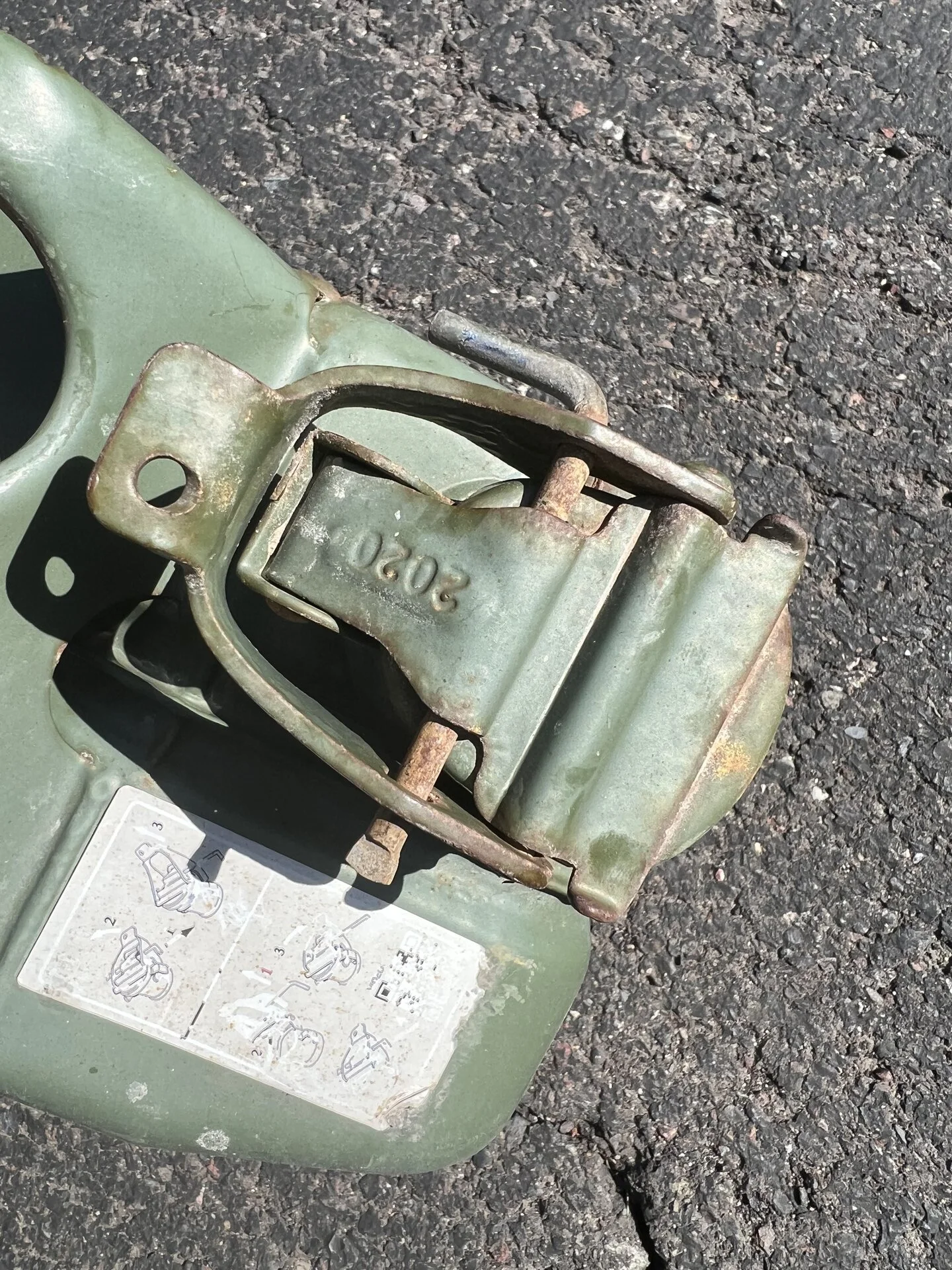

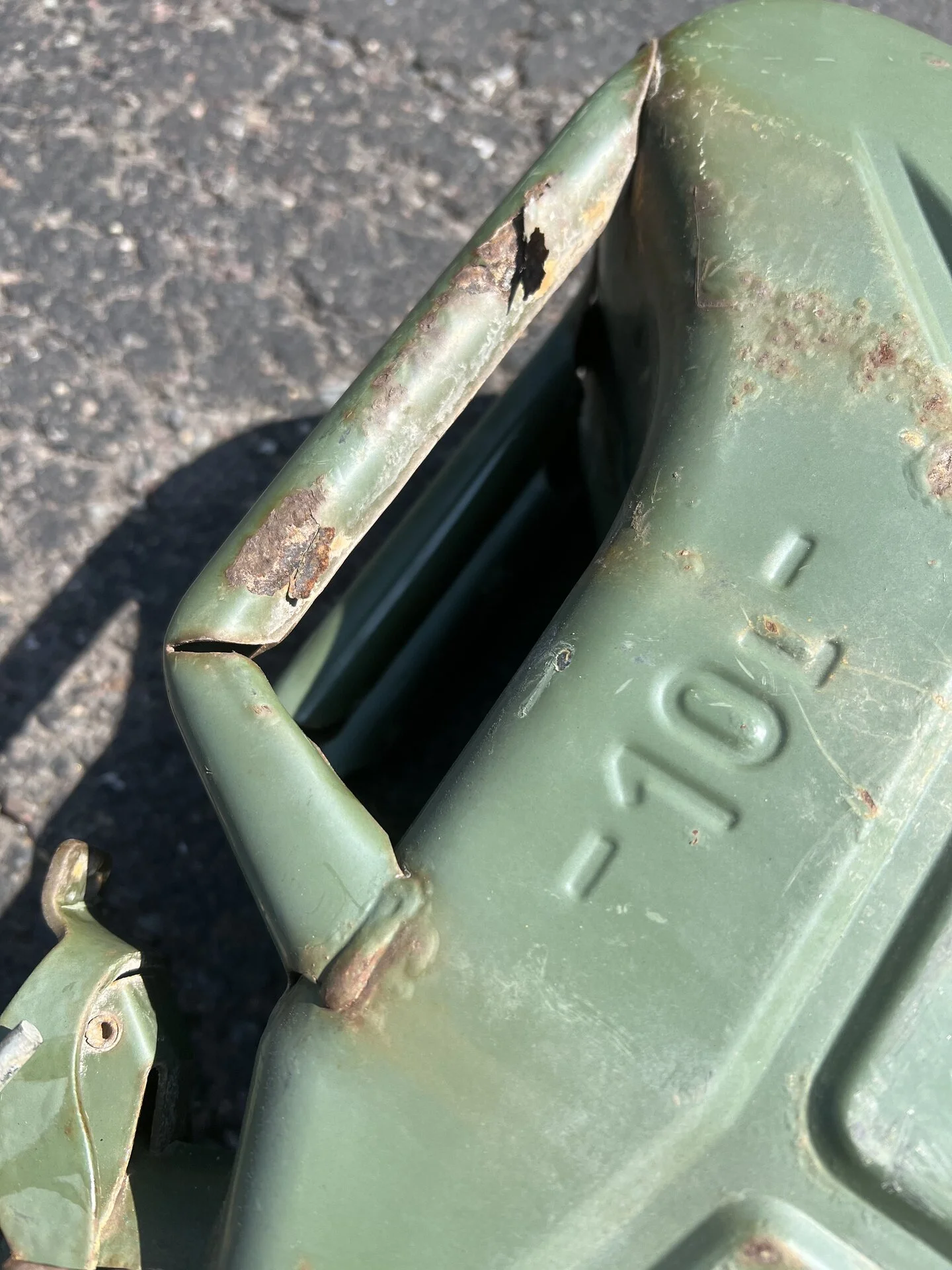

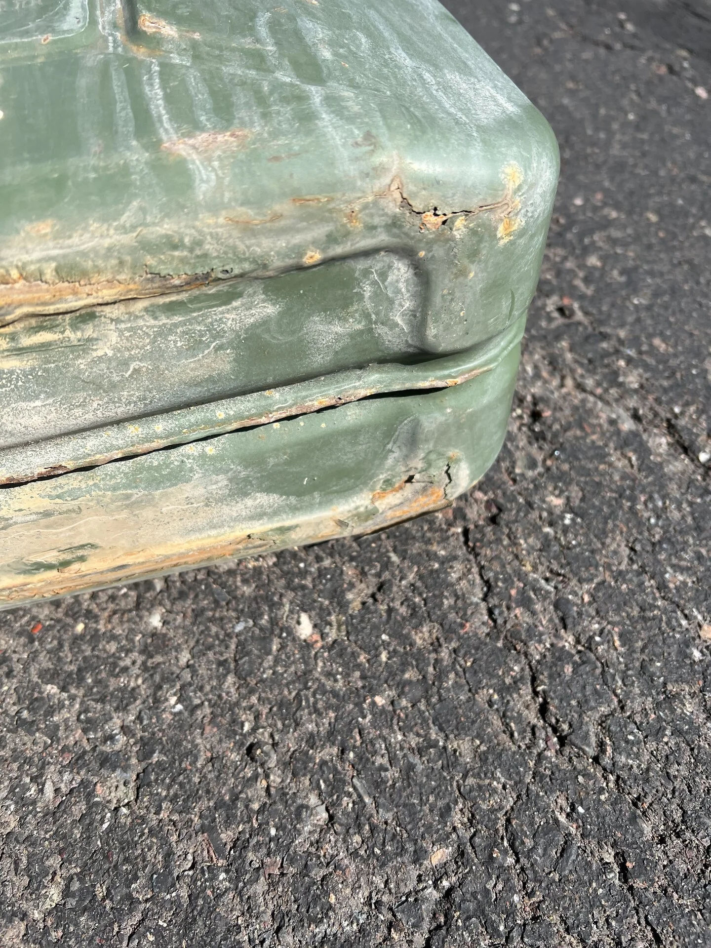

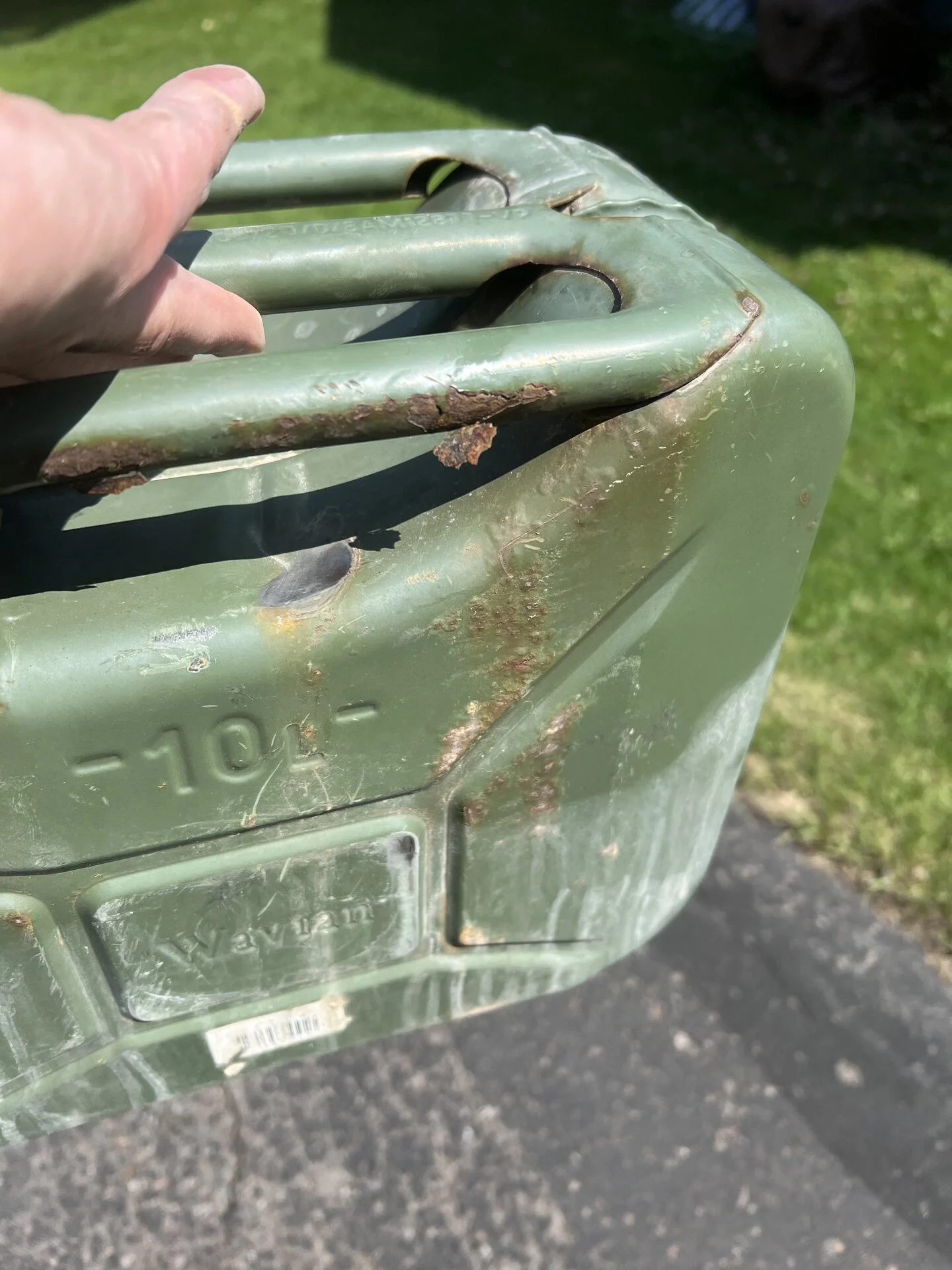

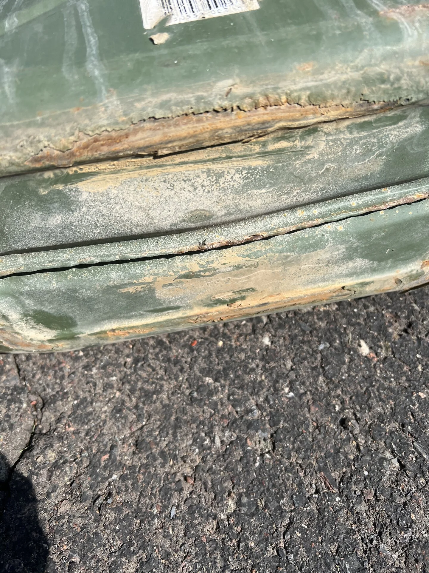

Anyone had this kind of rust in just a year and a half?

I don’t think they’re rusting on the inside, but as you can see from one of the photos, it’s to the point that the rust has exposed multiple layers of metal. So it’s inevitable that it will rust through.
Interestingly, Wavian told me the cans were not designed for “coastal environments.” I live in MInnesota. 🙄
They did offer me 20% off a new can. But I’m done with them. I ordered a couple of Scepter cans.

But I don't think those cans are compromised if it's just the outside. Looks like just surface rust under a bad paint job. If you don't mind spending the time, it would be easy and cheap to fix. I have 60 yrs old NATO cans that had some minor rust like that, repainted them and they have been outside for years now with no visible ill effect.

Could they have gotten road salt on them?

Yes, it could be road salt. That’s a good point. It destroys everything else it touches up here. But I’ve never seen it happen so fast.

If they are not kept full they like to start to Rust at Seam on inside. The Works Toilet bowl Cleaner ($.99 at Dollar Store) along with a Handful of 1/2" Nuts and Lots of Shaking cleans the Insides up Nicely then Clean Fully and Heat (set in sun, Hair Dryer, Heat gun, etc) then a coating of POR15 Tank Sealer.
