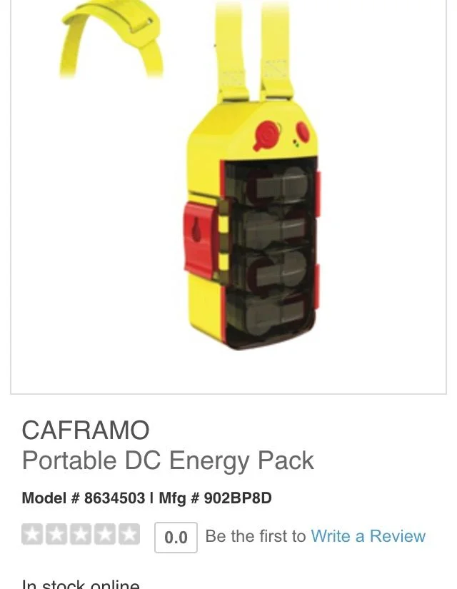

Battery boxes also need to have a vent since you could have gases build up. My box (made in China) is a heavy aluminum that has weatherstripping on the lid, grommets for the wires and a vent. I would say it is water resistant but not by any means waterproof. I also insulated it so there would be no electrolysis.
CAFRAMO Portable DC Energy Pack | West Marine
D cells are kinda puny and the bulk of them and the holder is going to be close to a standard sealed rechargeable. ntsqd's suggestion of a motorcycle battery is a good one. They come in all sizes from tiny to huge, so if the form factor is part of your equation, you can likely find one to fit. I'm partial to Interstate, but there are others. Here's a link to their deep cycle ones, but they also have them in standard config in a greater range of sizes: Sealed 12v Deep Cycle Battery from Interstate Battery System of America, Inc
