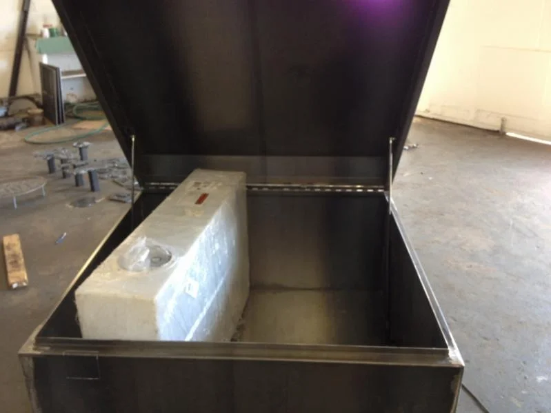

On the water issue I was just given a water tank that is 8x16x48 black PVC. I want to mount it on the 8" edge. Is there really anything needed other than a couple of straps if it is on a flat floor? It really seems weak to me in that the sides seem thin and looked warped? At 26.5 gallons and 225 lbs I'm a bit concerned but would really be thinking hard if I had to hang it from under the rig. Any suggestions on a better way of mounting? Or is just keeping it in place enough?

Normally PE is the choice for potable water holding tanks. Not sure exactly why, could be taste reasons, could be biologic growth reasons. Suggest research before use.

If I remember it is 12 x 12 x15 to the top of the pump. There is no better tank for the money in my opinion. It is way overbuilt to withstand a ton of abuse!
Dwitko
The ERO tank looks very well made. On the issue of potability I see no mention in the website. Very careful in wording to say washing or showering, never a mention of potability.
I'm am not saying they aren't just wondering why? It may be a liability issue much like bumpers with hitches that make no claims for towing application.
Do you intend to use it for drinking water?
If so is the sanitization process as simple as running a concentrated bleach solution through, then rinse and fill?
Yes I know Tom the owner and the issue is legal. Iinternational standard certification blah blah. I will be using it for drinking cooking showering etc without any issue. I believe it would cost upwards of 15-20k to get some right to use the stamp on tank saying it is for potable water. Very easy to clean becsuse of the easy access wide lid! Yes I would use maybe 3 drops of bleach fill it let it sit then rinse.
