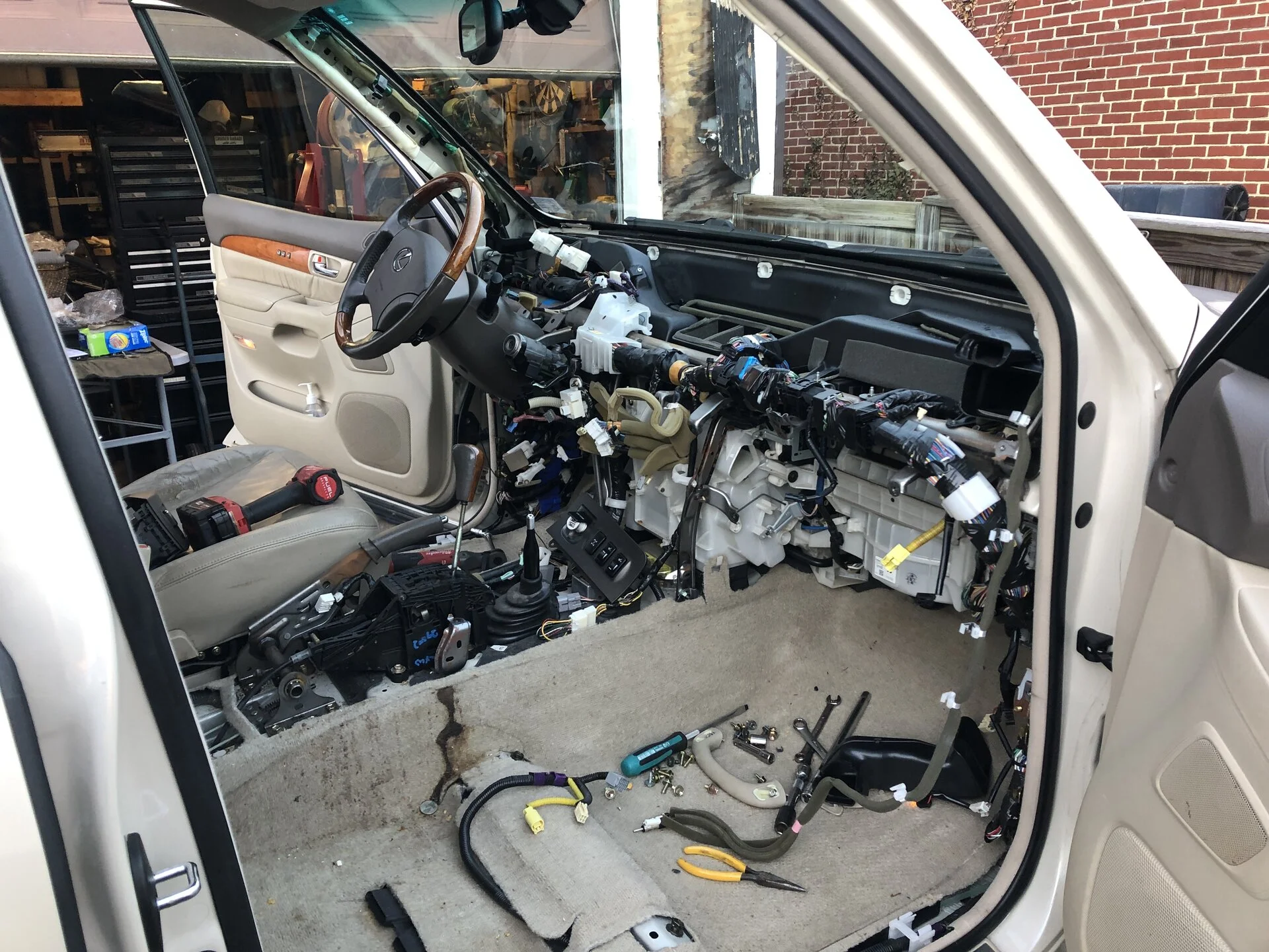

Did you do all servos (4 I think?) or just a few of them? I'm doing a dash replacement soon and am getting some noise/clicking from what appears to be the mode servo at startup. Debating on just replacing that one or biting the bullet and doing all of them.
All of them. Be a shame to put it all back together and then need to replace one a few months later.
