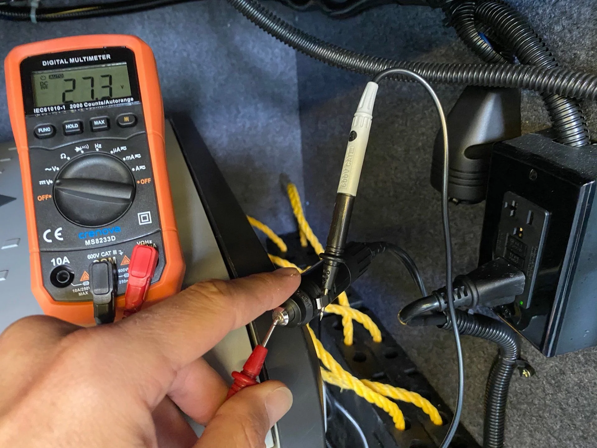

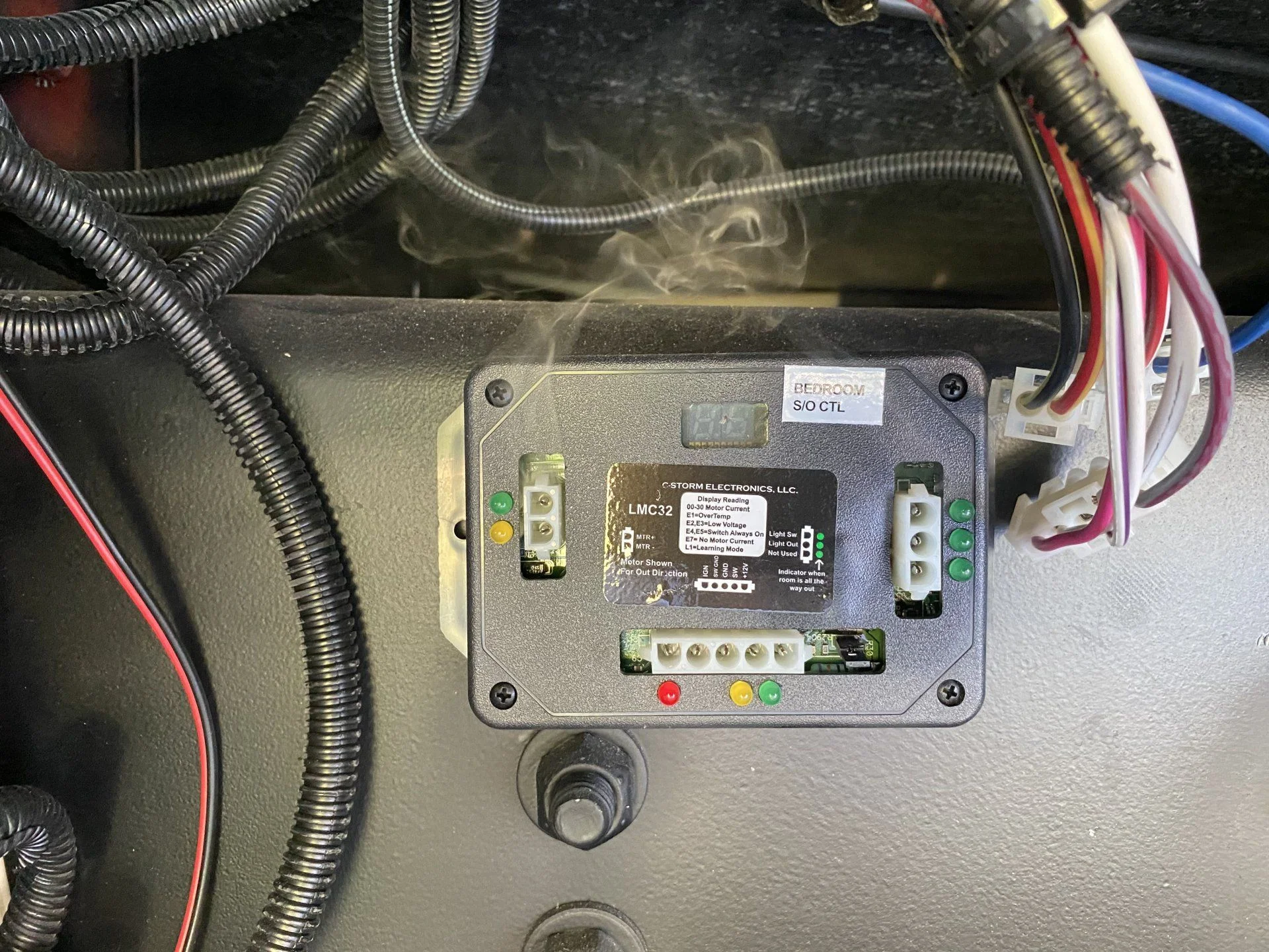

Just a warning: if you have a dometic CFX3 cooler or are thinking about one, be very cautious and test it. We had one installed in our motorhome and it about burned the coach down. It is a dual power cooler meaning it’ll run in 120v and 12v via two separate plugs. Apparently there is a flaw in the power transfer switch and my cooler was sending nearly 48v back through the 12v plug and through my 12v system in the coach. I’m waiting on Dometic to send me a check for the damages that are now over $8k.
The unit I have is CFX3-75DZ (dual-zone).

Could you please explain how did this happen? How could a cooler send 48v back to the vehicles 12v system? Are they plug in together? My friend got the same cooler reason I'm asking I'm also considering getting one. Did Dometic admit to being at fault?
The dometic said their engineers discovered the issue shortly after I reported mine almost burned the coach down. Apparently there is a power transfer switch that is faulty causing the circuitry to take the 120v and transfer power BACK through the 12v plug. Wild. Had I not known what to look for when I did, it would have been a total loss.
They have admitted fault and said they’d be taking care of all my repairs. Had to replace all 8 house batteries, slide out controller, slide out motor, 4 MCD power shades, a DVD player, and a rear AC unit. I’m super lucky things weren’t worse especially after I had everything fixed!! It was just by chance a small truck shop in Sparta TN checked the 12v bus bar and was getting 27.3 volts back through it.

That’s what they’ve said. No official word or ruling but it hasn’t put a damper on our summer travels. Just minor first world rich people inconveniences. Everything’s pretty much repaired except for a few small items. It appears that I can either return it or affix a sticker on the side of it and only use one plug at a time.... doesn’t really make sense but I’ll opt to return it for another cooler/model/brand.
