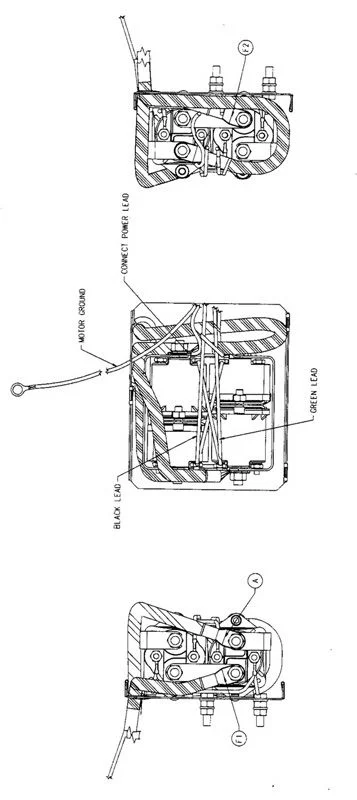

Warn winch runs when solenoids have power.WTH?
Sep 2, 2005
88
2,279
Eugene, OR
Website
www.wagongear.com
New Warn9.5xp
Had to go and be difficult and move the control box up under the hood.
I labeled everything real carefully (I thought I did anyway)
As soon as the power cable to the solenoid box gets power, the winch starts to turn with no remote hooked up.
What did I mess up?
I did this late last night and have not had time to trouble shoot yet but I dont even know what I should check.
The only thing that I think I could have done is reverse the field (F1,F2) wires. I thought that would only make it run backwards though, not all the time.
All sorted out. Called Warn, they emailed me a PDF that showed my stupid mistake, cable on the wrong post.
Thank goodness I didn't let the smoke out. :doh:
For anyone else in the future:
