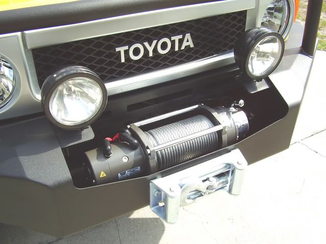

Ordered the Warn winch bumper and M8000 from gowarn.com and installed it last weekend.
Heavy sucker, and thank heavens for the 886 (heavy) OME front suspension to support it.

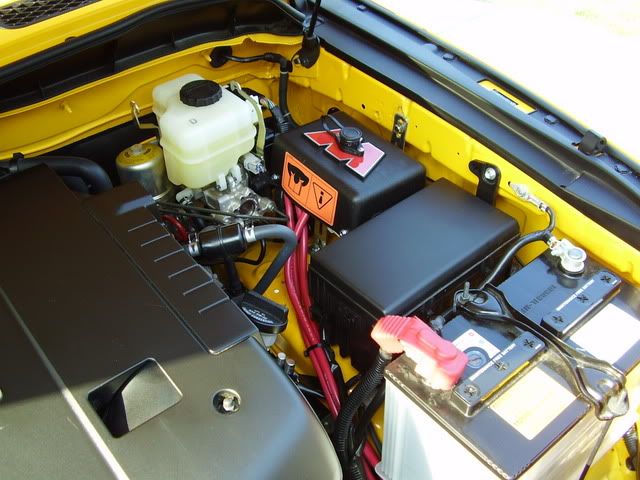

I installed the winch solenoid box under the hood behind the the main fuse box.
Good job and great idea on the solenoid. I like the looks of the WARN bumper.... Was wondering about the skid plate? It does come with one I am assuming? I noted that the replacement skid that came with the ARB looks rather cheap and flimsy. If no skid plate is installed I noticed on one guys vehicle with a OME lift, that the radiator is exposed....
:popcorn:
Thanks, LC4Life.
The Warn bumper adapts perfectly to the existing FJC's skid plate. Warn did their homework on the underside design so it looks like the bottom of the bumper and the factory skid plate all flow together as one.
Yeah that solenoid placement looks great. It's another thing I really like about this new Cruiser - plenty of under hood space to put more junk, just like the old 40. I plan on putting a dual battery set up in mine and ARB compressor for dual ARB air lockers over on the left side. Plenty of room :D
