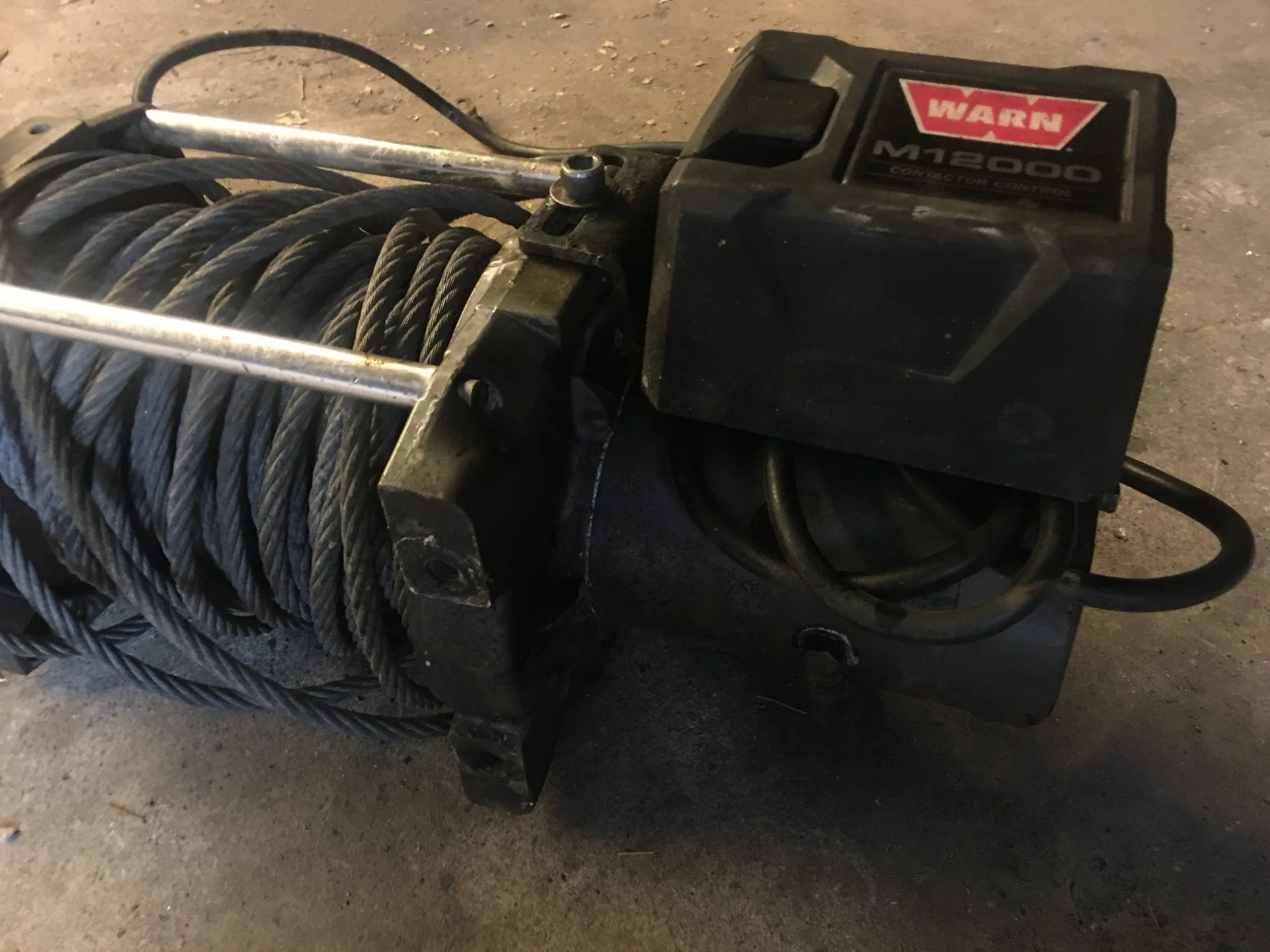

Hey all, I picked up a Warn m12000 12v for pretty cheap. I tested it and it works as expected.
Unfortunately the sn # is rusted off so I am unsure of the exact model. I reached out to warn support for assitance. Once I know what I have I will order new gaskets.
I looked through the different diagrams and the only other identifiable parts is the remote switch(joystick) and it doesnt have steel balls.
I took everything apart and the gears look good with no signs of rust. The drum assembly and support has some rust. The motor can be cleaned too, but I will just purchase the 9.5xp motor.
The plan is to clean, coat, grease, assemble..
External Coating - Would ceramic coating be an option? I'm wondering if it would help with heat? If not I would probably just coat with rustoleum. I dont want to powder coat.
Internal Coating - Is there anything that can be applied for longevity/anti rust?
Grease - Warn recommends aershell 33ms. What other options do I have with the same quality?
Any tips/insight would be greatly appreciated.

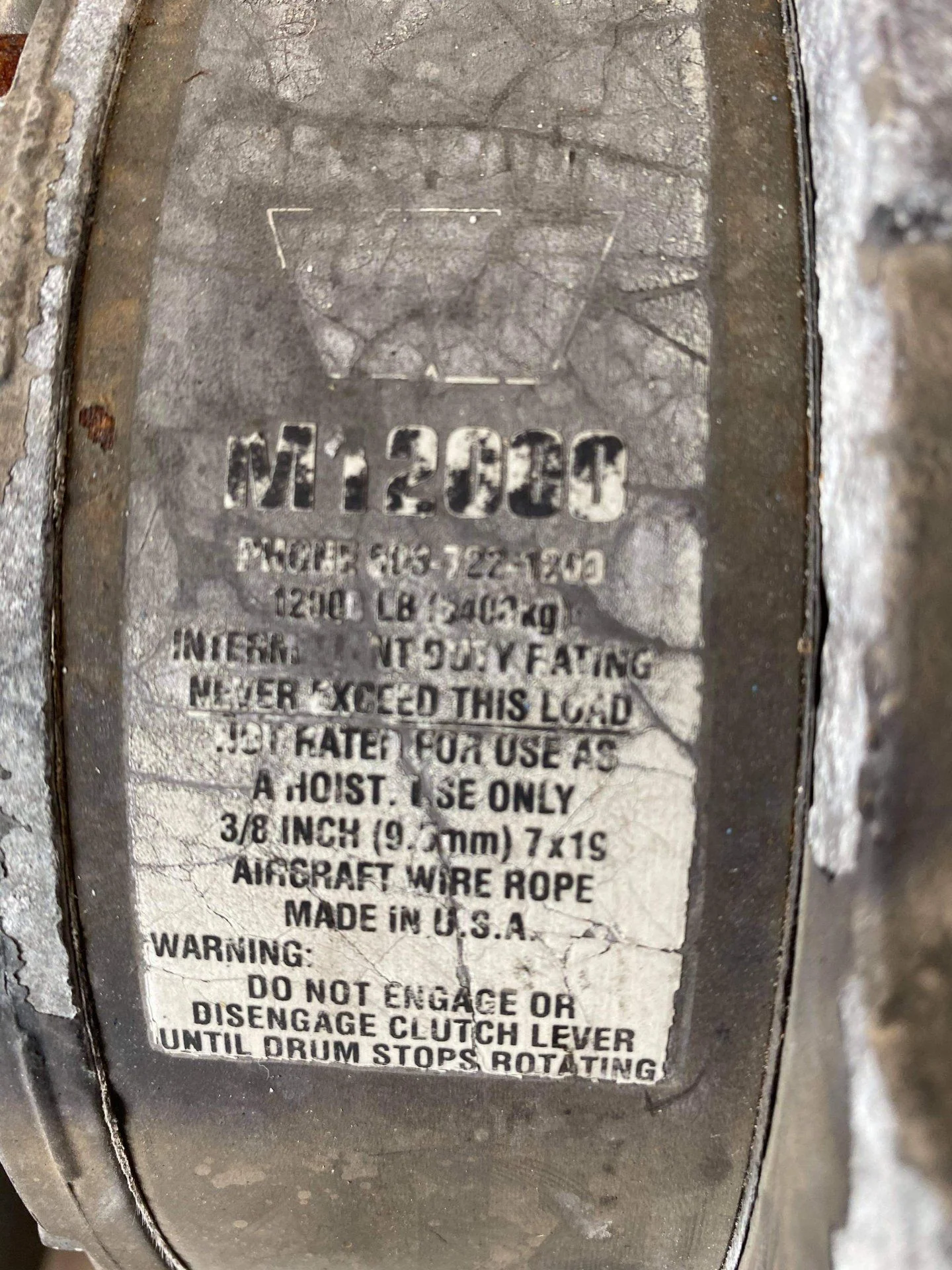

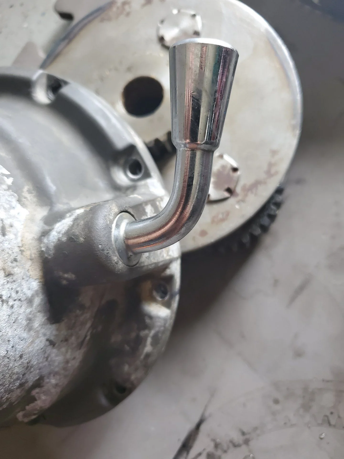

So - as a owner & mucho fanboy of the M12K - is there anything left od the sticker that surrounds the SN# / stamped matrix they do, or can you show the freespool lever - case end complete?
That sticker changed plenty over the yrs.
-I did 1 rebuild on a ancient M12K (earliest model, sold) - & 2 on the one M12K I own now - Warn was real helpful with gen units based on case pics & solenoid covers (helps too) - I never even had to send pics of the guts of the solenoid.

Hey,
Here's the lever and what's left of the sticker..

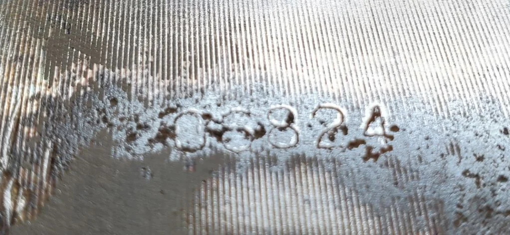

So I THINK I found the model. With more sanding I can see the an better. I am assuming the first digit is 8. It looks like 806824.

If the clutch handle as part of the gen identity holds true, we both have late roughly 1990-1995 era M12K’s.
At least I was told mine was a early 1990’s -ish since my SN was about rusted off like yours, but mine was also dot-matrix numbers rather than stamped ones like yours, so IDK/ grain of salt.

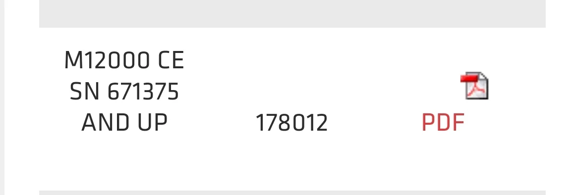

Thanks all.
I'll be calling support this week to confirm my model number and order gaskets. I have some Grey grease NLGI 2 left over from doing my drive shaft. I believe this should work too.

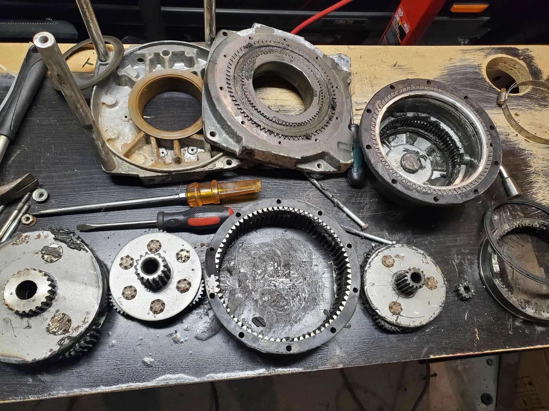

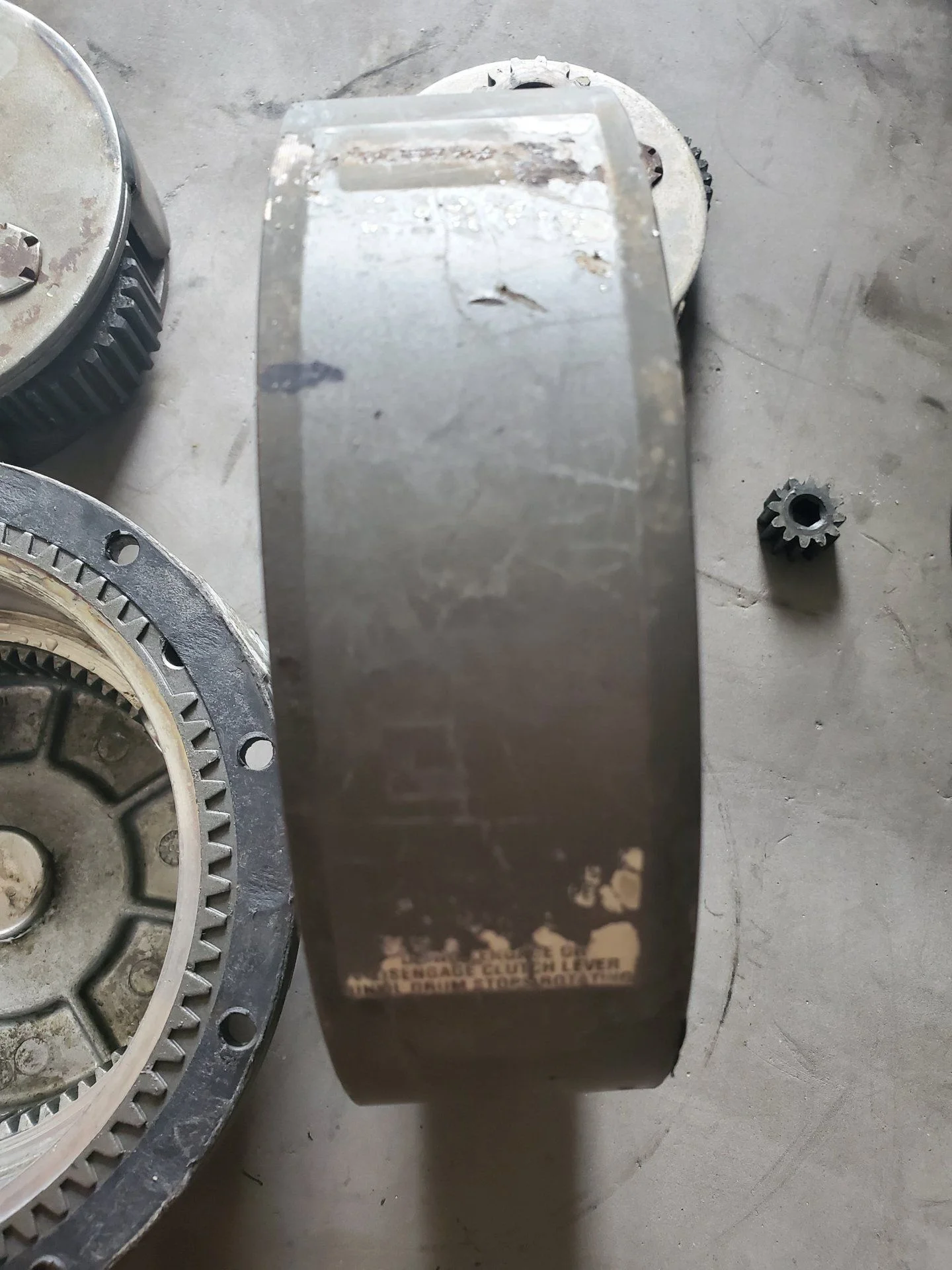

I cleaned, sanded and painted the winch components. It looks good from far away :D I am just waiting on the clear coat to be delivered.
Looks like I missed a spot, oops.
NGLI 2 is way thicker than Aeroshell. If you insist on using it, use it sparingly.

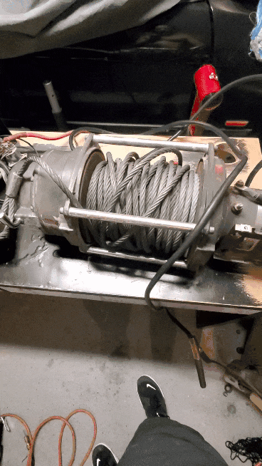

I’ll join in. I just picked up a 2 year old M12000 from a local utility company truck. The motor is stamped 2018. The winch works great, for now I’m just pulling bolts and applying anti-seize.
Anything else I should do before I hang it on the bumper?

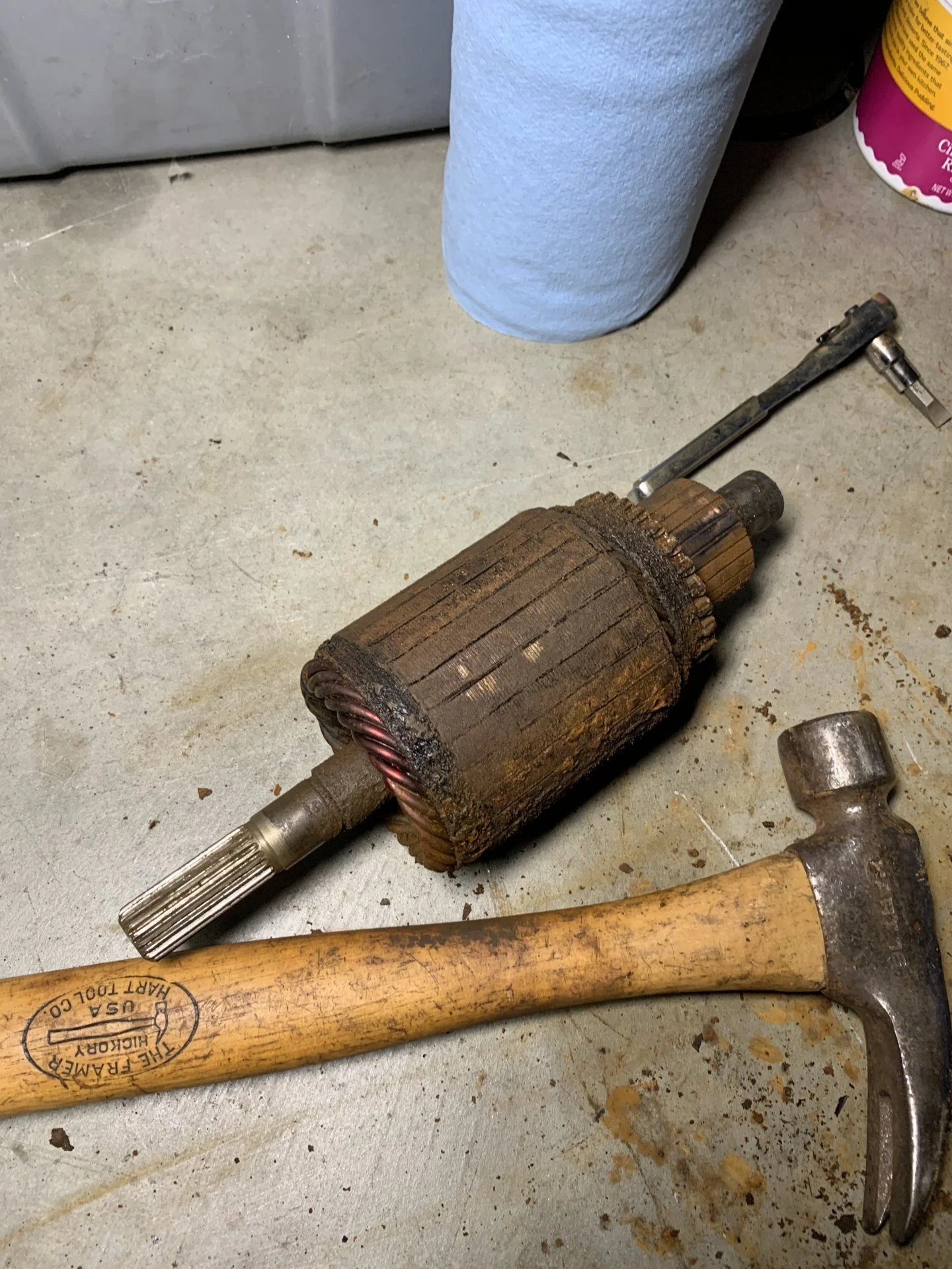

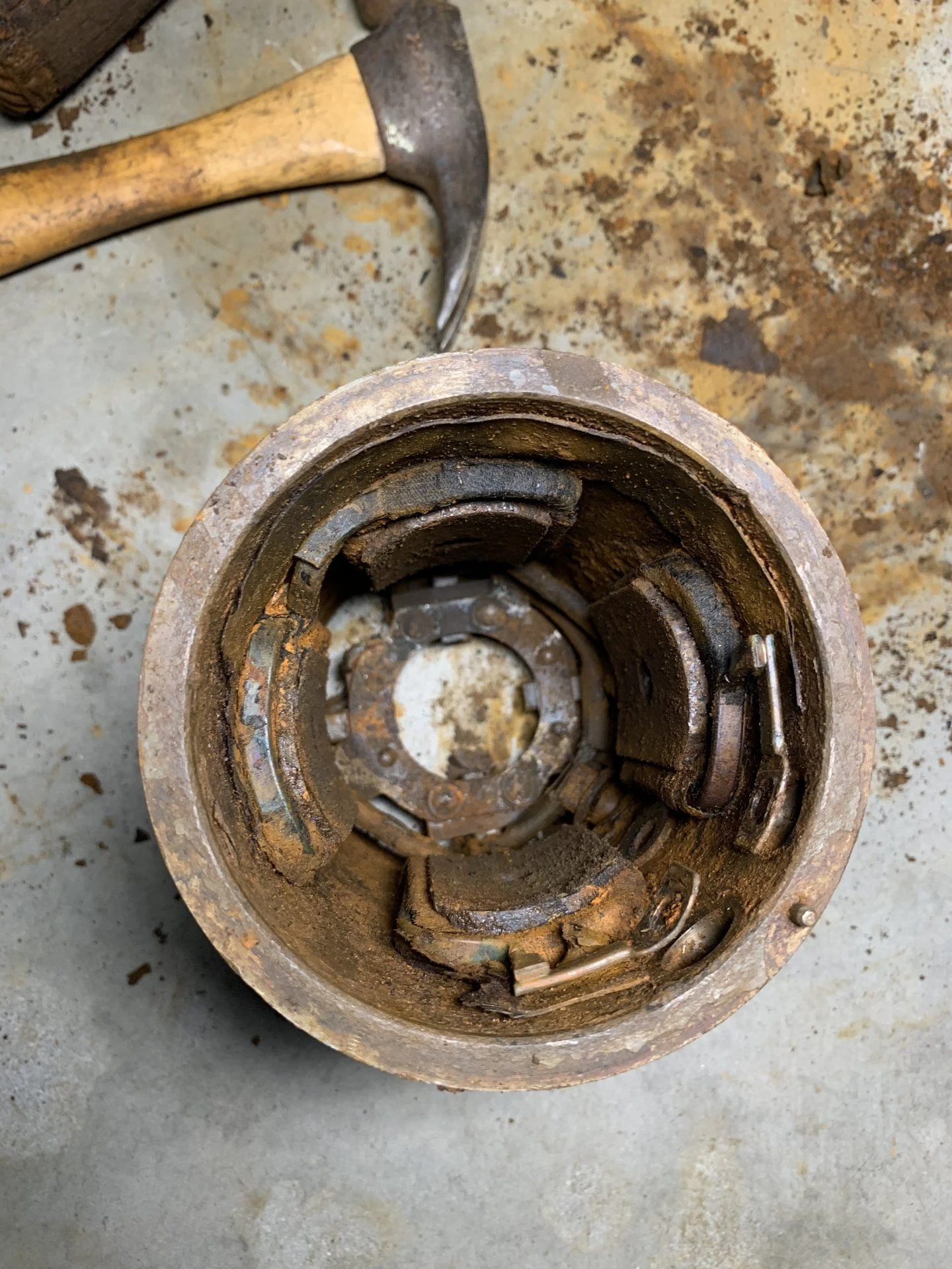

Figure I’ll jump in the party, too. Just picked up my first m12000 in august. Just started the tear down process this week. What do you all think of my motor? Looks toast but part of me wants to take a long shot and rebuild it
Edit: only saw the photos on my phone. Looking at them now on a computer this thing is done. New motor going on

Mine wasn’t that bad and I replaced the motor. Pretty sure it still would have worked though. I replaced with a 9.5XP motor primarily because it’s sealed. More like “sealed”.
Yeah, I’m leaning that way too. Is there anything different you need to do to seal the motor up completely? Or just slap the new one on?
