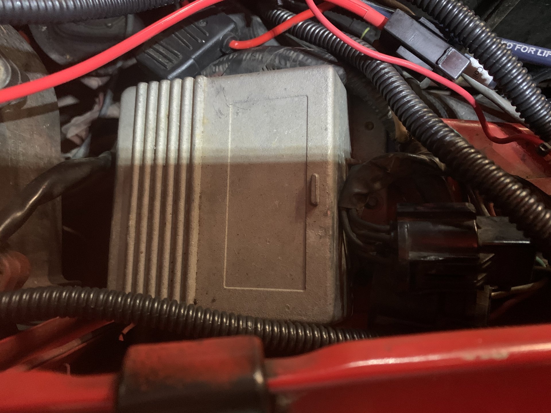

Just a guess, dodgy igniter / ignition module or the like playing up when it gets hot.

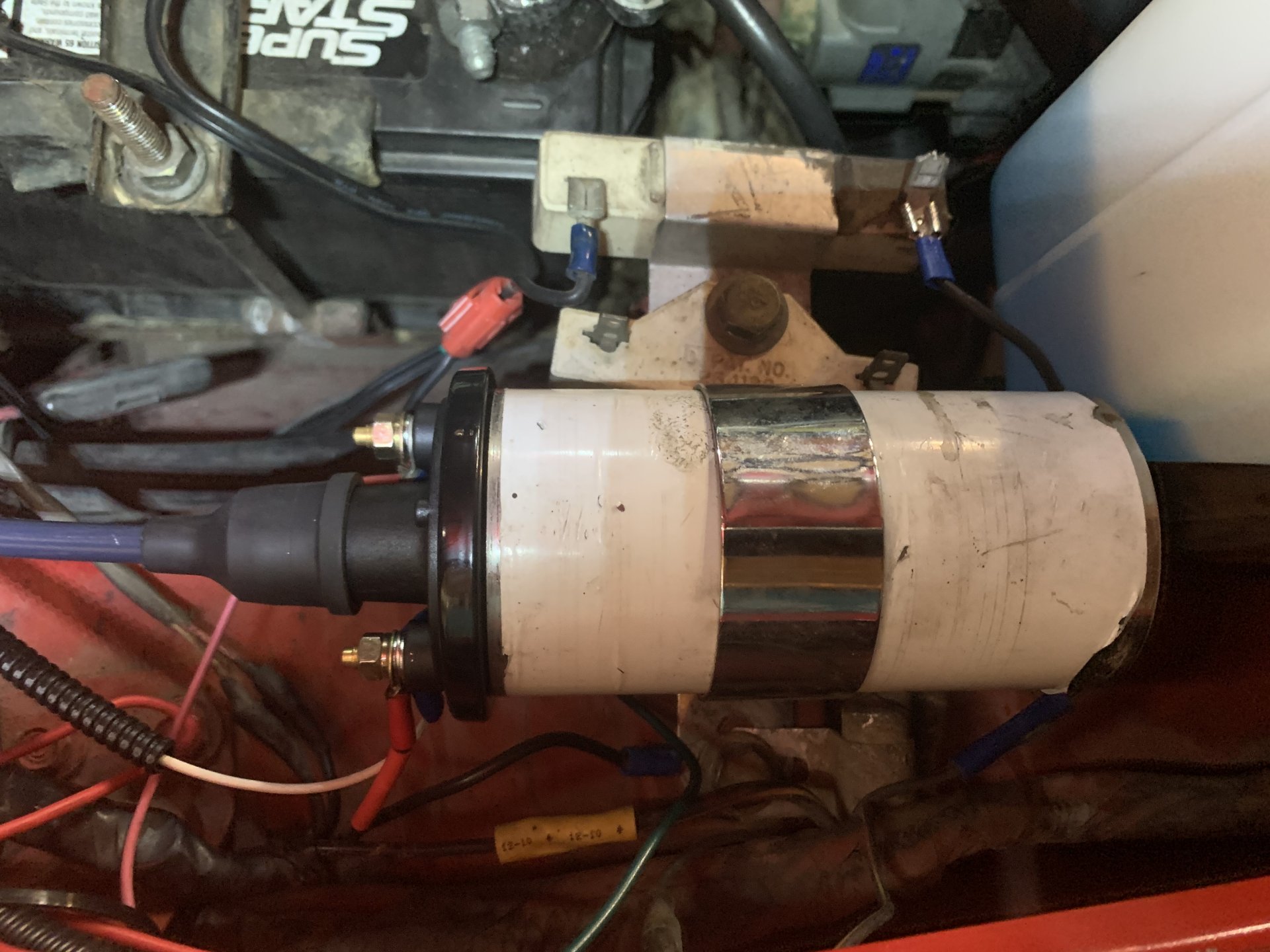

So there might be a resistor somewhere else the igniter? Here’s what my igniter+coil situation looks like…

If you turn on the ignition and take a voltage reading from the feed wire to the resistor [not the coil connected side] and it reads 12v it means no extra ballast wire. If it reads 8 to 10v the original ballast wire is still wired up.
Well this seems promising. Voltage TO the resistor is 10.2V. Voltage on the coil+ side of the resister is 6.9V.
Was that running or just with the ignition on?
More of a curiosity than anything else.
Any day of the week, the power going to the ballast resistor should be very close to battery voltage (as a guess max 0.5v less). Say 12v parked and 13.5v while running.
Either you have a resistor wire or bad connections. If you bypass the stock wiring with a jumper does it change how it runs?
The measurement I made was just with the key on / not running. I verified the voltage across the battery terminals was >12V. I'll be running a jumper to the coil+ this afternoon. (Unfortunately I'm stuck in meetings earning the money to throw at my old car.)

Welp, not as promising as I thought. The voltage on the wire that was going to the ballast resistor was 13V once the vehicle was running and 10.6V to the coil.
Here's the interesting part that may or may not be pertinent:
With the jumper to coil+ with 13V the engine ran at really low RPM, but really smoothly. When I switched it back, the engine ran at the normal warm-up RPM around 1k rpm, but it kind of stumbles. Then I realized that I'm running what should be my 12V "ignition one" wire for my fuel injection to the coil+. I'm wondering if supplying low voltage to my ECM's power relay is causing some heartburn here.

The ecm needs full 12v for sure. At this stage it might be worth ditching the the ballast resistor and wire the original wire straight to coil plus. I'll take a guess the original ballast wire is still in your truck.
Even if it isn't , full 12v to the coil won.t damage the coil for a short period of time. But take a volt reading from coil+ when running,
To be clear, it's just the 12v that switches the main power relay. The wire from the coil+ is not supplying the main 12V power to the ECM and injectors.
