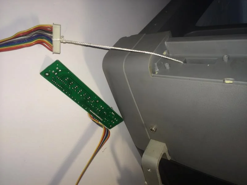

Mine came apart just like yours. The only difficult part would be snaking the rainbow harness from the display PCB down through the (sealed) cabinet on the end to the compressor area where it connects to the main PCB. Looks like you might have to cut some of the plastic cabinet housing to make that happen though.

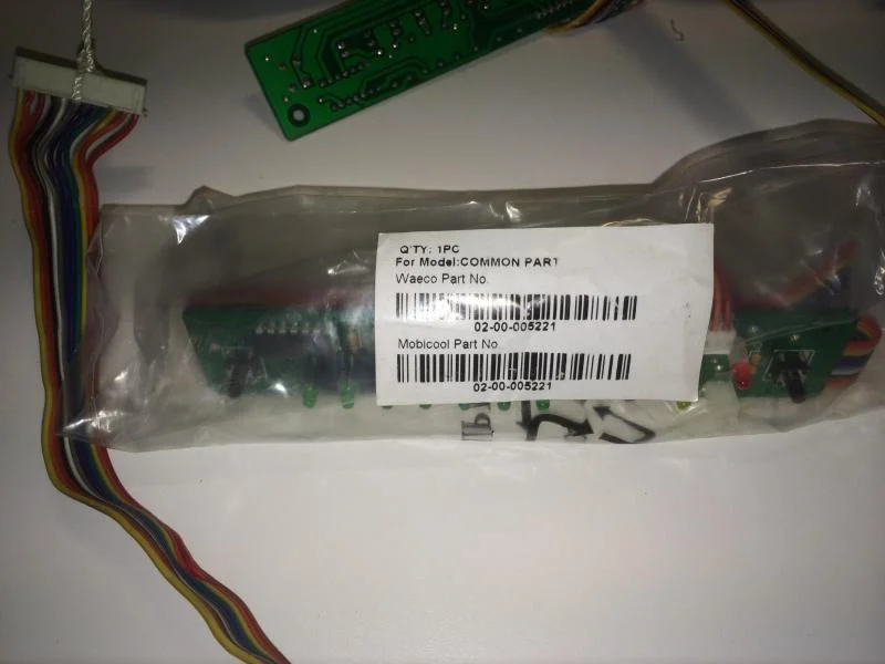

Display PCB is: #02-00-05221...$50.00
Main PCB is: #SP005MAINPCBASB...$36.00

Display PCB: #0200-005221...$50.00 (same as above)
Main PCB: #SP005MAINPCBASA...$53.68

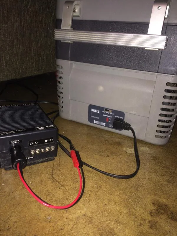

Finally got around to swapping out the controller board. The swap went pretty smoothly, but I'm still in the same situation. Test run on the 24V inverter I bought with the Waeco and it ran fine for the first 12 hours. I placed a couple of six packs in the main compartment.
I moved the thermostat setting up/down every 30-45-60 minutes or so and witnessed the temp fluctuations with a refrigerator thermometer clipped to the top of the basket near the partition. After 4-5 hours of this, I left it on "1" the lowest setting to sit overnight. Woke up the next morning and it was running colder than it should for that setting. I left it running all day and by the evening there was a layer of frost inside the whole main compartment. Pulled one of the beers out and it immediately became frosty when exposed to the ambient air in the kitchen. Poured the first beer and it was frigid but not frozen. Opened the second beer a few minutes later for my wife and the head in the bottle froze in the neck.
Feeling pretty dejected about this after spending $$ on new boards. May try to find an RV shop and see if they have any experience with one of these units. Googling for this kind of service has produced little results so I may have to start making phone calls.
Used a pull string attached to the old controller's ribbon wire.

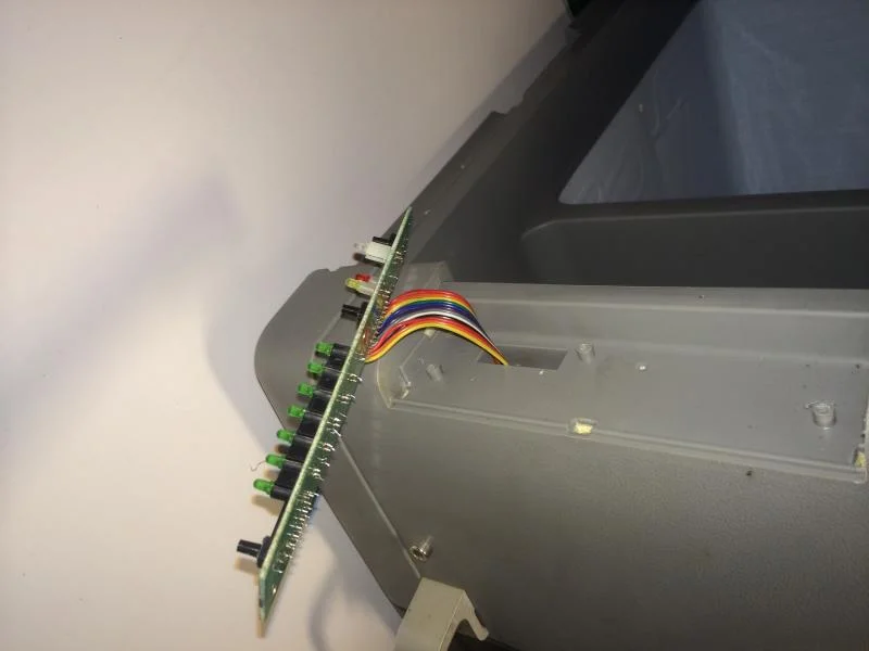

Swapped the string to the new ribbon wire and it easily pulled through the cabinet/insulation.

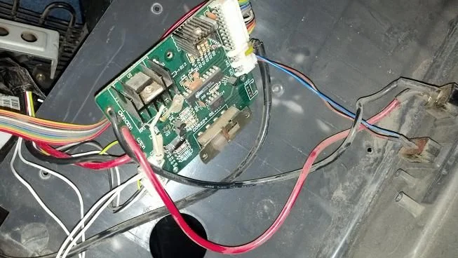

Thermister didn't fix mine and I ended up smoking the power board for another reason while troubleshooting. Unless I can find a way to bypass the power board and install a rheostat for temp control I think it'll become a 54qt humidor. I'm not very interested in dealing with the parts issue Ige dealt with.
