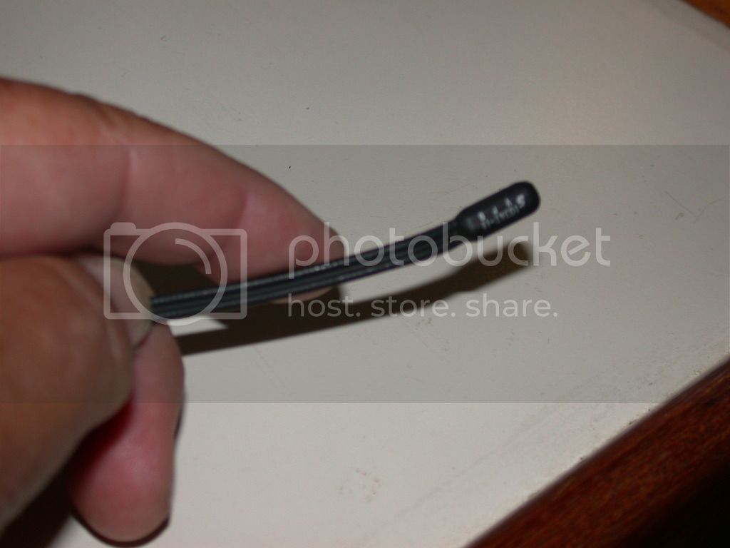

OK, here is what I ended up doing to fix my CF50. I ordered a 10K @ 25 degrees C Carel NTC themistor from rparts.com. The reason I picked the Carel themistor is that it is epoxy encased and appears to be very rugged. There are 2 of these same thermistors controlling the compressor my built in 5 cu/ft reefer aboard my boat, 1 senses the interior box temp for display, and the other senses the evaporator plate temperature to control the compressor. The link to rparts.com Carel temp probe: http://www.rparts.com/index.php?cPath=13_17_42&osCsid=mvftdohqem4fhpi0c9heush6a5
Picture of probe:

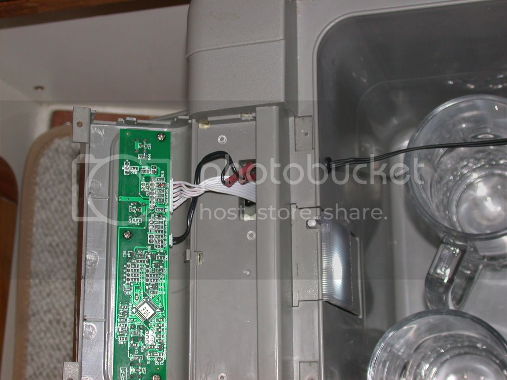

Next, I drilled a 1/4 inch hole inside the dairy compartment through to the passage way for the wiring to the temp display and control board. A rubber grommet was installed in the hole and the temp probe wires were theaded through and connected to the control board:
[URL="http://i356.photobucket.com/albums/oo2/sashay567/DSCN2395.jpg"][URL="http://i356.photobucket.com/albums/oo2/sashay567/DSCN2395.jpg"][URL="http://i356.photobucket.com/albums/oo2/sashay567/DSCN2395.jpg"][/URL][/URL][/URL]
You can see the temperature probe wires coming in from the right.
To use, place the temp probe in the middle of the box horizontally and vertically. I use my CF50 primarily as a freezer so the probe is placed between layers of frozen food as close to the middle of the box as practical. The probe appears to be rugged enough to use this way as long as some care is taken.
