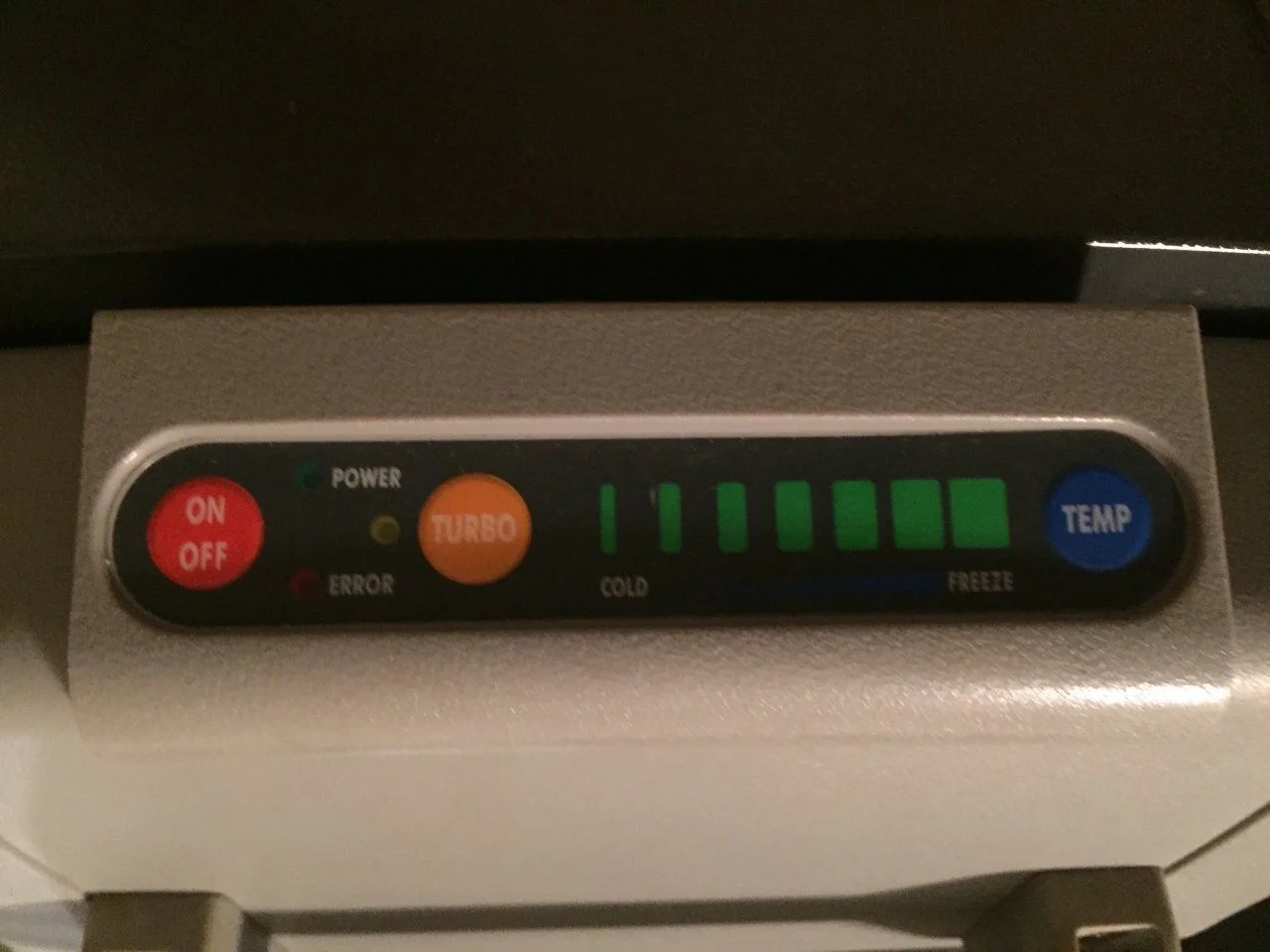

Old style or new?
Post pic of control panel if you dont know

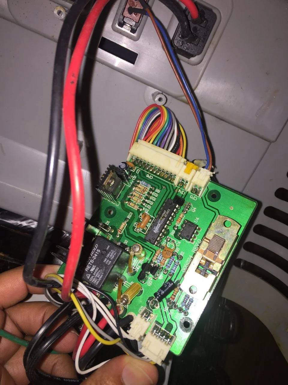

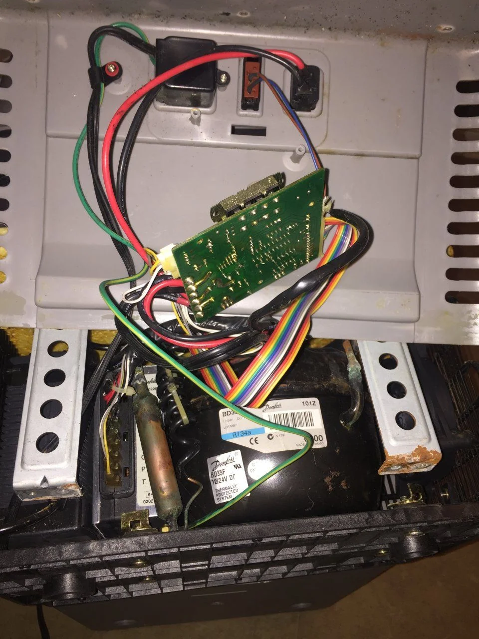

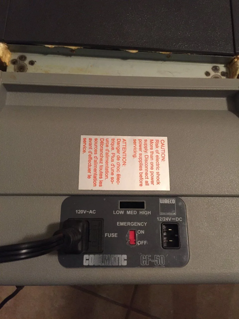

I think it is the old style - here are some pics... I have checked the voltage on two wires coming out of black box that and into the main logic board (black that looks like a power supply since it has 120V wires going into) - found zero volt going into the logic board. If the power supply / transformer is bad, shouldn't it at least turn on when it is plugged into 12V externally? Since it looks like the 12V comes straight into the main logic board - alongside the wires from the power supply

Anyone have any idea where I could get a new one of those and just as importantly, how do j remove it. Seems like I will need to do something with the radiator coil or other metal coils going into the main compartment
That's progress. Sounds like it is a control issue and that it cools OK when it turns on. I see you have a Turbo button, which is likely the equivalent to FF on the Edgestar.
Then there's that red Emergency slide switch. Any Ideas about it?

First you could check online for any info on parts that are known to fail. Next you could take a DMM and go over the circuit boards testing each part for continuity. Starting of course from where the transformer wires connect. You might find no voltage at the start which will tell you that the tranny likely has an open winding.
