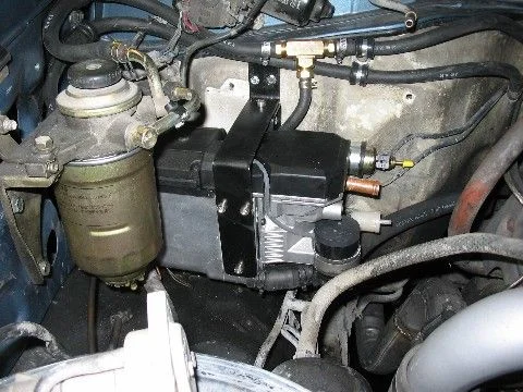

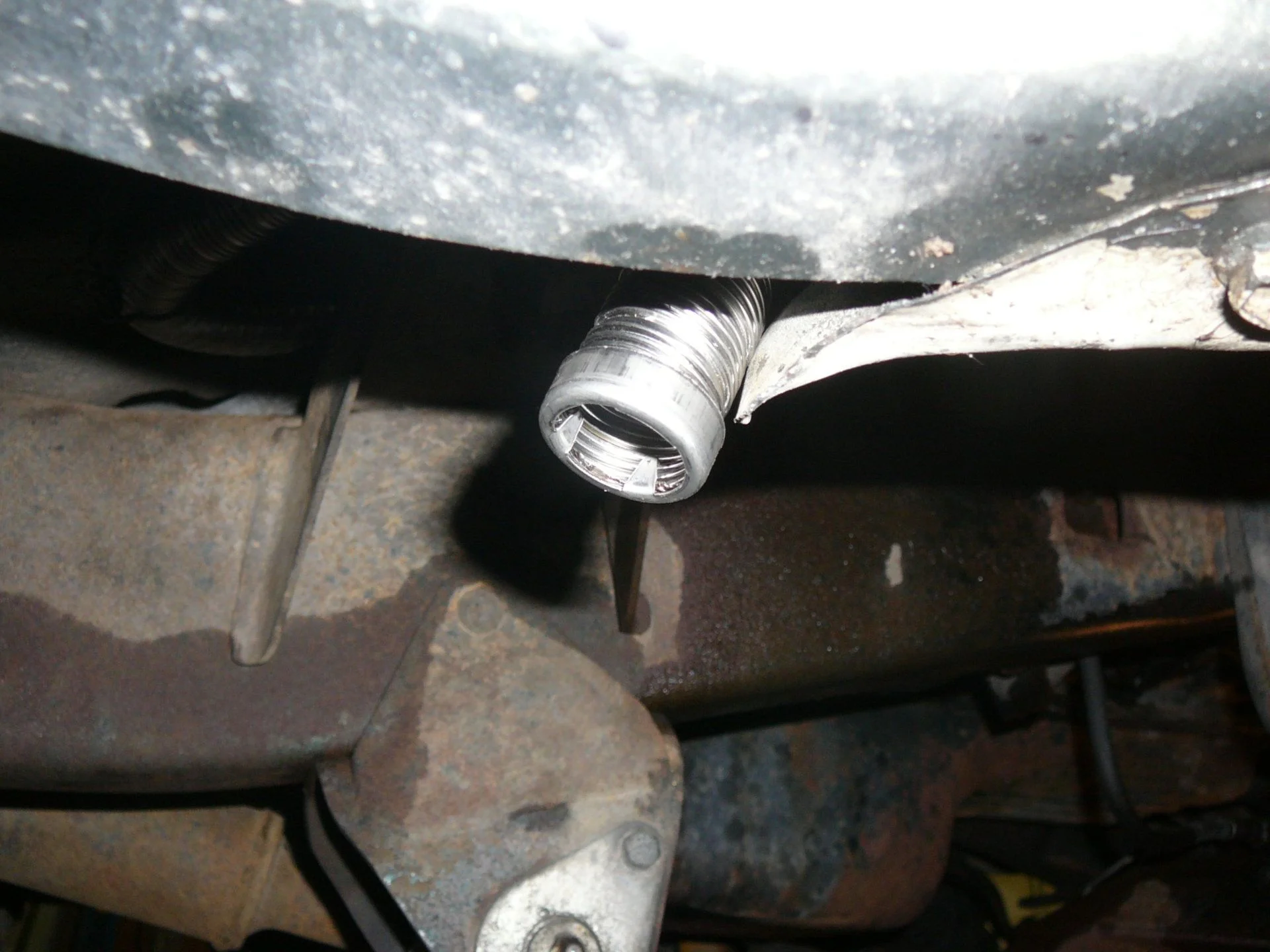

My webasto is installed directly against the firewall by the heater but down low. I run the exhaust behind the shield and
it exits behind the front tire on the RH side. I have my inlet air line extending down along the transmission tunnel so the
air is drawn uphill. I've been in some/many water crossings without incident.

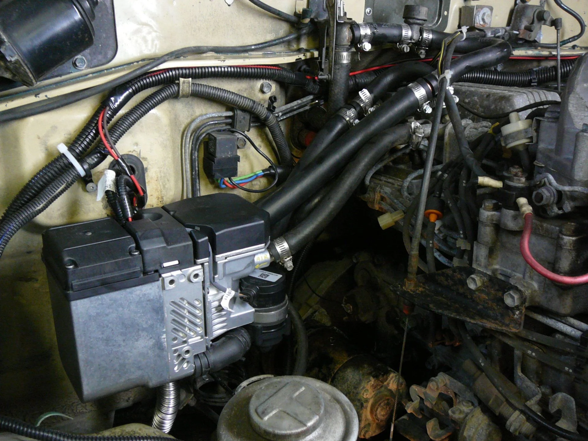

Here are some pics, my 60 has a 12HT so not sure how your heater lines work.

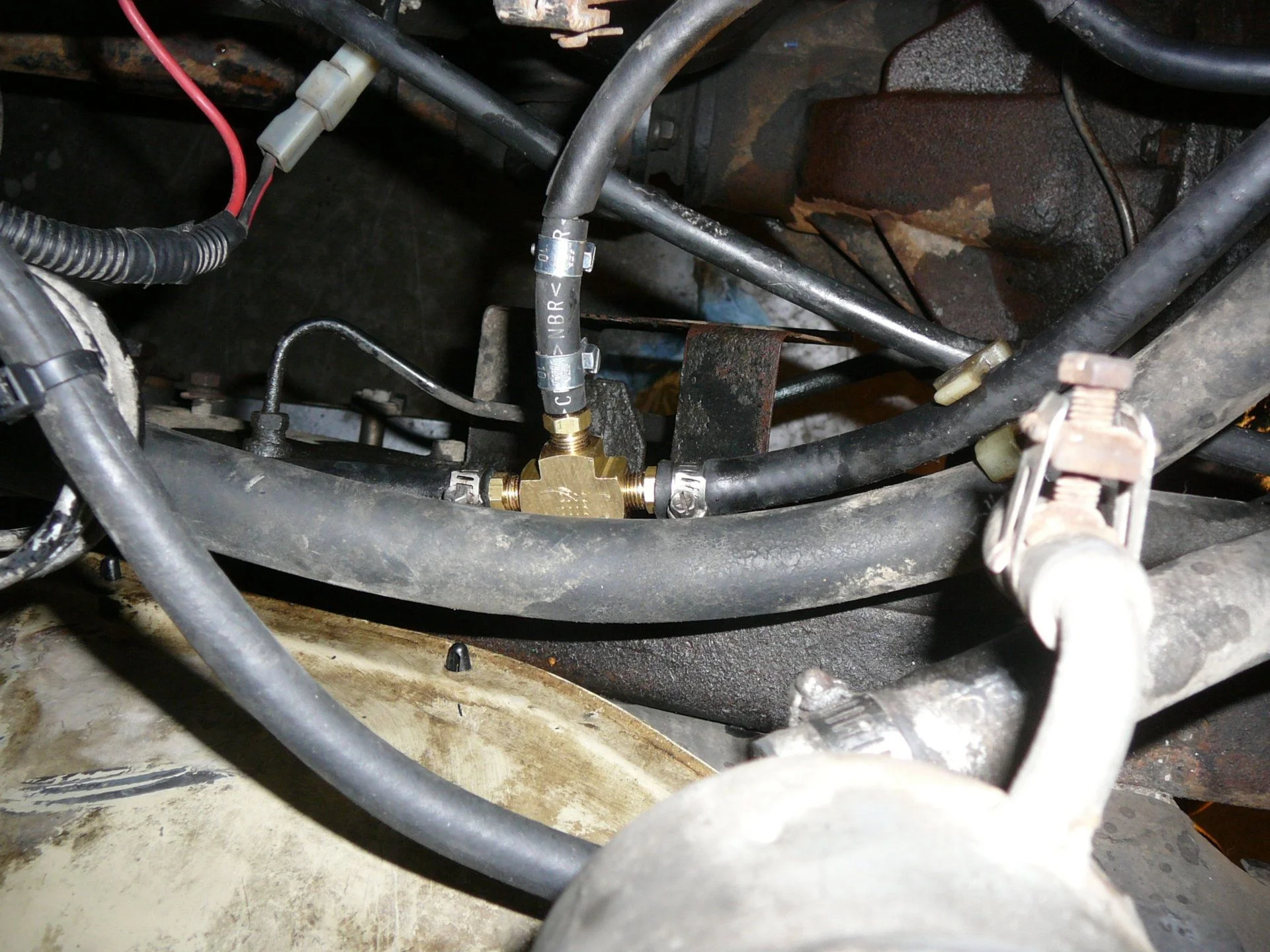

I just ran a T from the fuel line by the motor. One thing to remember is keep the fuel pump level, and be really careful to follow
installation instructions concerning the fuel line.

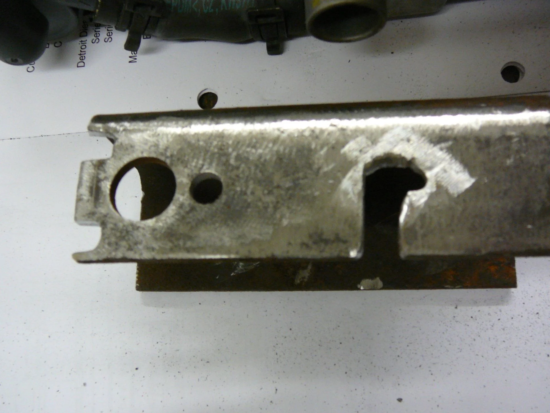

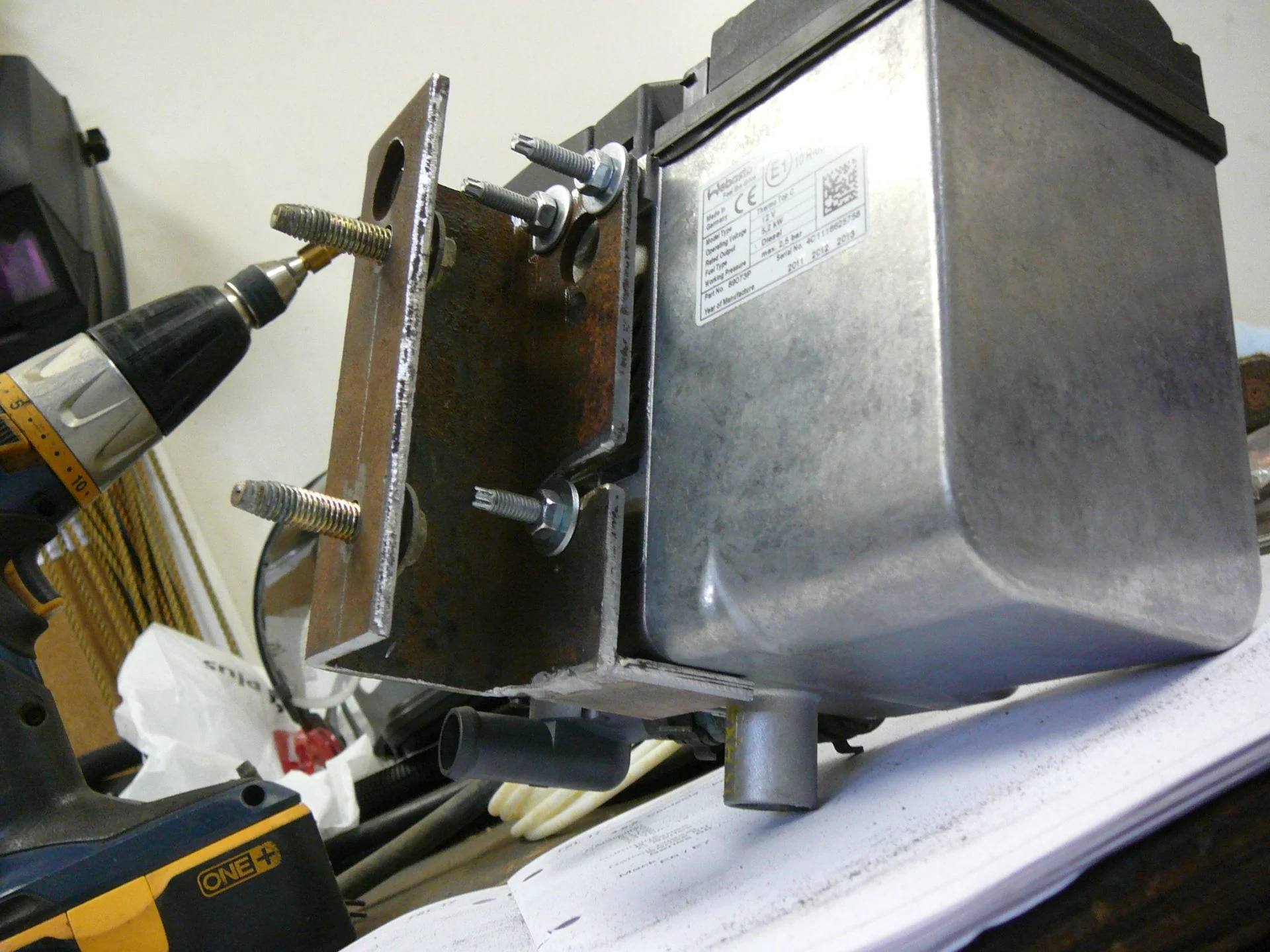

The hardest part is fabbing up bracket to hold the heater.
I permanently mounted a channel to the firewall, but use a notched system so I can loosen the nuts, and remover
the heater. It worked great as I was able to remove the heater for service and just circle the heater lines temporarily while
I removed it for service and still drive the truck around
I just reach in with a flex head 10 mm gear wrench and it comes out in 5 minutes. Handy!!

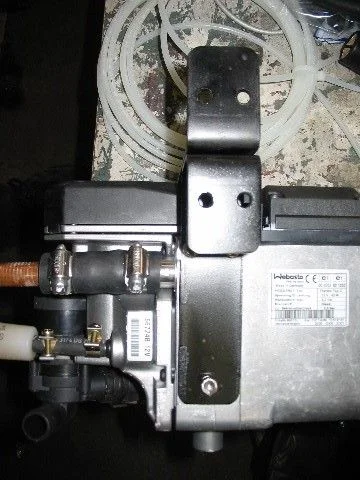

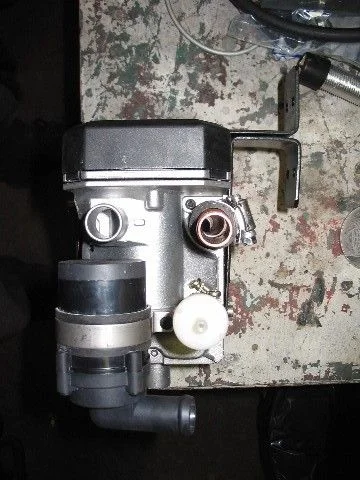

Here is a pic I got from another install. It seems to be really sturdy too.

BTW, my fuel feed lines are that plastic line, it's very small diameter and in my eye fragile. So if you look
I ran it through a rubber fuel line which protects it from melting, kinking, and chafing.

Second, be really careful with your exhaust. I routed mine just behind the front wheelwell so it sticks out a couple of
inches. There is a pic above. One day coming out of low level Mackenzie River delta at just above freezing I got pretty
muddy all up behind the tires and it was stuck on pretty good. Camped that night and it froze solid! Blocked my exhaust,
so in the morning I turned on the webasto. Taking down the roof tent when I saw smoke and it had already blown it's fuse.
The mud was enough to make a cold -15C morning seem a lot colder!
Third, after I deleted the rear heater I did a coolant hose reroute. Now the Webasto heats the engine block first. I realized I need
to start the engine first anyway to get the benefit of the preheat. To be honest it heats the cabin thru the vent faster than before.
