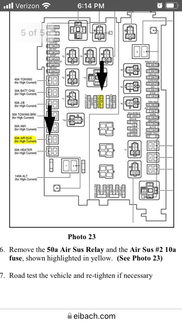

These are the two I removed on my 03. One fuse and one relay . Hope this helps!
