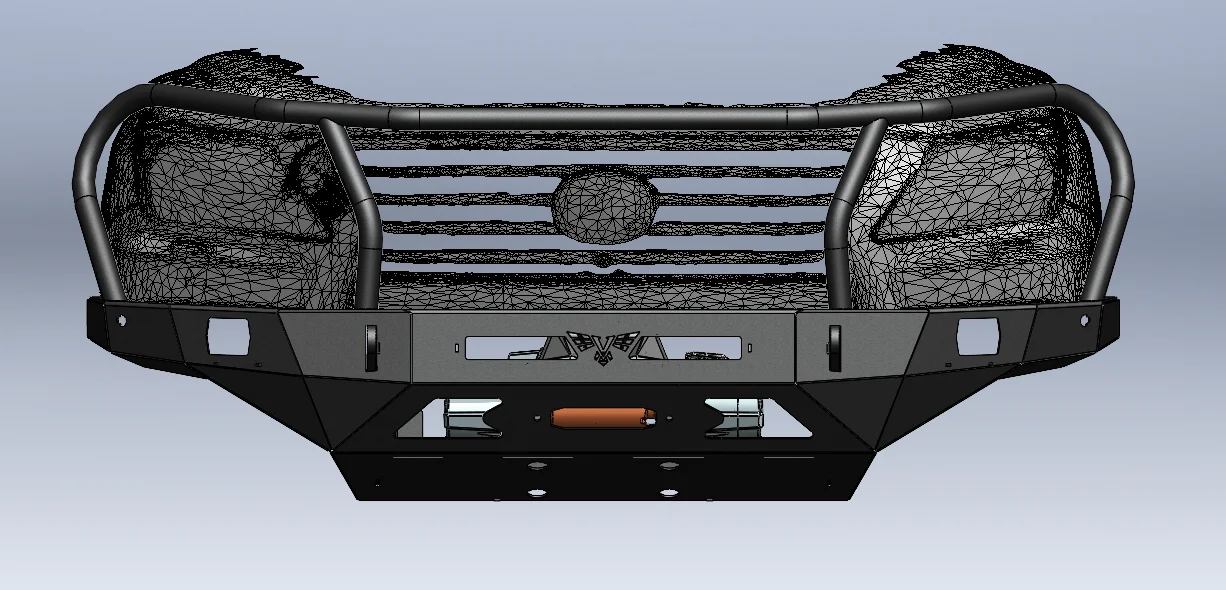

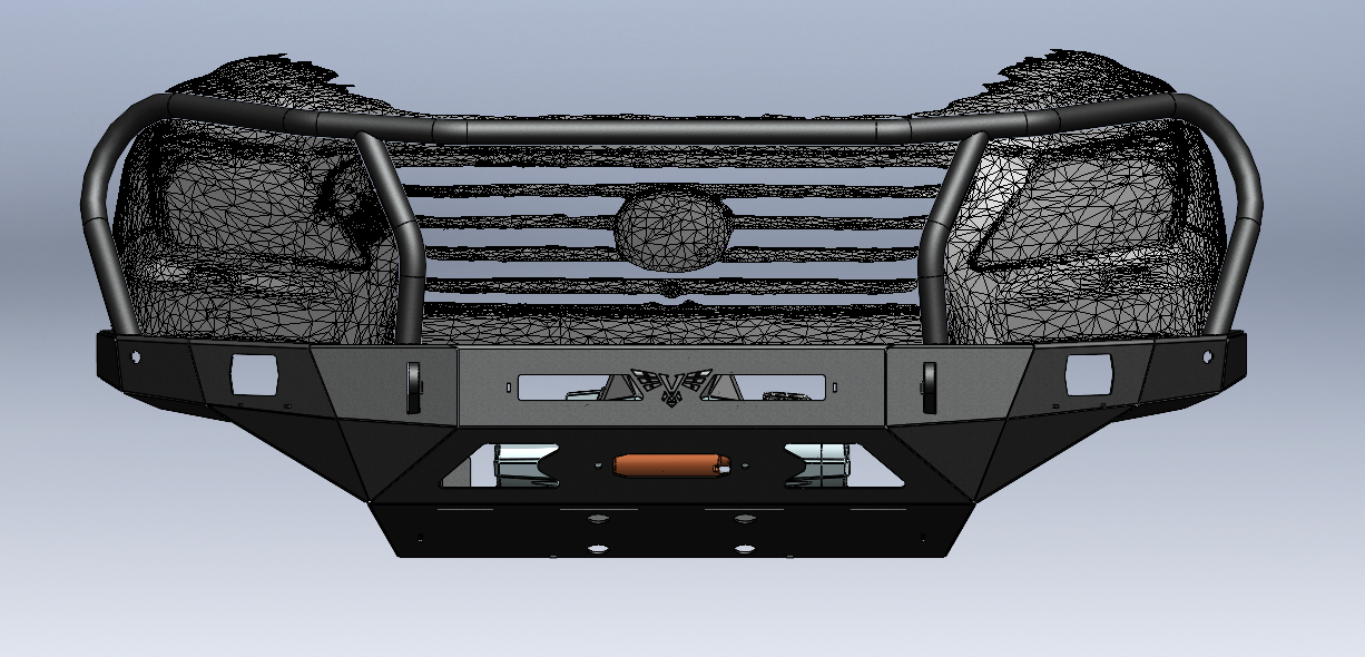

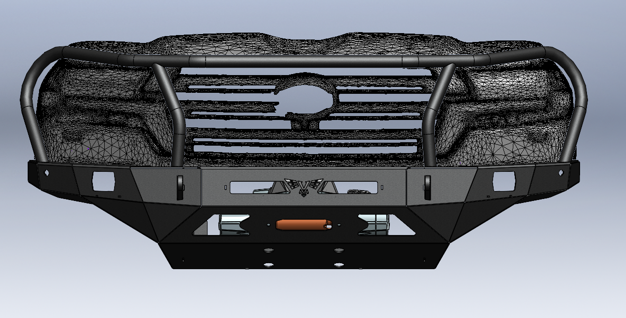

Here are the renderings of the Bull bar on the LX and 200.
I love that the middle uprights follow the lines of the Lexus grille. I am very very interested in seeing the final product.
I noticed on your development photos above, as well as some of the photos on your website Land Cruiser Roof Rack | 200 Series & LX570 (08-21) - Victory 4x4 - https://www.victory4x4.com/product/V200RK-F.html you have very tight gaps between the bumper and the fascia. Pretty much every other bumper option out there recommends an inch+ to prevent the bumper from destroying the plastics. On my previous FJ my AllPro bumper had a solid 1.5" of gap and running hard through whoops would cause enough frame flex that it would still contact and break the plastic filler panels below the headlights.
Is this something that has been accounted for and designed around or is the 200 series frame that much stiffer that its a non-issue? I've not run an aftermarket front bumper on any of my 200's so I have no first hand experience to judge from.
