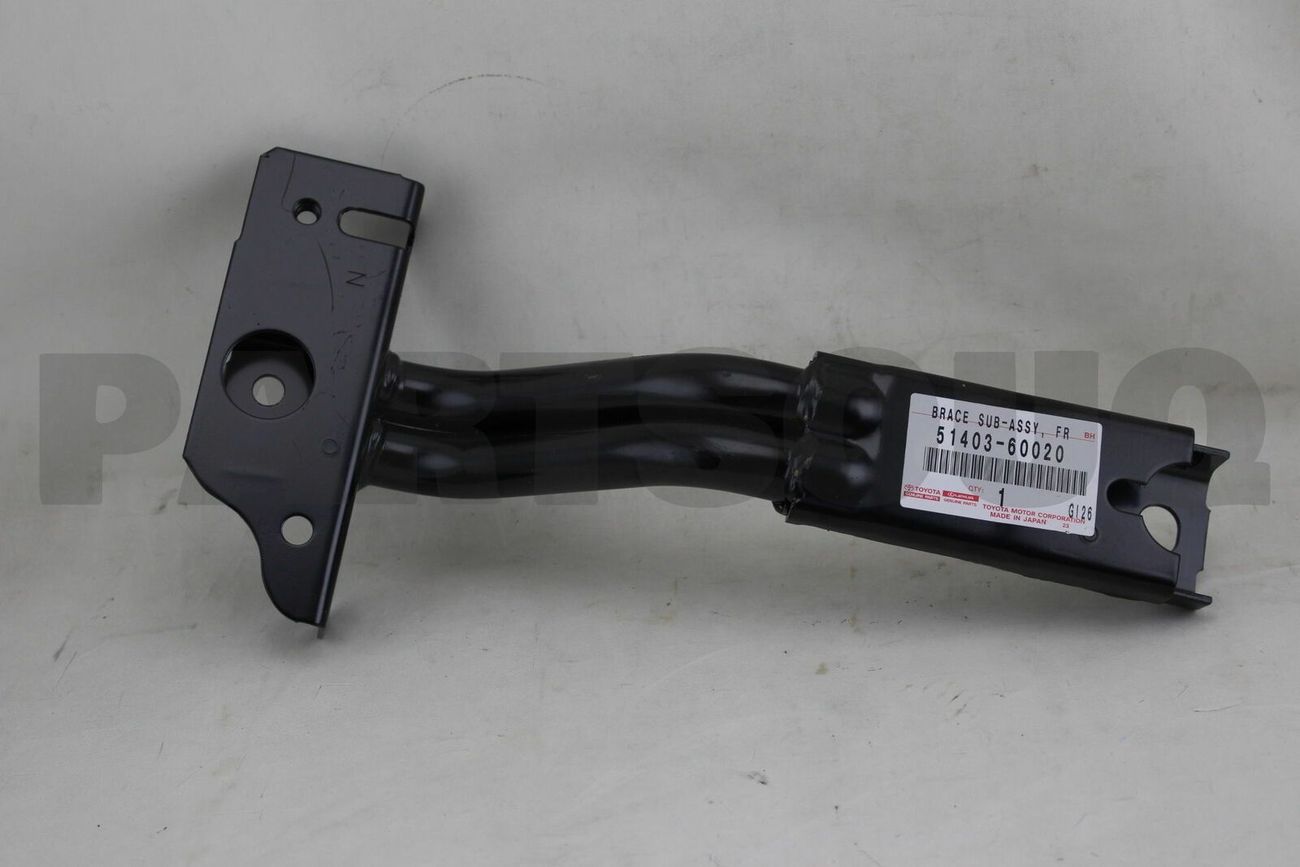

Who has this bumper install - would you be so kind to make few photos from the bottom of the vehicle? There is not one in the Internet :).
Also did you need to remove support brackets of the OEM skid plate (like these ones: https://cimg4.ibsrv.net/gimg/www.cl..._c81ed7a81172068e1d56f568bd480b3d023dd567.jpg) ?
The reason I ask - I have non-victory4x4 skid plates and I want to understand will there be any fitment issue with this bumper?
Thanks!
